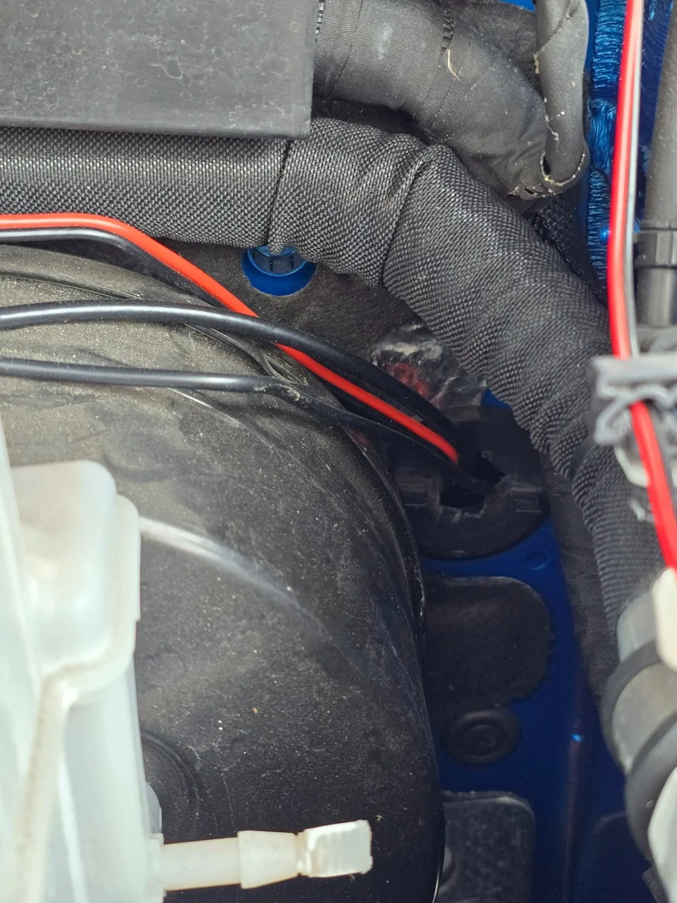

not sure if I read part of your post wrong, but there's a small firewall hole available on the driver's side - the wires will be right above the brake pedal to the left a bit. I ran my GMRS power and antenna thru it.
That's where the manual transmission clutch stuff goes through. I wish there were a few more places to run wires through the firewall. But I was also referring to the dash board, where I'd like to see places to run wire from below to above the dash.
