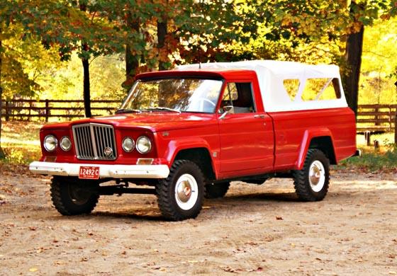

Good thread. So, off topic but hoping to get an answer for my 64 JT, m/t 3 speed, geared low, 4:09 or 4:27. I want to increase top end speed. If I roll taller tires, how much mph can I gain? Here's the basic truck (mines not lifted, but similar):
Regear to 373 or swap a 4 or 5 speed transmission , i really love those old Gladiators
They offered a hi low overdrive, making it a six speed. No change needed otherwise. Added 10mph. Am I right to try that before regearing?
