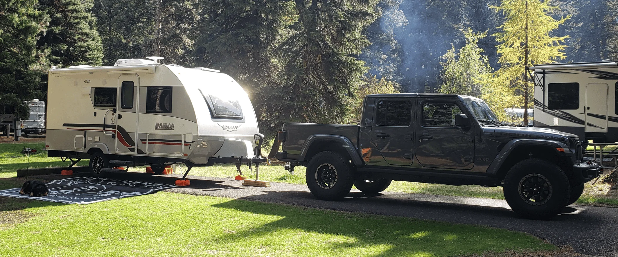

Give yourself bigger margin. We've been pulling an RPod 202 and it's longer, cheaper, tougher, roomier, and has that margin to spare.
Marob419
Mario
Mar 8, 2023
45
OHIO
Jeep Gladiator Rubicon
Oil and Gas
This was the perfect size.

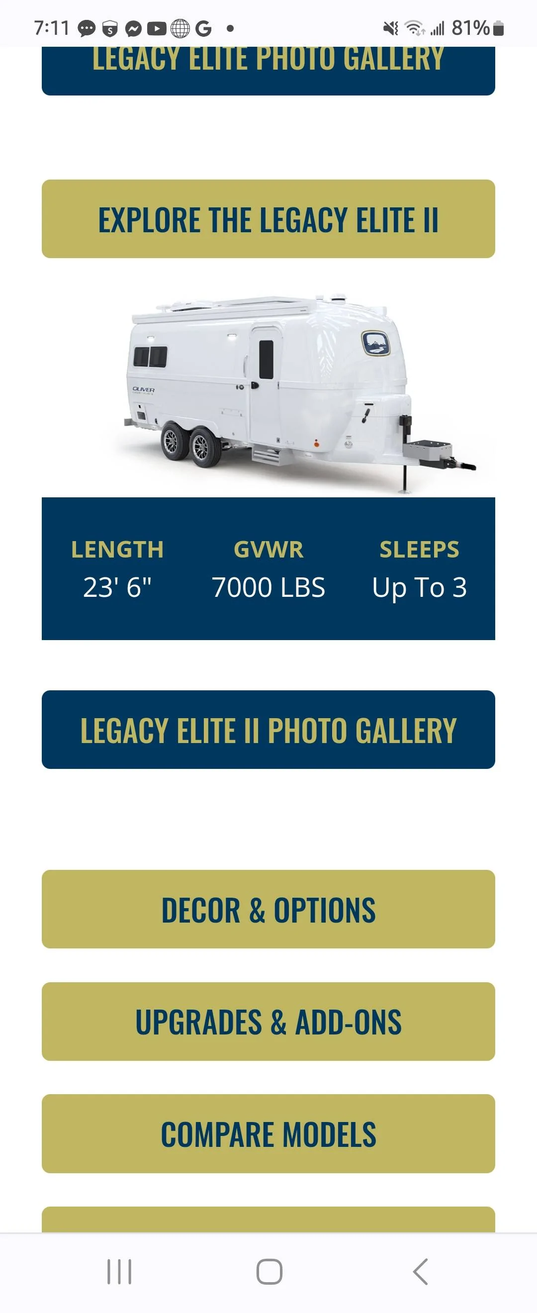

I have a 2023 Rubicon Diesel with Tow package. Do you folks think it will be OK to tow this trailer?
As someone who has towed a trailer that was just below max weight for my vehicle I would tell you to get a bigger tow rig or go smaller on the trailer. You will load far more on your rig than you realize and towing at max weight is not much fun unless it’s just around the local area. We all think we can live with it until we experience it for long periods and then it becomes a bad time. I don’t know your intended use of the rig but you will never go wrong with going to an oversized tow rig, especially if you intend to use it for extended periods on long trips. Gladiators are not well suited for towing in my opinion. I tow a 2000 lb boat with mine and its fine but if you decide to proceed, go light on the trailer, because tou will add far more to the base weight than you would ever think. Good luck.

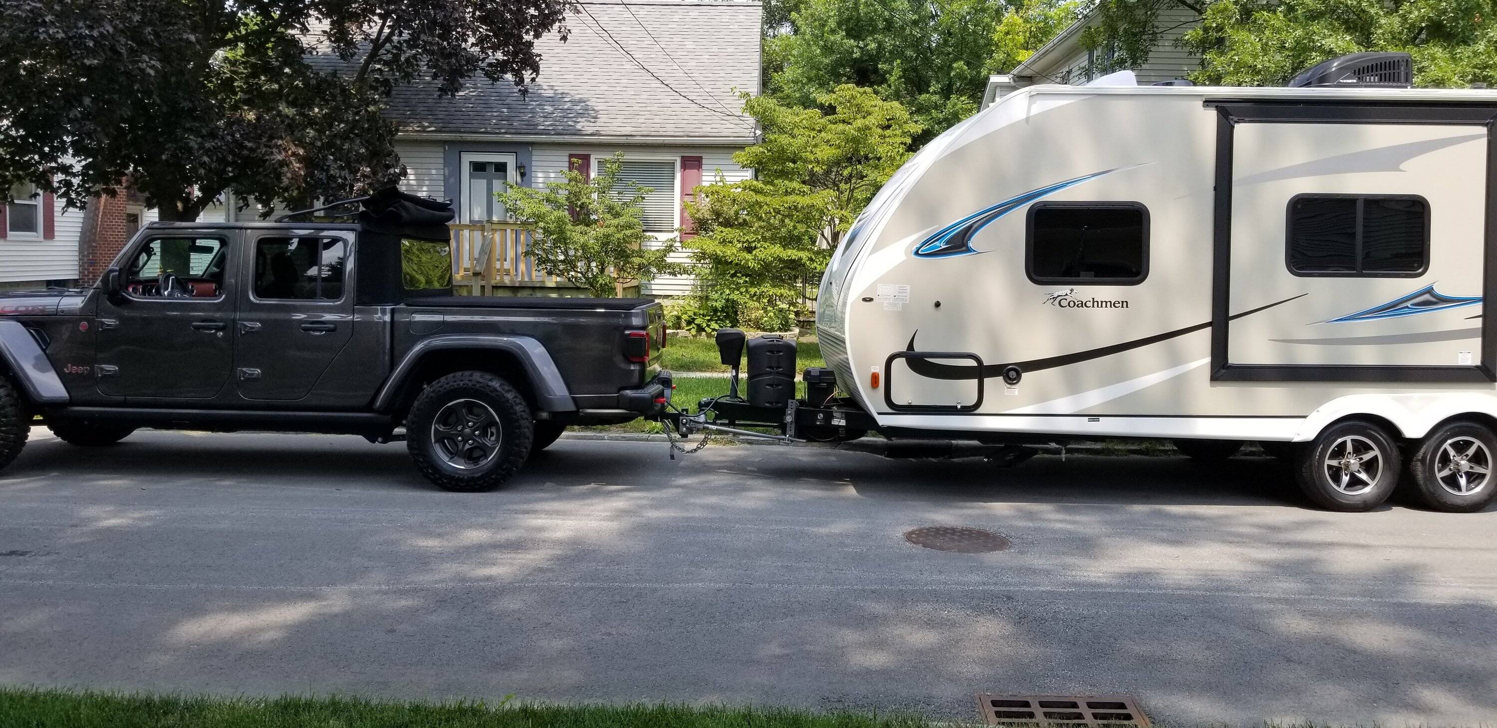

I have a 2900 pound dry weight trailer, 3500 pounds loaded. I would not want to go much heavier. I have towed it over 10,000 miles without any issues. I have a JTR with lift and run/tow with both a set of 37ā€ and 35ā€ tires. If I’m going to wheel and camp I tow with the 37’s. Just traveling and light off roading I tow with the 35’s. I’m re-geared to 5:13’s. I use only an anti-sway and it tows nicely. I still feel it working in the mountains, but al gauges show normal operating temps. I think if you are running a stock JTR or Max Tow. you could go up in weight a little? My 2 cents.
Very accurate. Very.

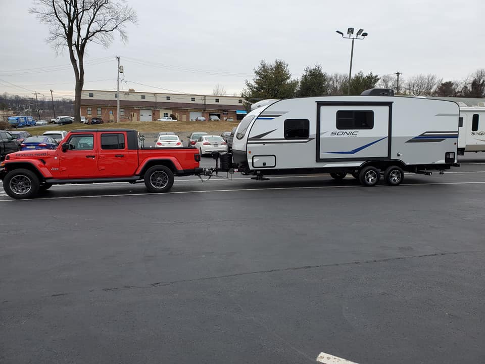

I have a 27' Vantage Sonic SN220VBR and tow it with my Overland. I have the BlueOx WDH/sway and Tekonsha brake controller. My trailer is ~4,750 lbs and with all our stuff that we want or need I'm figgering around 5,100 lbs. Tongue weight unloaded is 420 lbs and I figger with all the stuff in the front pass through it's probably around 520 or so lbs. It's dual axle and has a bump out. I think it's pretty light with all it has for it's size. And when we travel, it's just me and the Bride.
My Overland has absolutely zero issues getting it moving or stopped and that BlueOx works beautifully keeping it all under control, even when getting passed like I was standing still by a Semi. I don't drive over 65 MPH on the interstate.
As others have said, go with something lighter than that, and something that will accommodate your family, and all the stuff you want or need to take with you staying within your tow ratings, with a safety margin.
