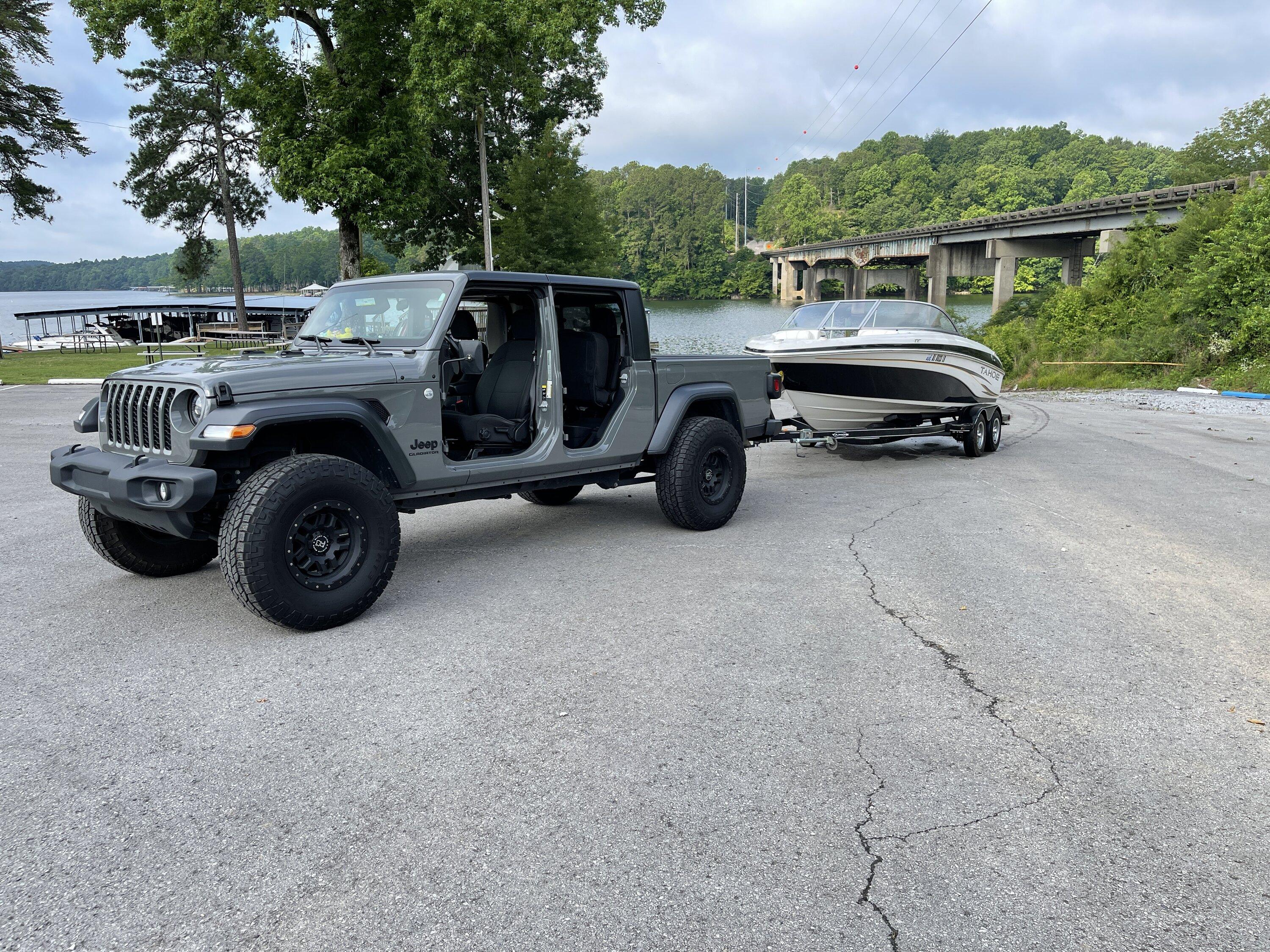

Edited to say the most I’ve towed has been our Tahoe Q6 boat and that was a breeze.

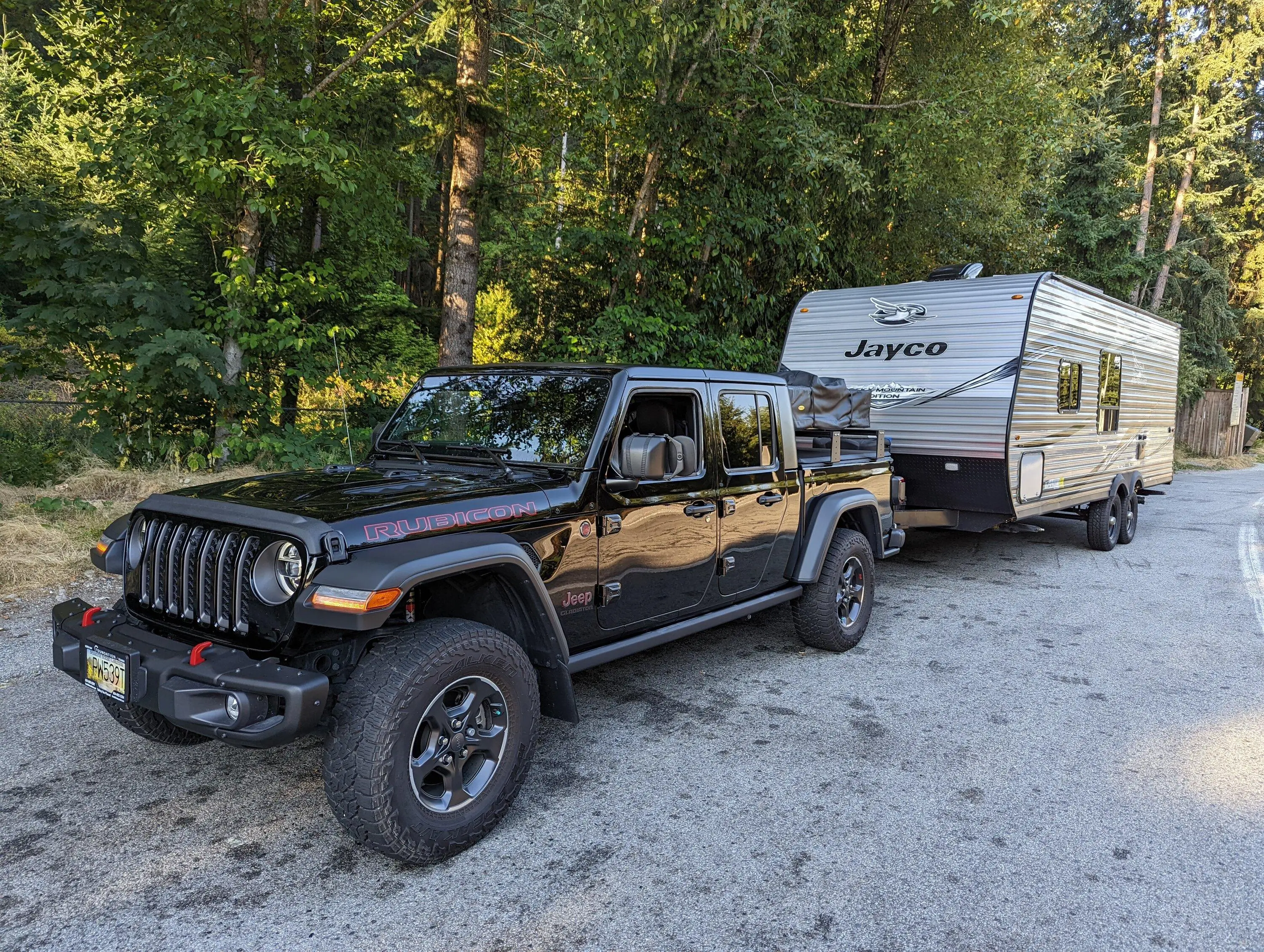

Just towed our 224bhw 26 feet tongue to bumper, 4600 lbs dry, just shy of 6k when fully loaded.
31 deg C heat, AC on, many many long hills. Truck empty other than the roof top tent at about 150 lbs .
Haven't fully fine tuned the setup and comparing it to towing same trailer with ram 1500 ecodiesel.
With the ram 1500 it always felt like nothing was behind me.
With the JT ecodiesel, it's an entertaining experience. Never feels unsafe but you definitely know the trailer is there up hills, down hills, in the wind.
I have a 4 way WD and stabilizer hitch setup which makes a huge difference and I certainly wouldn't dare tow something this big without that.
However, oil temp never rose above 118 deg C, coolant at 112 deg C up big hills, transmission around 94 deg on long hills.
Still need to fine tune the towing setup like I said, but overall feels OK, the biggest downside being very poor visibility compared to with my ram - even with the clip on mirrors I am not too happy .
If I had to tow all the time the JT wouldn't be my choice, but for the 4 or 5 big reps we will do each year, feels just fine and most importantly SAFE. Just sticking to under 110kph at all times. 95 feels very nice.
Just my 2 cents.
