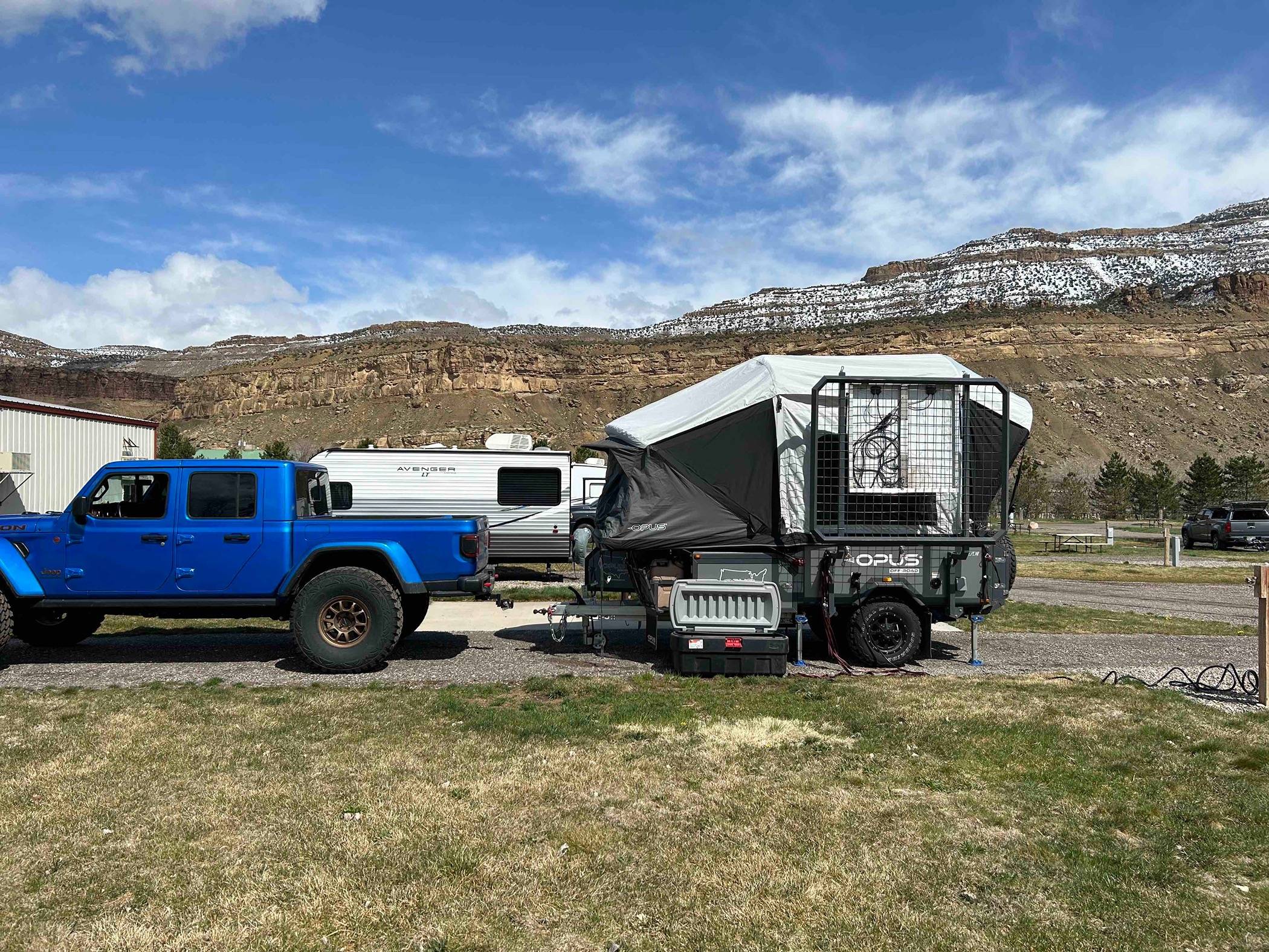

I pull a dry 2400lbs Opus with my JTD..... well aware 40's don't help, but there is only one gage to watch when pulling anything at my weight or north of that---- ENGINE OIL TEMP! It takes nothing before that engine is north of 255 Deg and won't take long before the "limp it to the dealer mode" takes over.. Whether it be from overheating or a plugged DPF, both will leave you frustrated.. Especially if you don't have a tuner to force a regen you will be stranded and have to be towed if you get a DPF plugged code! Been there done it! Eco Diesel =/= 6.7 capability. Cooling is completely inadequate for sustained "heavy for a jeep" towing, even with the "tow package" which I also have. Not to be confused with the MAX tow which is different and never came as a rubicon option. I have PN's for the differences between our tow and the Max tow. Radiator fan is the biggest difference. 5K is way too much weight.
Jeep Gladiator Your thoughts on towing this OPUS 3
Jeep Gladiator Your thoughts on towing this tempImage52GibK
