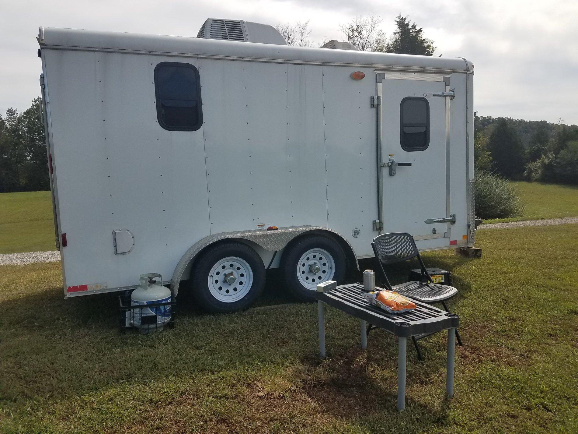

I want to tow (at least somewhat comfortably) a Homesteader Hercules 714HT round nose, with 4wheeler and camping/hunting gear inside. Also has AC, powered vent, windows. This thing is tall and catches a lot of wind, and I tend to pack heavy. Unfortunately, I've never weighed it. I need to get off my butt and do that. The other thing I really should do is load up the trailer and tow it with the wife's 2015 Durango with Pentastar V6, rated at 6200 lbs. The 'Rango and the trailer are seldom in the same place at the same time, but a test tow would give me an idea of how the JT would do with it. Wind dynamics would be different, though. I've only towed the Hercules around town once with the Rango, with a light load. It did fine; I used the paddle shifters to choose my shift points. I'm guessing 5K lbs should cover the loaded weight of it.
I'd love to not use a WDH; I strive to place my heavy items between the axles of the vehicle and over the axles of the trailer. Pretty sure I'd need one though, to help with sway. I'd be towing 2-3 hours, mix of interstate and 2 lane, primarily.
