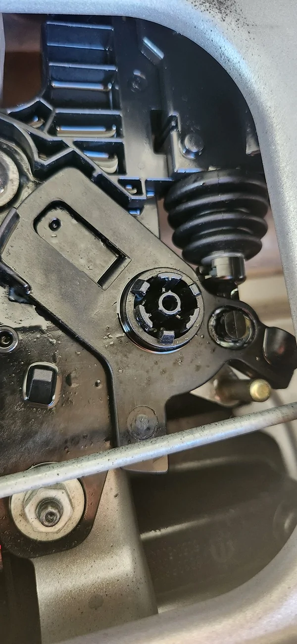

So this is the 2nd factory tailgate actuator failure. Lock, the piston is down, easy with gravity. Unlock on the piston it is vertical, this is a problem. Also I feel the spring or cam is too much pressure for unlock mode to be flawless every time. I have adjusted the main rods to fully clockwise, but not much help. So, I removed all of the factory grease on the cams and used a silicone spray. So far it seems OK, however, who knows with temp changes etc... My next move will be to dremel the unlock cam for smoother operation. My rig is a 2020 Launch with 30k miles
Really, I hate using my key which ive taped shut for another issue....

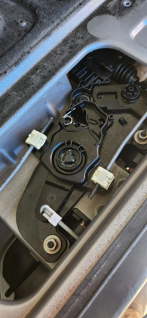

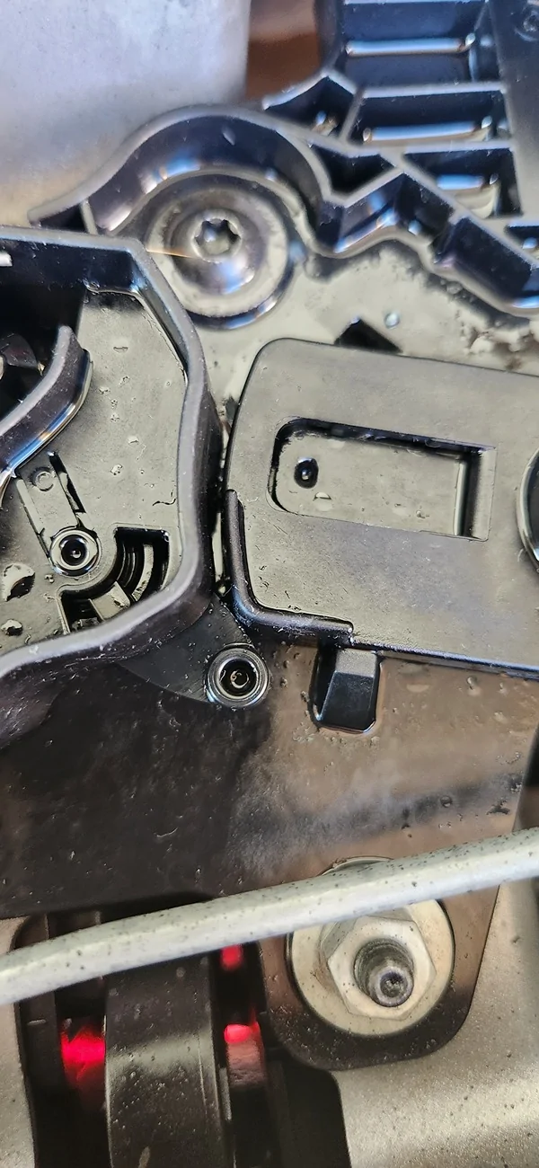

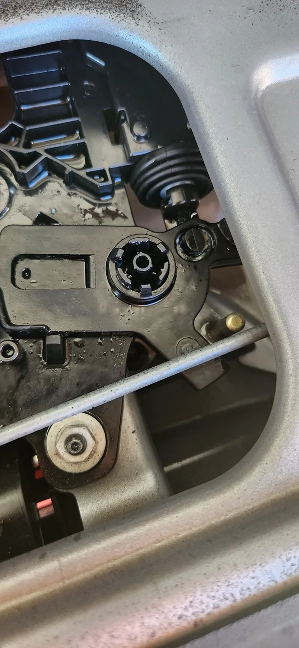

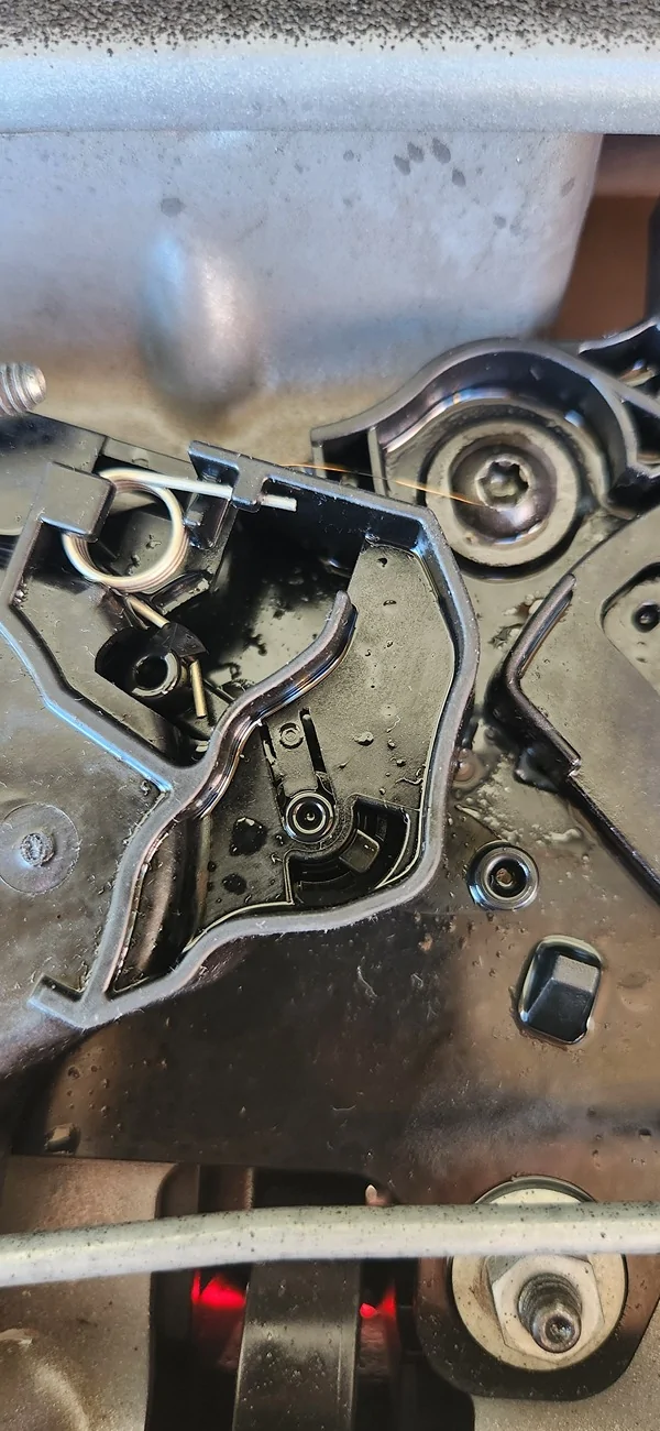

Here's the actuator open/closed, rods adjusted, silicone, etc... and yes, ive moved the rods in every position available...
