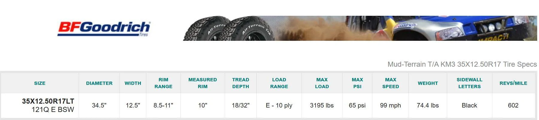

narrower wheels on a 12.5 tire will have less tread on the ground, then you always have to air down
says 8.5-11, measured at 10

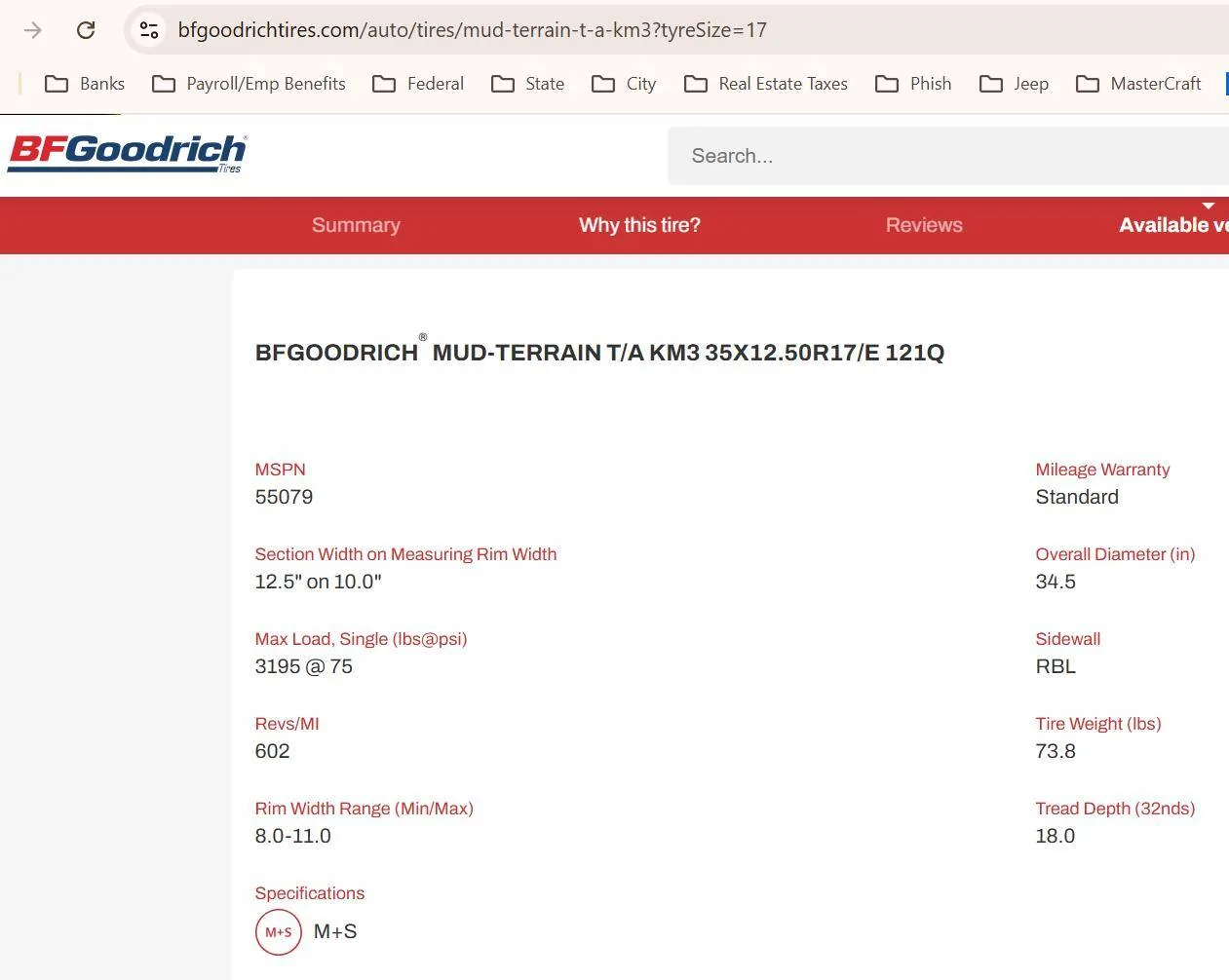

Its on the top left below MSPN - Section Width On Measuring Rim Width.
I was talking about ‘51Willys saying “says 8.5-11” and the pic he posted confirms that. What I’m seeing on the BFG website is 8-11. Not that 1/2” matters much, it’s just a slight discrepancy from what I’m seeing.
