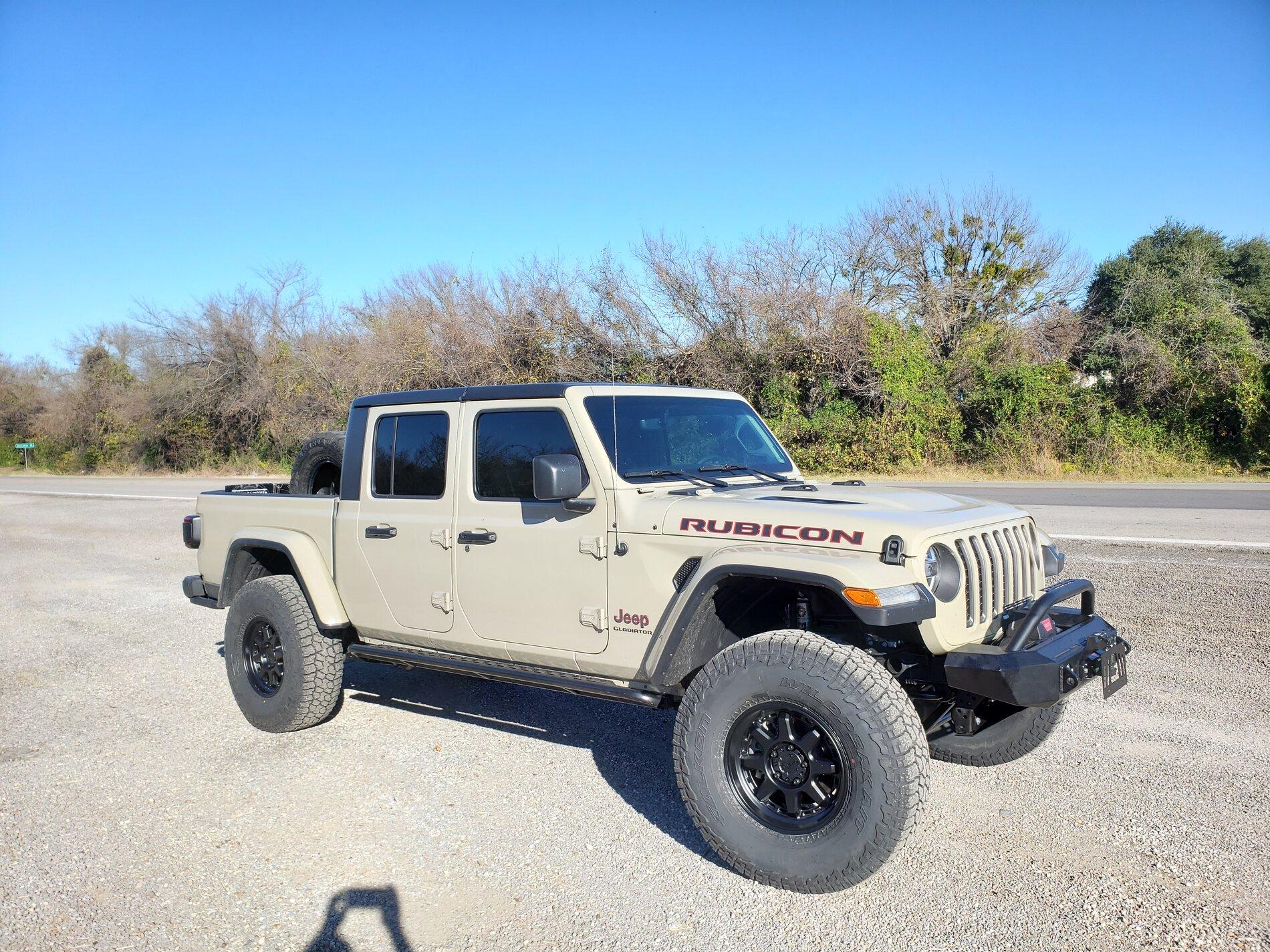

JEEP GLADIATOR RUBICON 2021

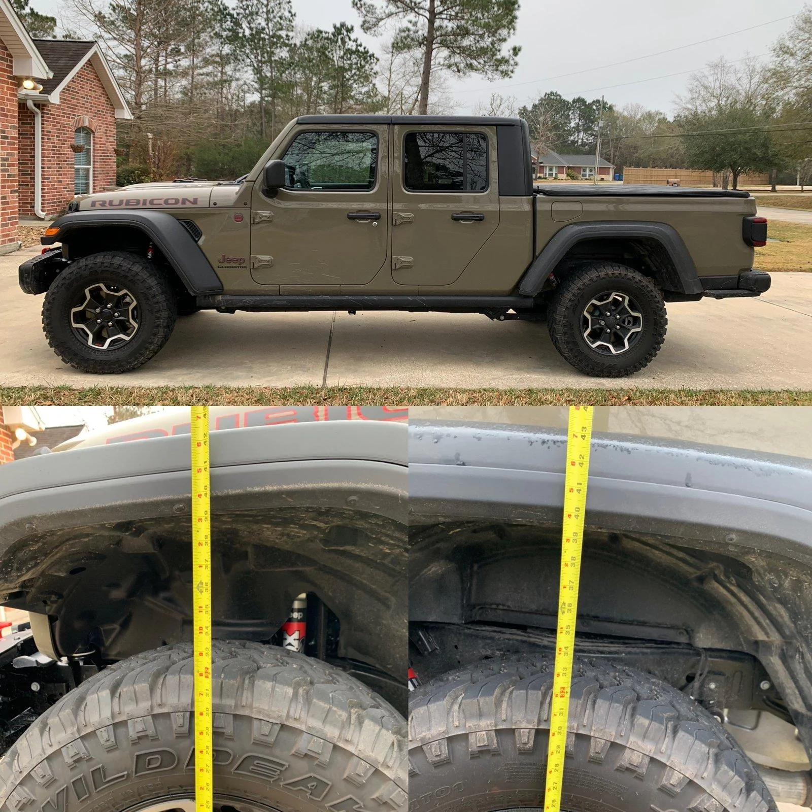

Here is my stock gladiator rubicon measured from ground to bottom of fencer at center of wheel hub. The section of the front fenders is higher between center of hub and door, but at center of hub, it’s actually 1/4” to 1/2” rake lower from rear at the same center of hub reference point..
Front: D@39” & P@39 1/8”
Rear: D@39 1/4” & P@ 39 1/2”.
Driver side being lower is probably due to full gas tank
it looks like if it has a level kit on the front

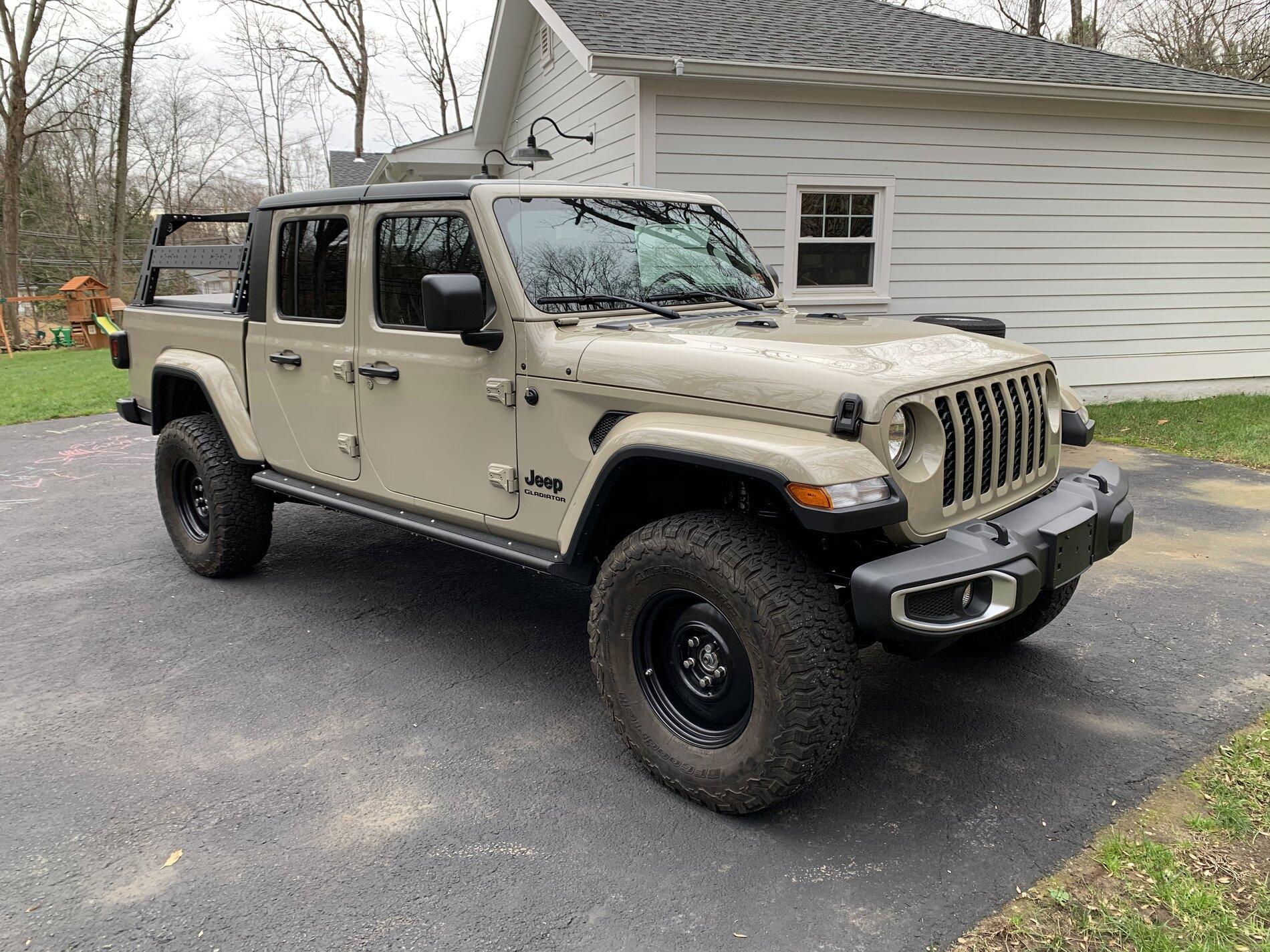

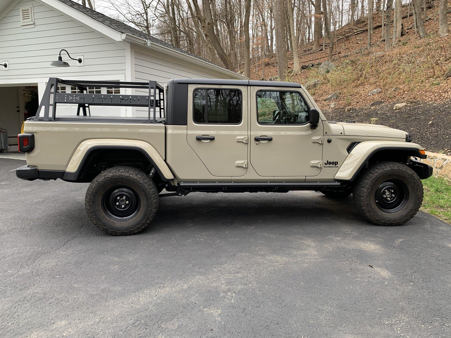

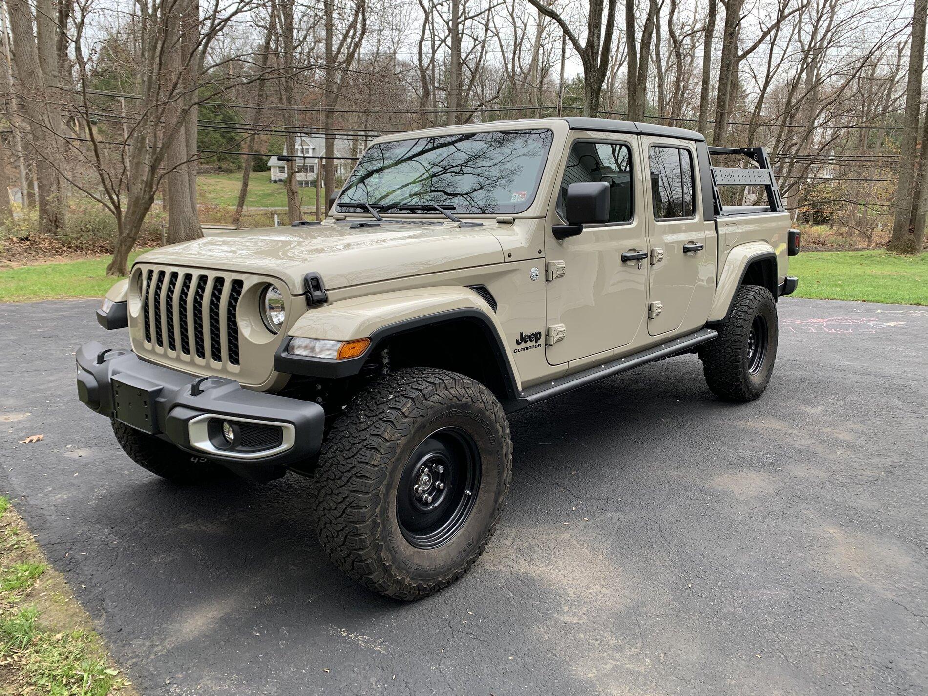

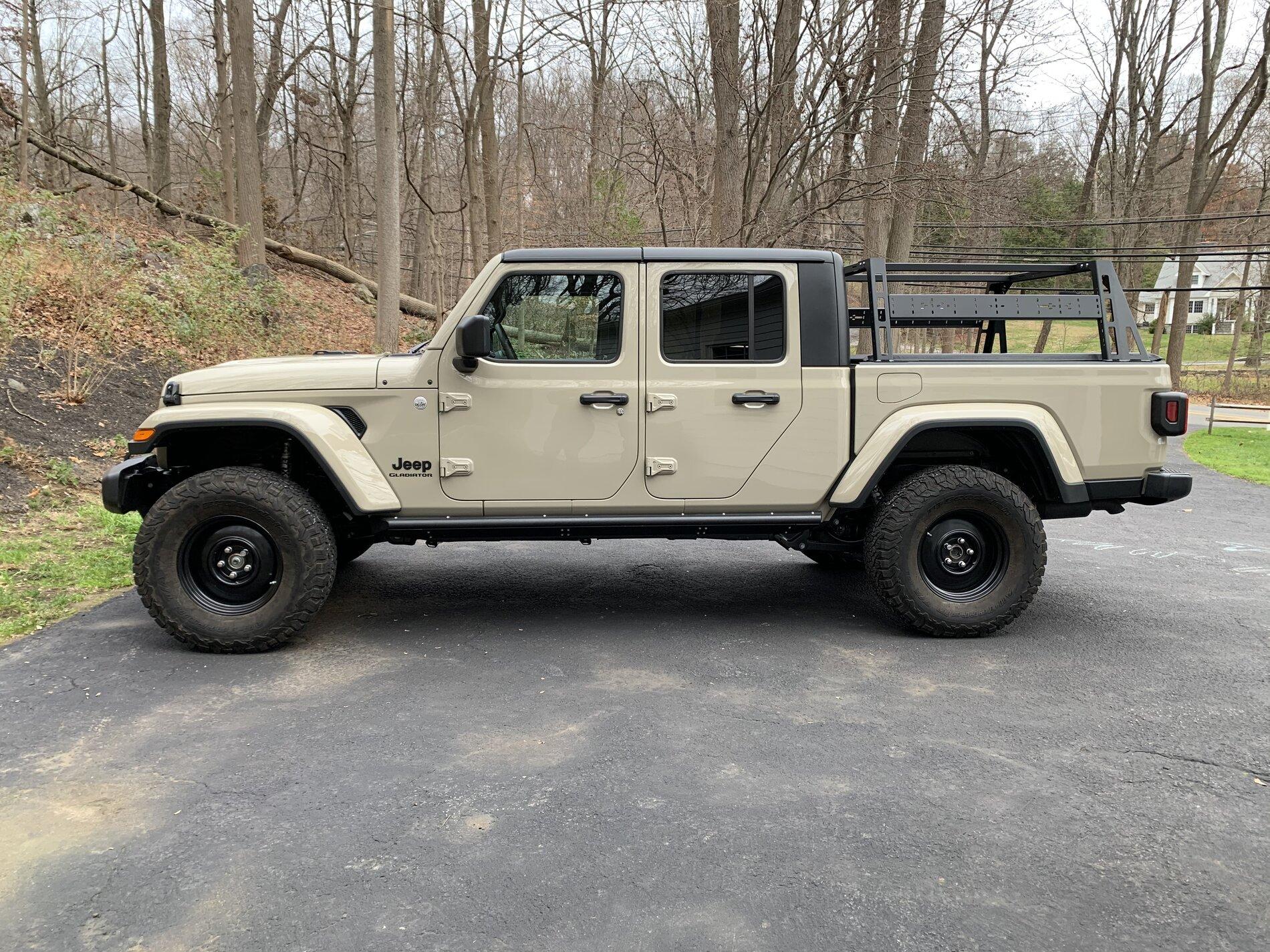

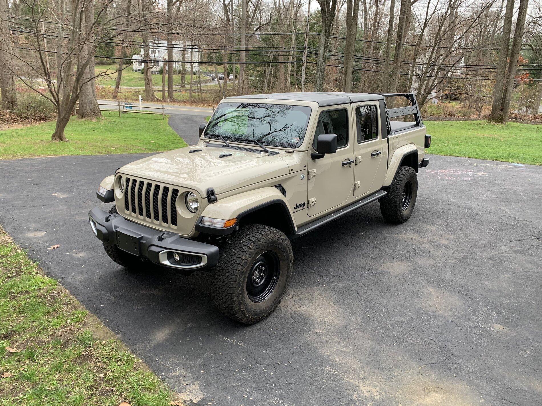

2" Mopar, 1" Teraflex front level, 37x12.5r17
hey do you have a full on side shot and can you measure from ground to your rail? I see you went 1" is that due to the bumper and winch? but ive also seen people go 3/4" daystar and it "levels" out fairly well.

I'll have to get you a measurement tomorrow. I went with the 1" level for bumper/winch. I saw some 3/4" levels that still had more of a rake than I wanted, so I opted for the 1".
Jeep Gladiator Gladiators on Mopar 2" Lift Kit 20201117_155224

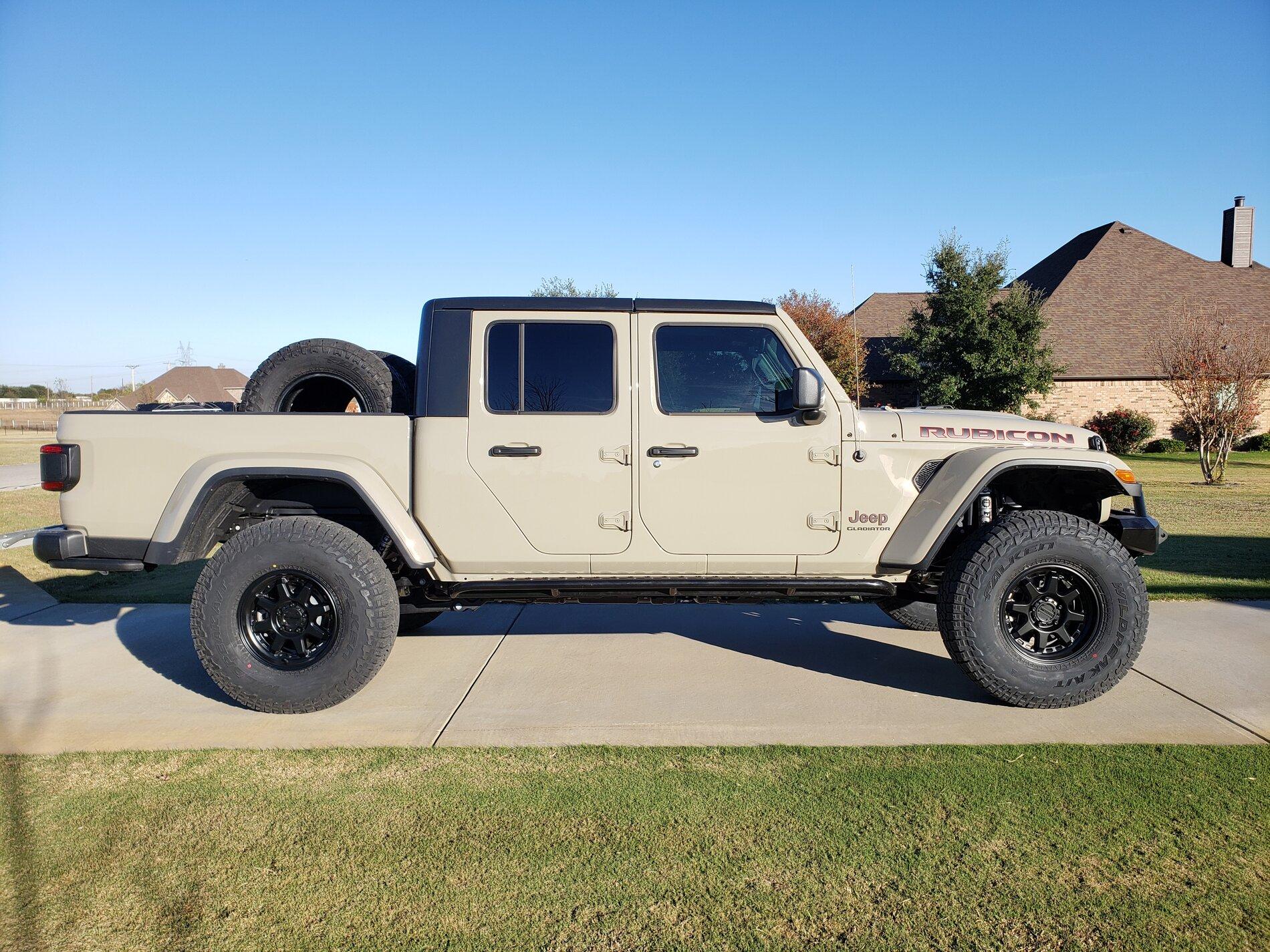

So my Shrockworks sliders are about 23.5" from the ground to the top (where you'd step on) and about 20" from ground to the square tube underneath. Frame rail is about 18".

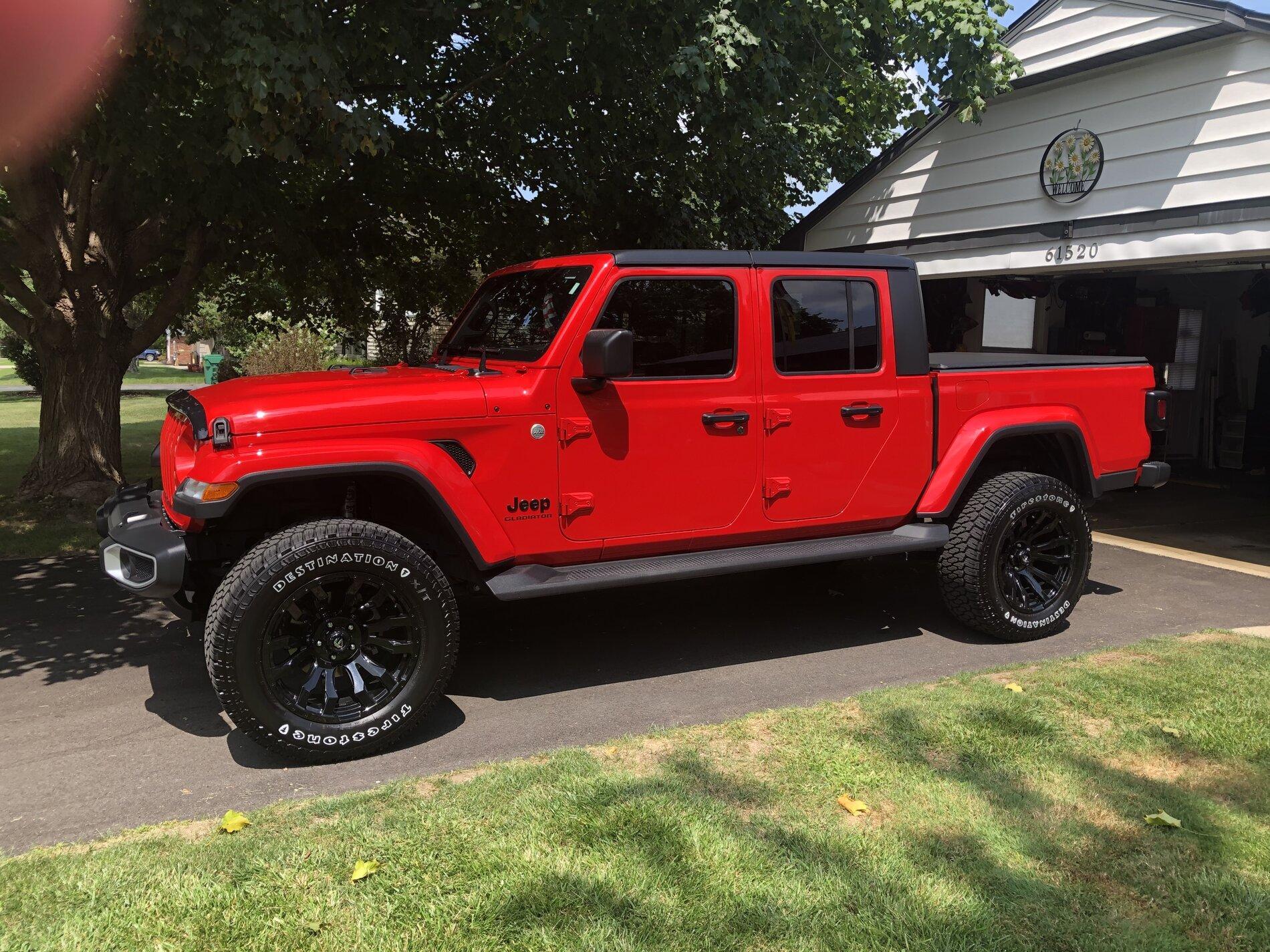

I’m about to get my mopar 2 inch lift installed with 3/4 “ daystar level front level kit as well as 35 inch toyo open country at3 and fuel 18 in wheels. My dealership is telling me that after the tire upgrade I need to have the vehicle calibrated for the new wheels. Is this a thing? It was an after thought the guy at the dealership had and it’s making me think it might be something else they’re trying to get money for. Appreciate the input!

You can have them calibrate it for the larger tires or you can buy a tuner and do it yourself. If you buy a tuner you can use the other features included with the tuner. Most people go that route for that reason. If you dont calibrate it your trans shift points and speedo will be slightly off.

To take this further, what the dealership has to do is actually send some info to Jeep and have them provide the new flash file for your vehicle depending on the tire size. I assume this has to do with the mileage/mpg/shifting differences due to the larger tire and keeping everything legal since having an odometer that isn't "actual" can cause issues for service/selling.
