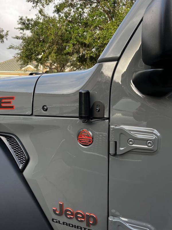

Depends on use. I run my ghost on side of hood. Never had an issue in my JT or JK with trail comms. On my JK I do have a second UHF radio with a 1/4 wave antenna. Its on a bracket on the rear.
So this location is fine?

Mine is further forward on the other screw. I'd move it up there if that's the plan. If your trying to talk 50 miles to repeaters and simplex then that won't work well. But for talking to a jeep in front of behind you that's fine.

That was the question... since I do not have a base... and I can install anywhere... what would be a good location that would work in both situations? Is that possible?
Thank you for your help/guidance.
Just in case... I plan on installing a half-roof rack... if that would be a better place for the install.

Sure others can comment but a jeep isn't the vehicle to get great comms with. Unless you want an antenna dead center of your hood you won't find the optimal location. Lots of posts on this forum of ideas. Adding aluminum tape under those plastic pieces or the cowl will help. A lip mount on the side back of the hood is a good compromise. Do some searching here and you'll find lots of good info.

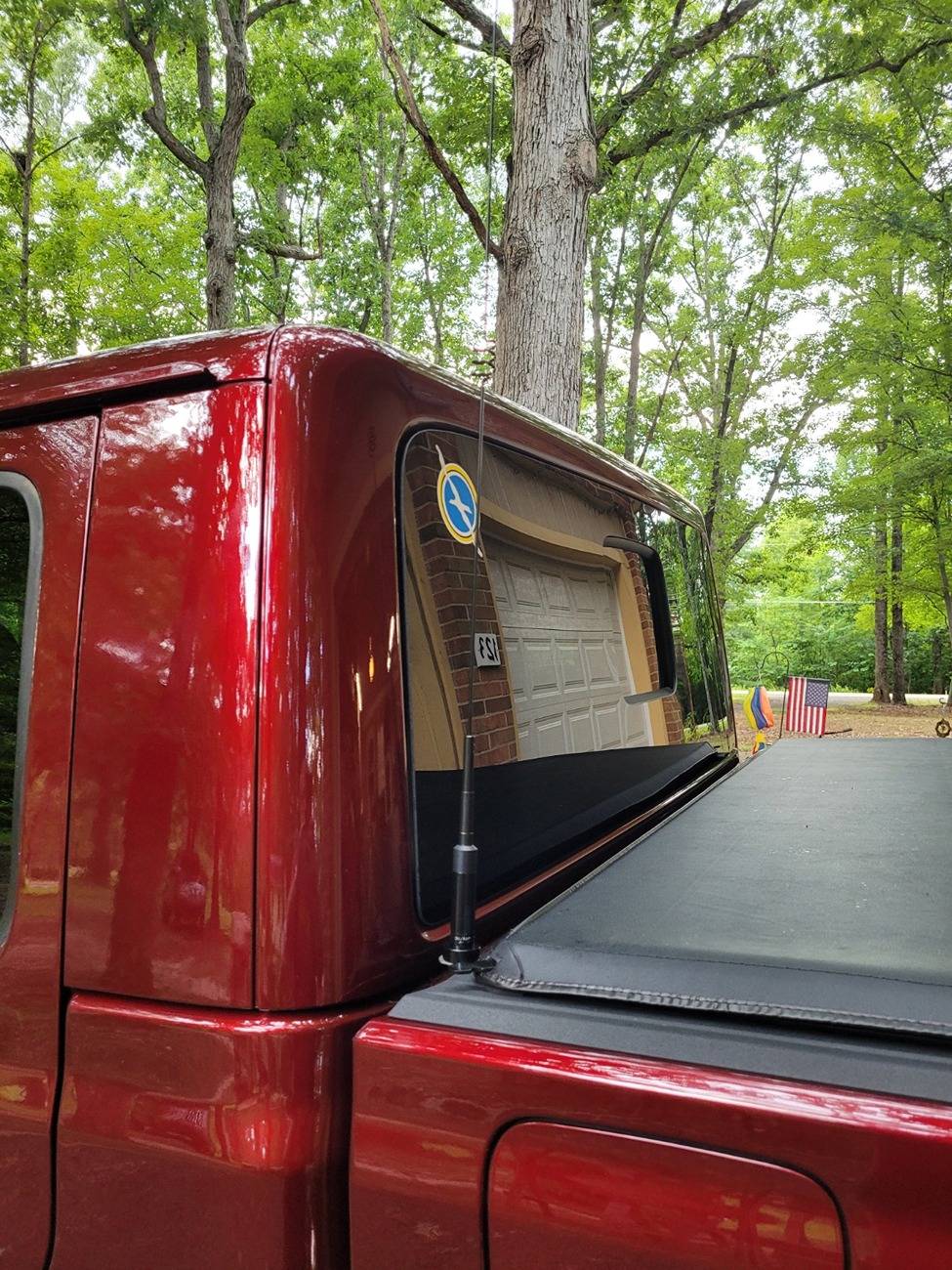

My antenna is mounted to the bed on the drivers side.

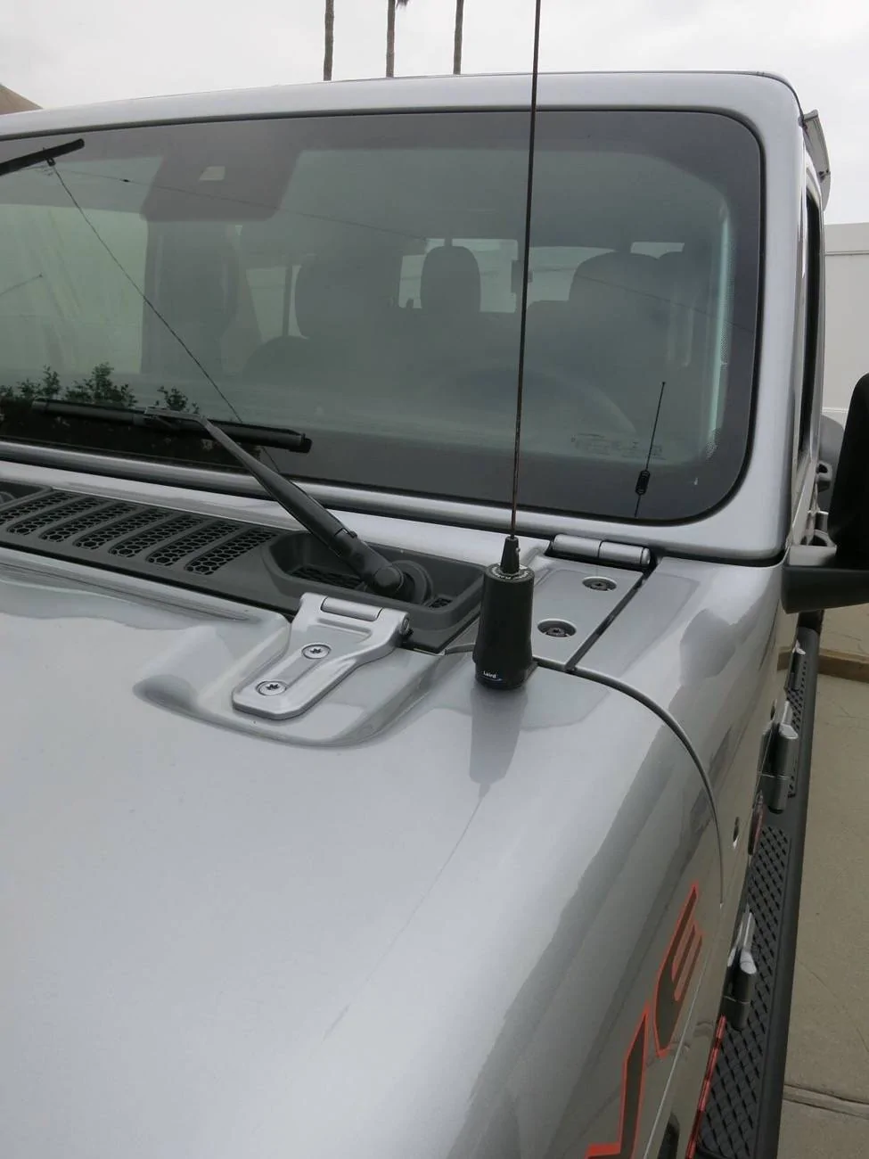

Top of hood using a trunk lip mount is the best place I’ve found. The side of hood mounts don’t provide a good ground plane and put the antenna base about 6” below hood level like my response to a post below. GMRS is UHF and mostly line of sight, what can the antenna below see?
Thank you. I will do the same. Ordering the mount today.
