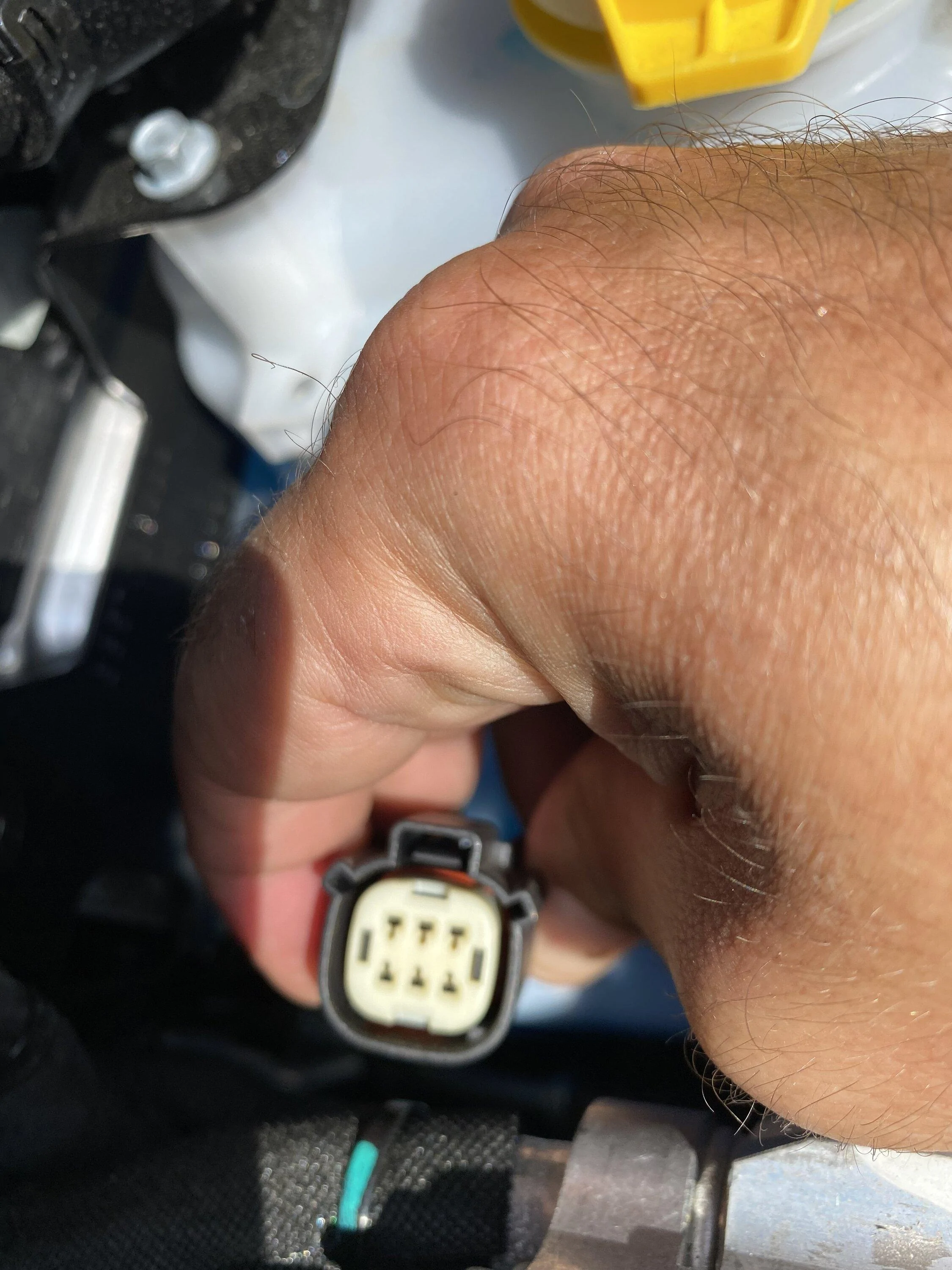

2022 glad Willy. I was trying to upgrade my head lights to use an led bulb. Everything I read said it was a h13 9008 replacement. Order two different sets and they had a different plugs, they were 3 prong plug in a line. My plug on my 2022 glad Willy is a 6 pin.
anyone know what type of plug that is ? I thought it was just plug n play but, both setts I bought the plug did not match.

I attached a photo of the plug on the jeep. Did it not attach or upload correctly?

I checked out that link. either end of that plug does appear it will fit a standard H13/9008.

the plug in the link is the same as what you have pictured. i just bought it about a week ago and make an extension for my factory headlight harness. my jeep had factory led headlights and uses 4 of the 6 pins on a mx150. not sure if this is helpful information for you or not.
