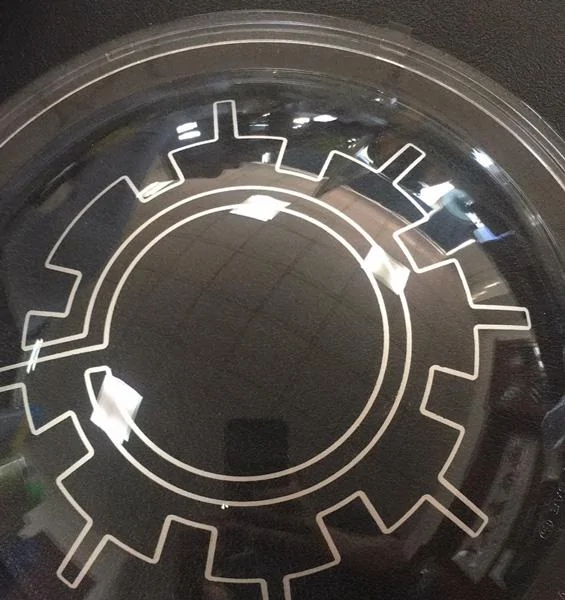

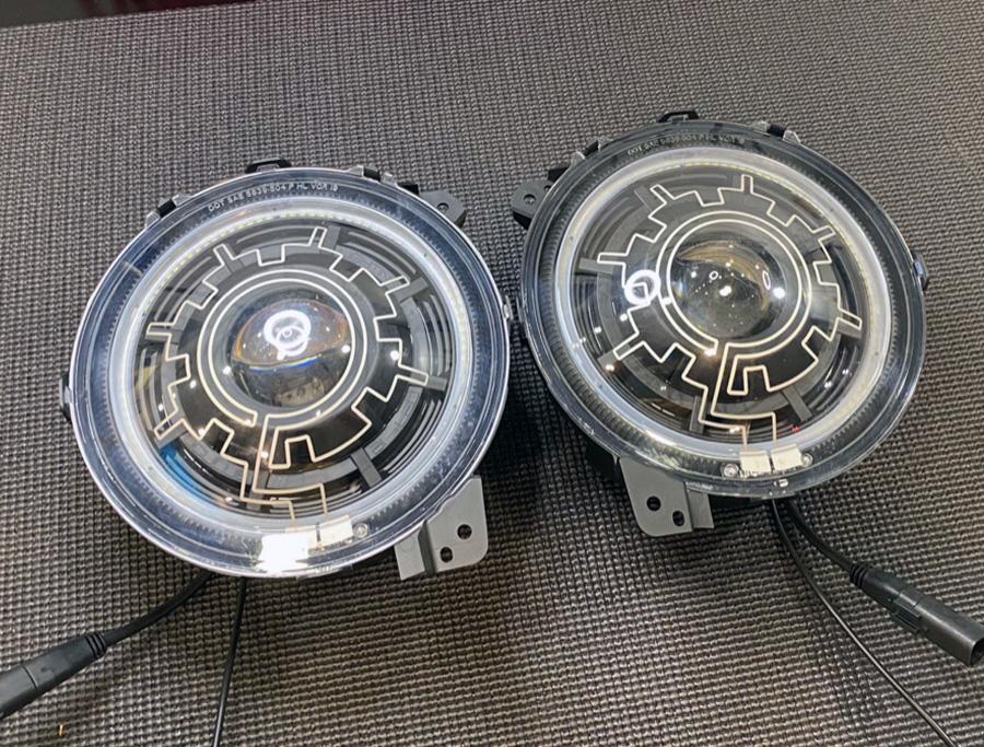

So the process of integrating the heating element into the radius curve of or Oculus lens was far more complex of a task than we initially thought but we were finally able to work with a partner with the equipment needed to do this correctly.
The other cool thing is that the heated design mirrors the bezel design of the Oculus lights so it does not look like an afterthought like a lot of the other options out there.
For those of you looking for a heated option we would like to offer these at a discounted price to 2-3 members here who would use these through the winter and provide some feedback. If you would be interested just post here in the thread and we will reach out when we have some units assembled.

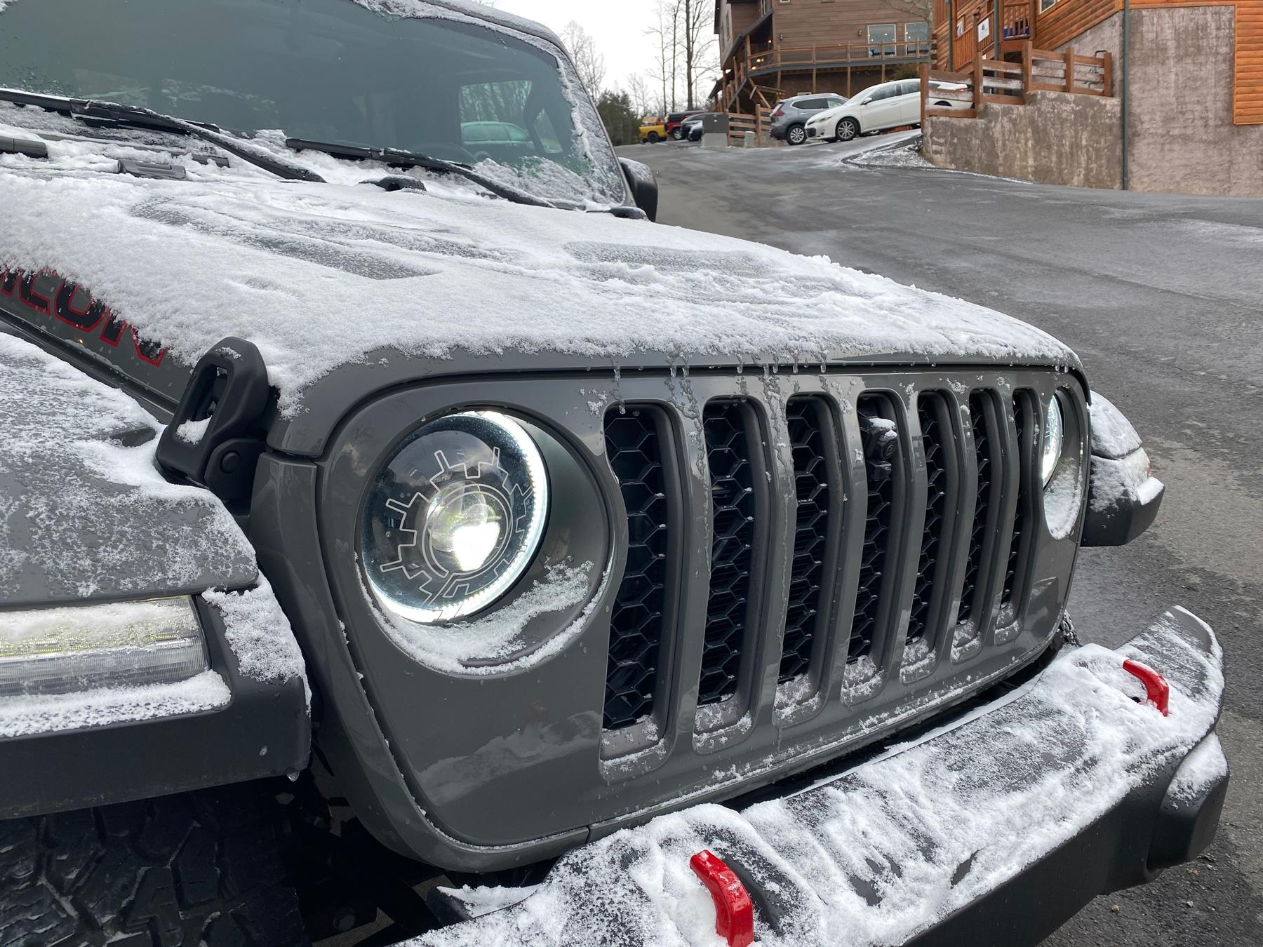

We have our initial prototypes assembled and installing for a snow test next week. Will have more info soon!
Jeep Gladiator Who here does not use LED because the lens is not heated? IMG_3076.3

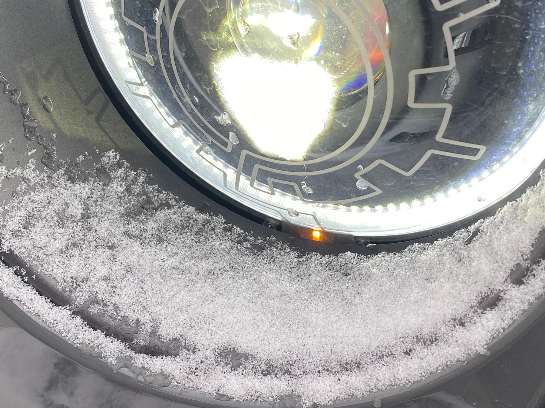

Initial cold weather testing is going very well, we are making some small adjustments to the programming but excellent results so far!
This design is 100% plug and play, no additional wiring required for the heating element. Integrated temperature sensors are built into the lights and the lights include a small status LED to tell you when the heater element is on.
Jeep Gladiator Who here does not use LED because the lens is not heated? IMG_3211
Jeep Gladiator Who here does not use LED because the lens is not heated? IMG_3214
