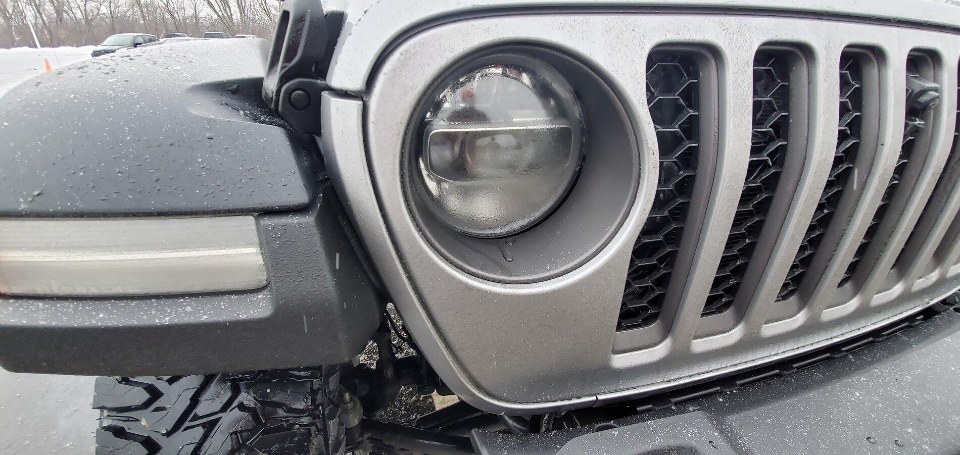

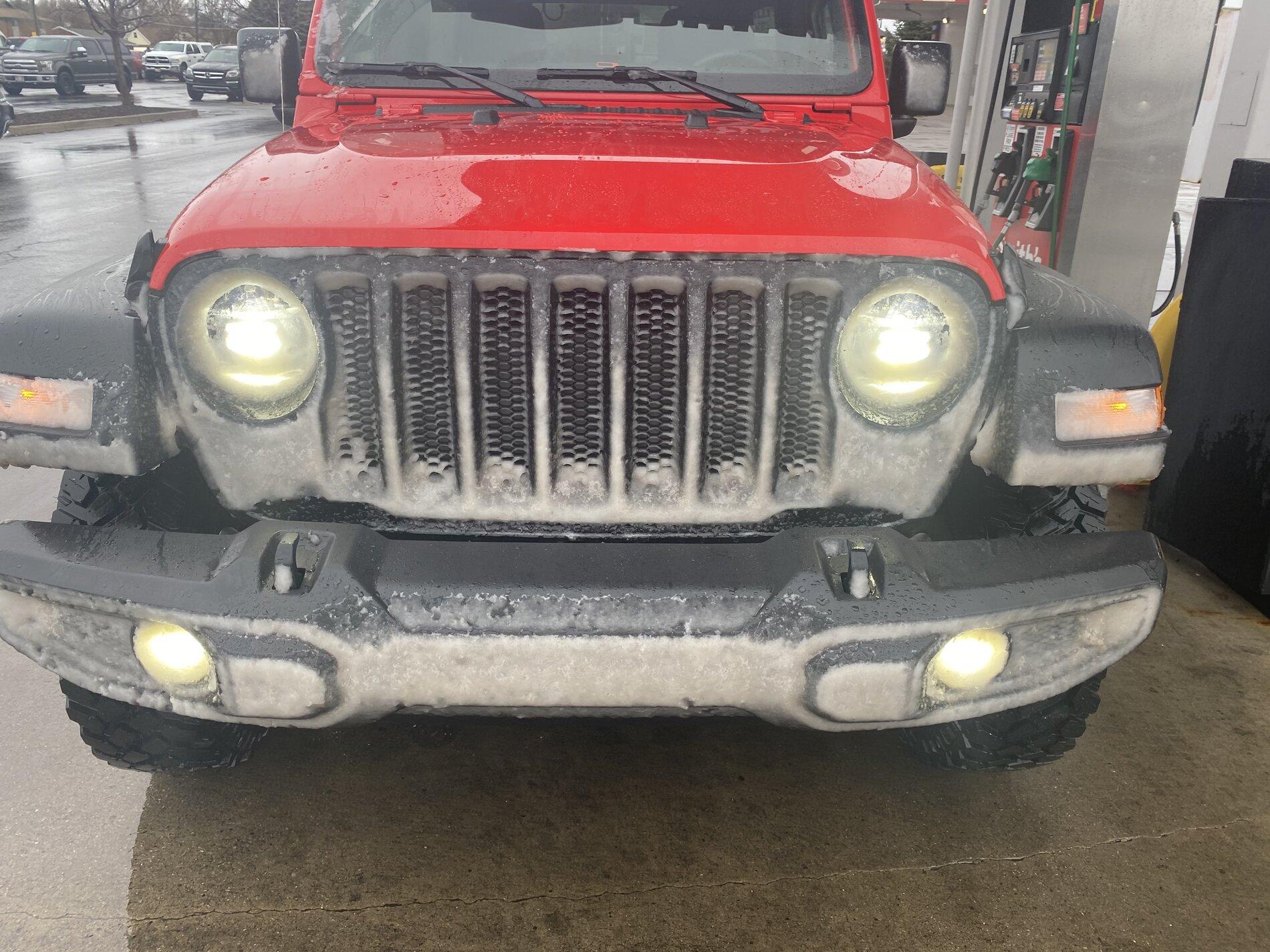

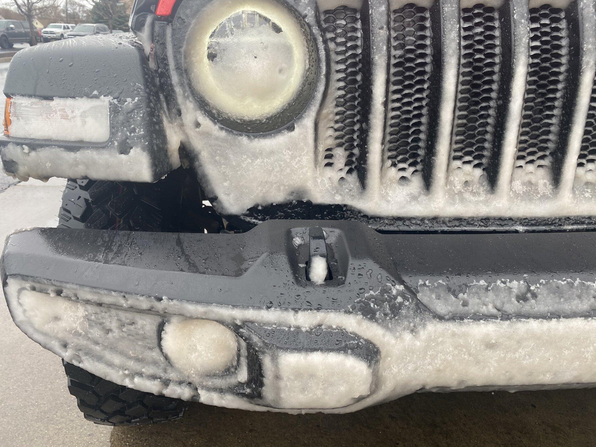

Who here does not use LED because the lens is not heated?
syreeves
Steven
Nov 30, 2020
778
846
Minnesota (aka Hoth)
Here is a pic from Wednesday. Light snow plus road spray and temps around 5F - driving at 65ish mph from Cologne MN to St. Paul MN - about 35 miles in 35 mins. Headlights were on the whole way...
When can I buy your heaters @ORACLElights?!
Jeep Gladiator Who here does not use LED because the lens is not heated? 20210218_090449
