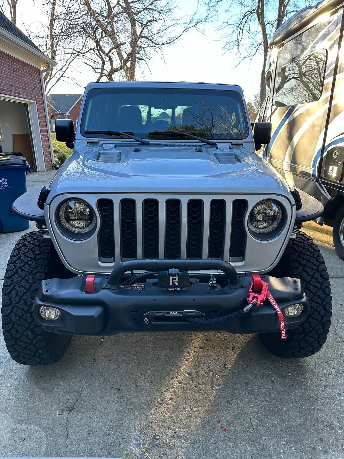

Be careful with the bulbs. The Halogen housings aren't made for LED lights, so it can cause light to be thrown in goofy directions and flashing with some of the bulbs.

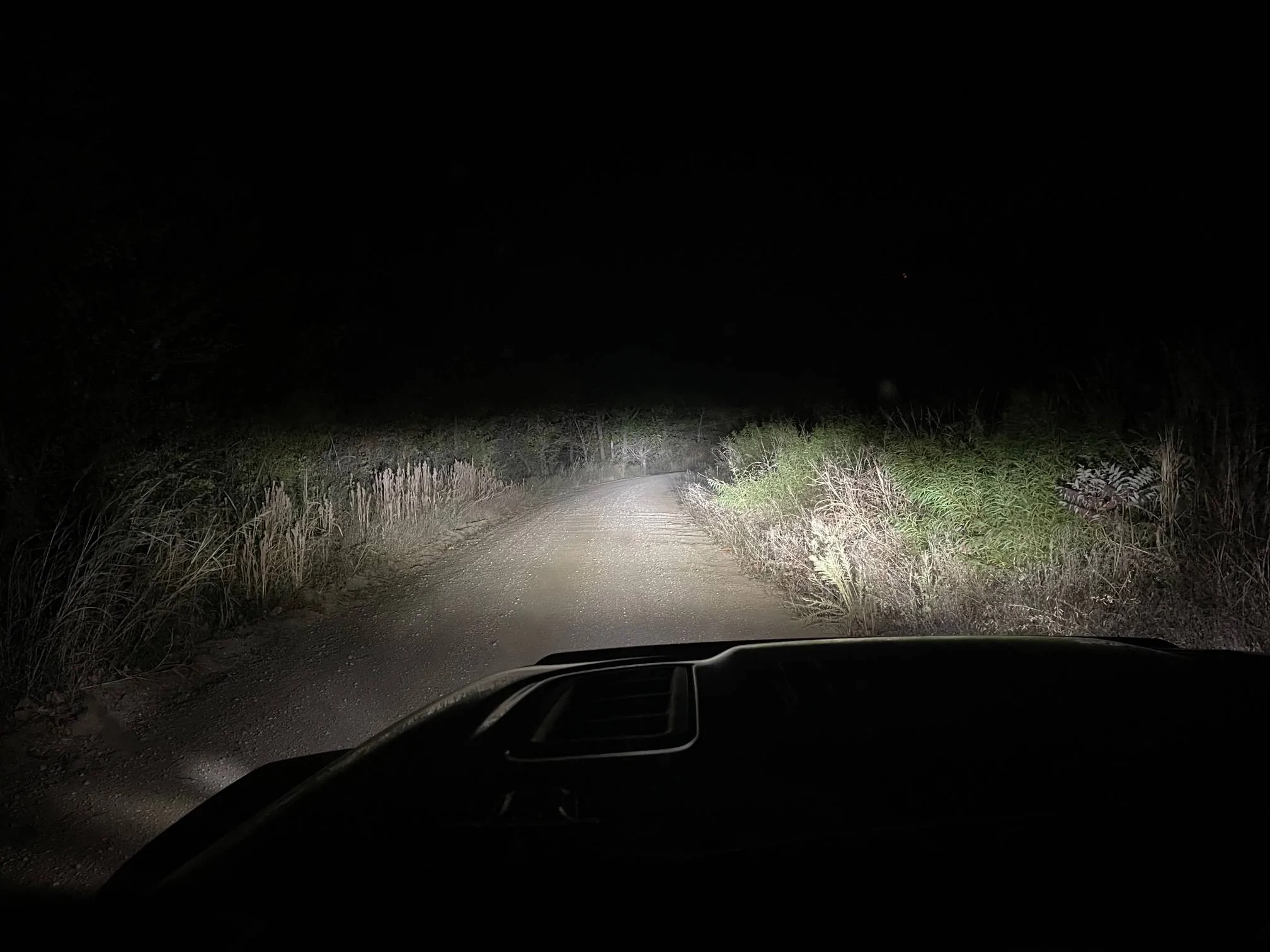

I put LED lamps in my halogen housings, and the results were OK. Much better light output, the upper cut-off (low beam) was adequate, but you've got to be careful with aiming. I ran this way for about a year.
I then upgraded to true LED headlights, and the cut-off is well defined, the overall illumination is more consistent, and the high beam performance is improved.
LED lamps in halogen housing will work, but if you can afford it, go with true LED headlights: the performance is quite a bit better.

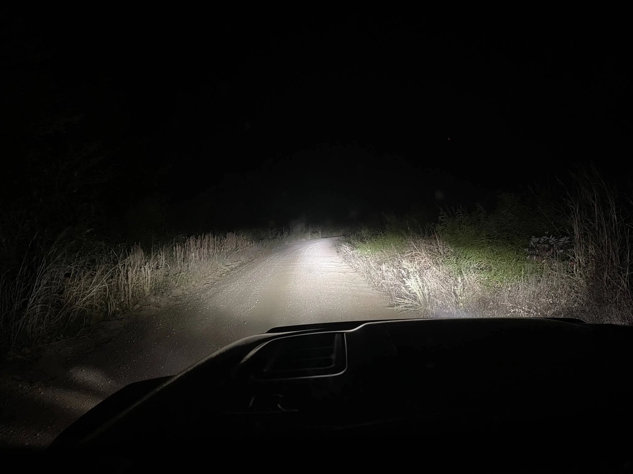

The Beamtech bulbs you linked are the ones I used and they worked well for me in the halogen housings. As others have said, just be sure you aim them properly. For fog light bulbs I went with these and liked them. https://www.amazon.com/dp/B08C5BHP2G?ref=product_details&th=1
Swapping out the halogen headlight bulbs for LEDs was one of the first things I did and they were a huge improvement. After a year and a half I went with Diode Dynamics LED headlights and fogs. In my opinion upgrading to complete lights was worth the cost. Both Diode Dynamics and Oracle run sales fairly often which helps with the cost but they still aren't cheap.
Attached are pictures with the LED bulbs. There is a little shading because of the halogen reflectors but it wasn't bad. I'll also include a picture that shows how crisp the beams are with the full LED lights.
Which led housings are the final picture?
