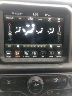

Jeep Gladiator Heater/AC blowing hot air at 60 or higher jeep heater 2

Sorry you keep giving long explanations of you why you think other peoples experiences are normal function of the HVAC when it’s not.
Explain to me why when the outside temperature is the mid 60s, mine blows full heat from HI to 61. To be clear when I would have it on 62, it’s FULL heat. ONLY when I drop it to all the way to LOW and then back up to 62, I get cooler temperatures. This is repeatable and has been since I’ve had the Jeep.
When I took it in to the dealer for my 10k mark I asked them to follow the exact instructions I gave above. They said supposedly they couldnt repeated it. I thought hey, maybe they did a flash and it fixed things. Got in the jeep, same thing. HI heat on every temp until 61, then only when I drop it to LOW do the temps from 61-74 reflect what they are actually set at. Note, this is with AUTO off.
Could this be a bad blend valve that is stuck until it’s put all the way in low? You’ve repaired vehicles for your whole life, I know you can come up with an explanation or theory better than what the dealer and you have told me.... it works as designed. Sorry, that’s BS.

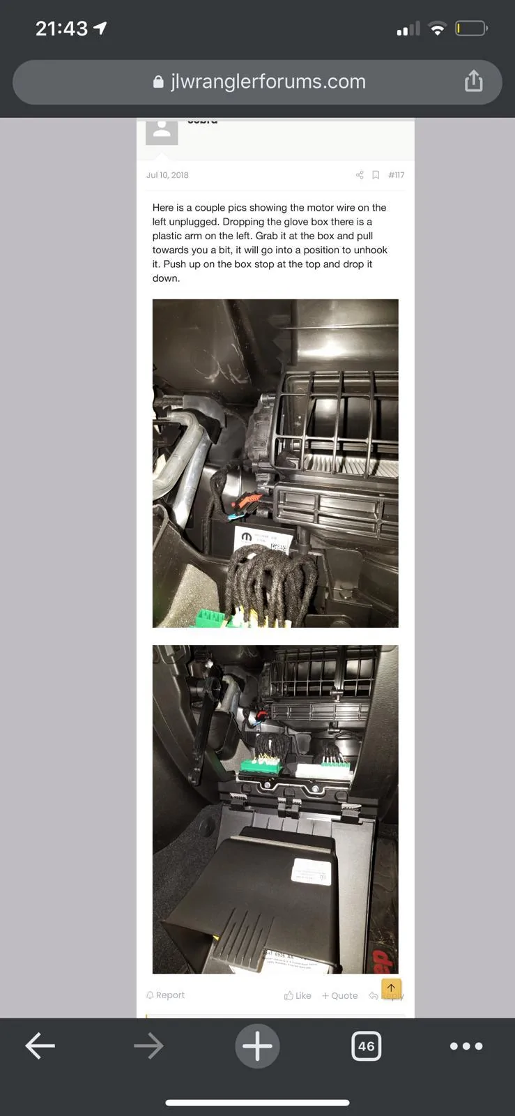

It’s really only a problem for me when it’s cool outside. Now that the temps have finally dropped in Florida. It’s back to working like garbage. Between this and the random hot/humid blasts of air from the vent opening under the dash, I hate this AC
This is how I fixed the humid burts of air. you lose the recirc/ fresh air option tho. It stays on whatever option you last had before you disconnect it
Jeep Gladiator Heater/AC blowing hot air at 60 or higher A943F366-08D7-42A4-9A5F-71A8EA81B7C0
