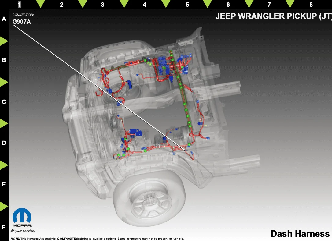

Looked at this again today. Can-C is 100% loosing coms with ABS module intermittently. Might be a pinch or kinked twisted pair front the ABS. My guess would be the ground for the ABS module, loose or dirty grounds tend to be pretty common these days (Stellantis has dropped the ball on assembly line control). Check here and see if there is corrosion, paint on the eyelet, or it you can rotate the wire at all by hand, should be rock solid snug with no chance of moving it with the nut tight.
I always suggest for checking of connections - don't just look, take it apart, then look at where the parts make physical/mechanical and electrical contact, and clean them.
I've had too many people come back and say "I looked and they are clean" only to actually have voltage drop at that point - enough to cause trouble but not be visible. Oxide films are thin.........
Sometimes the act of loosening a nut, then moving the wire a few degrees back and forth, and tightening it up again is enough.

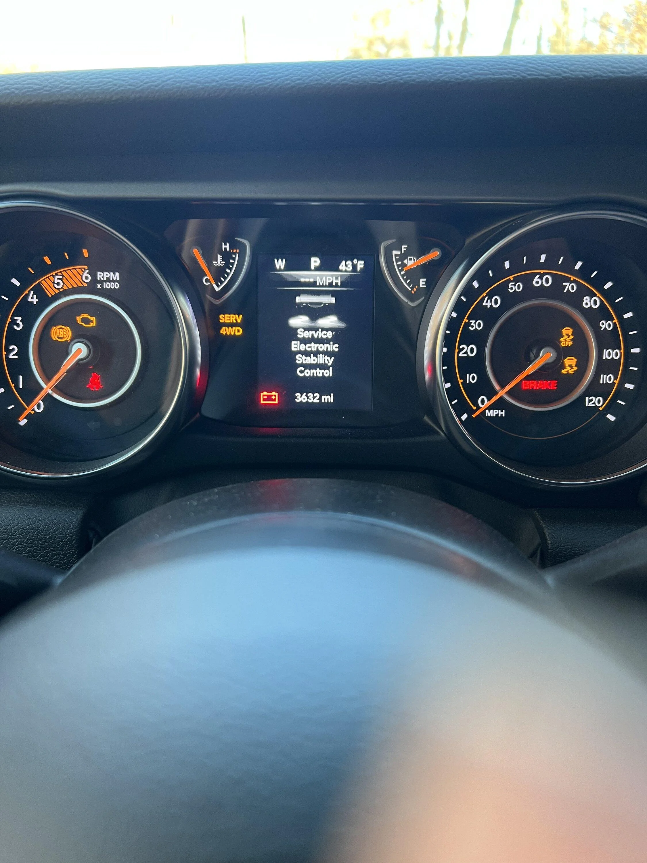

All the same lights you mentioned came on in mine. Problem is, my brake was locked too so I was unable to press the brakes to start the engine or even shift out of park. I had to have my Jeep towed to the dealer. I only have less than 4000 miles and just purchased it earlier this year. I’m afraid of being jerked around with the dealer too as I already was with a different issue I was having. Do you have an update with why all these lights came on?

What do any of those codes mean?! So basically they had to replace the sensor and it fixed the issue of all the lights coming on?
250
40,619
54,306
In HIS case it did.
But it's extremely assuming and not helpful to "assume" that what fixed his will fix another.
Maybe, maybe not.
The codes were all dealing with ABS, stability control, wheel sensor input and so on.
These do a POST, power on self test. If they don't see a connection through certain sensors, it throws an error code.
When you start to move, and get to about 7 mph, another ABS test is done - sometimes people hear it happen - and if the results don't make sense to the ABS module, more codes may be triggered.
Not communicating with a sensor can mean the sensor itself, the tone ring the sensor senses from could be muddy, dirty, the wire TO the sensor could be bad - pinched, pulled by someone not being careful installing a lift or springs, any connection between the ABS module and the sensor it can't read from or get a response from could be open or bad.
A sensor is just one link in a chain from ABS module to the wheel area.
Sometimes those wires get damaged by people in a hurry or not taking care when dropping the axle for spacers or taller springs.
In my case on an older Jeep - it was the ABS module itself that was bad - a connection within. The light came on as soon as it was doing POST - it wasn't able to communicate with the wheel sensors, they were all fine, all good, as was all of the wiring.
You need to know what codes were involved in YOUR case. You can't say they were the same unless the codes line up. Maybe they will be, but.......
It's not common for sensors to go bad unless there's another issue - like in the case of the other guy. Normally wiring and connections are the first things to look at. There are Jeeps out there that are 20 years old, over 100,000 miles, with all original wheel sensors.

The dealer had to replace my catalytic converter a week ago. When they changed it do you think they may have accidentally touched a wire from underneath? Or is it mostly just a technical system error? My car was towed to the dealer but they didn’t have any availability until Wednesday, so I’m just trying to get an idea what may have caused this.

To have that many dtc, it's definitely a loose/bad connection somewhere, or short to ground. I had a similar instance after going a lil to deep too many times. Had a wet connector that wouldn't let me start vehicle. 1 week later after drying out, I was good, cleared codes, and drove fine... till I got sand in motor at a much later date.
