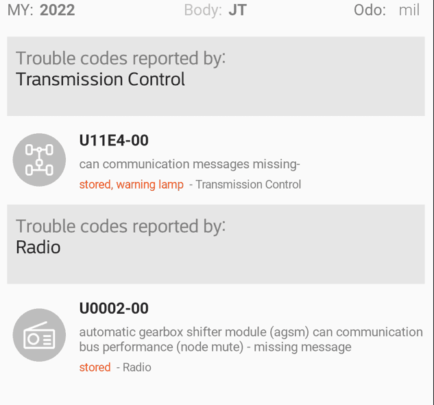

I have not received any notice, no one has contacted me, no card, no call, nothing, but my build date was 06/24/22 and the TSB says it applies to JTs built before 06/29/22
24 is before 29
I found 3 "pending" codes for misfires, and a shifter CAN bus code (unrelated) so I need to chat with a dealer anyway and see if my VIN is on the FCA list.
Apparently not as I've not been notified.
Jeep Gladiator Check Engine light 1661192822261
The CEL was for the transmission code.
But there is a history of misfires, and things that are not yet explained like the pending codes for misfires.
24 is before 29
