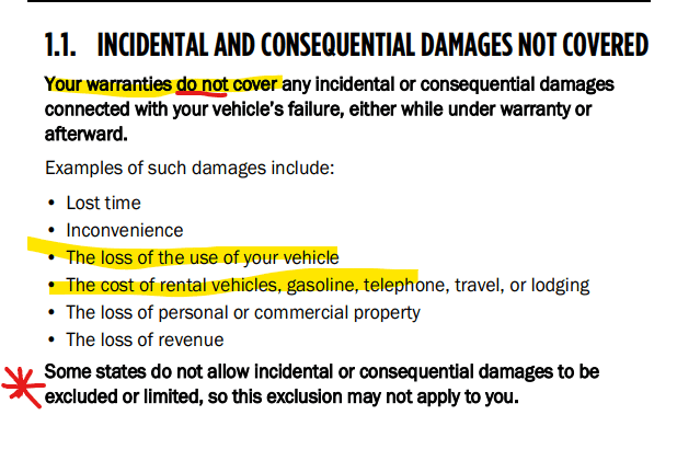

Well, I just got the call from the service department regarding my CEL. There was a TSB to flash the PCM and it didn’t take and now the truck is inoperable. Of course the new PCM is on back order and they have no rental cars. I’m not real happy right now.
If your dealer doesn't have any loaners you gotta press em. They do have obligations for warranty repairs that render the vehicle inoperable. My old KIA dealer swore there was nothing they could do because they were out of loaners. Called Kia VIP line (special Kia customer service number for K900s and Stingers only) and next thing you know my dealer is picking up my tab at enterprise for a luxury class vehicle (broke car was a K900). Then I got to enterprise and found out apparently that dealer had an account at that enterprise location and did this sort of thing normally... just they wanted to he obstinate dickheads and save some money by trying to screw me out a loaner I was entitled to.
250
40,612
54,309
No, they don't have obligations.
People always assume that, but it's a courtesy, not a part of the warranty unless you buy a warranty that specifically covers loss of use or rentals/loaners.
They have no obligation, legal or warranty-wise. Nowhere is it stated they do.
That keeps getting assumed.
If they do, it's a nice thing, if they don't, then it's normal.

Yeah, it has been a YMMV situation that depends on the dealership. @ShadowsPapa is right, there is no requirement under the factory warranties that a loaner will be provided.
Been more than a few threads on the subject with people miffed thinking they had a entitlement to a loaner while a vehicle was in for warranty repair. Only carve out for loaner or rental assistance/reimbursement is with some of the purchased extended warranty/service contracts may have the language. The Jeep Wave program offers a rental/loaner but that is only if your vehicle is in for a same day scheduled maintenance service and not a overnight or multiple day time period.
250
40,612
54,309
