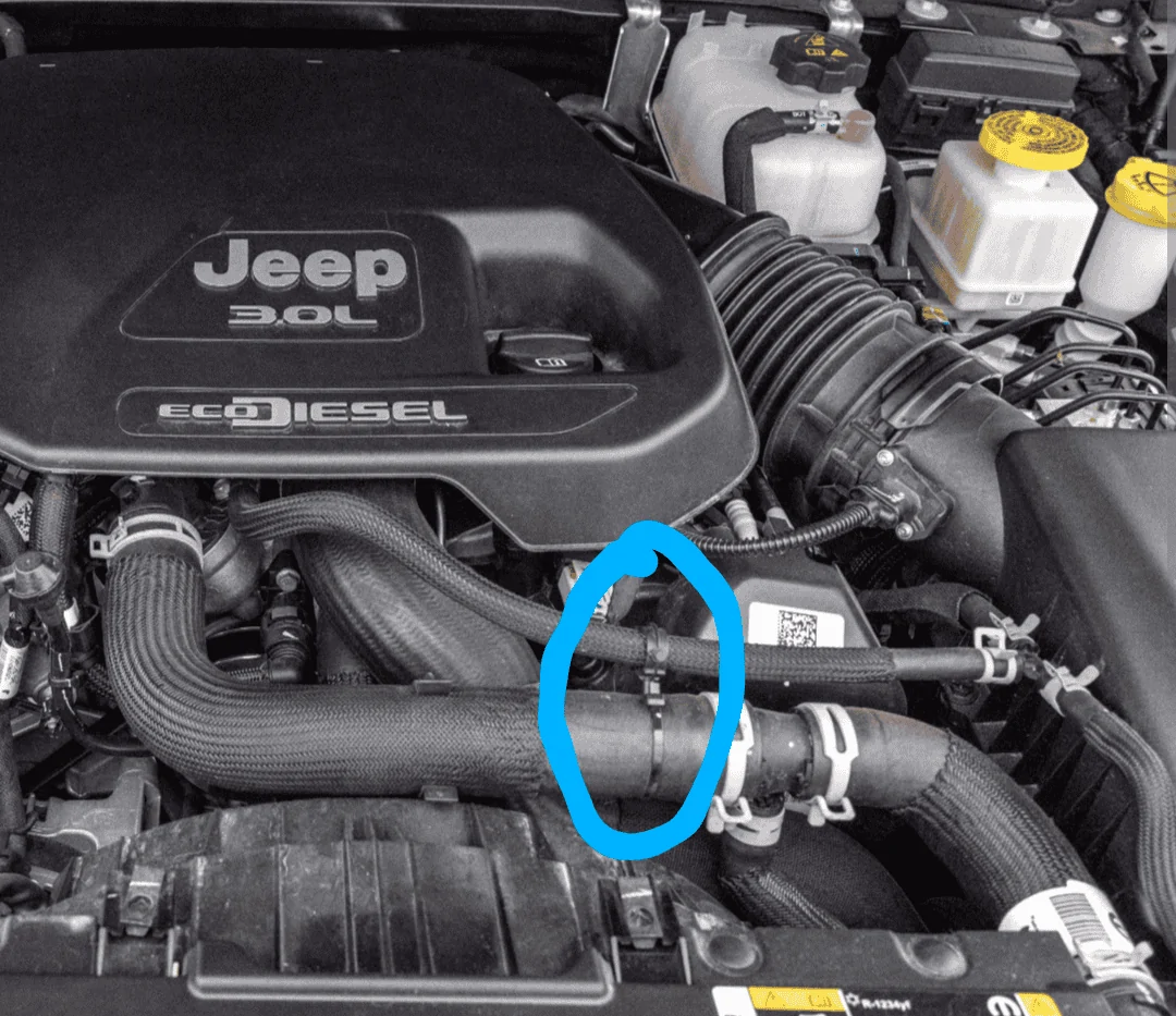

Does anyone know what the part number is for the clip circled below?

I was going to say... AAZIPTIEAB just kidding ?
Buy yeah, Moparparts can help.

Easy field repair for that if it's broken or missing: Two zip ties loosely around each hose, then join them with another tie. You can space it by adding additional ties to the link as spacers.

I went through this years ago on a RAM truck. The clip comes with the coolant hose and is not a separate order part. Want a new clip, have to get a new hose.

Sorry but this only appears to be serviced with a new Rad hose assembly. Im pretty sure you can find a good generic equivalent on amazon though.

If you have an u-pick junk yard nearby, you may be able to find one on a junker. I’m always snagging oddball clips and fasteners when I go. They usually don’t charge me for them.

Use a nylon bushing/spacer and figure 8 it with a large ziptie.
I have no idea where I got this idea (Boeing or Douglas), but I have seen it used in a very professional manner.
Well there may or may not be quite a few of uncle Sam's toys built that way. ?

Dang, thank you for all the responses! I kept running into it looking like I had to buy the whole hose assembly so that makes sense. I guess I'll just use zip ties.
