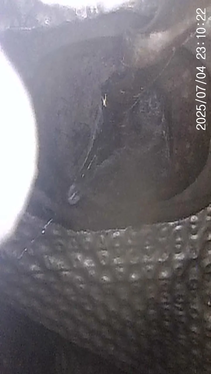

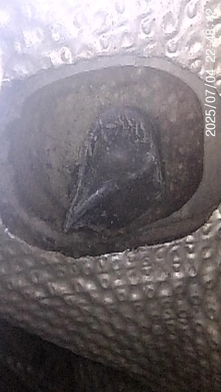

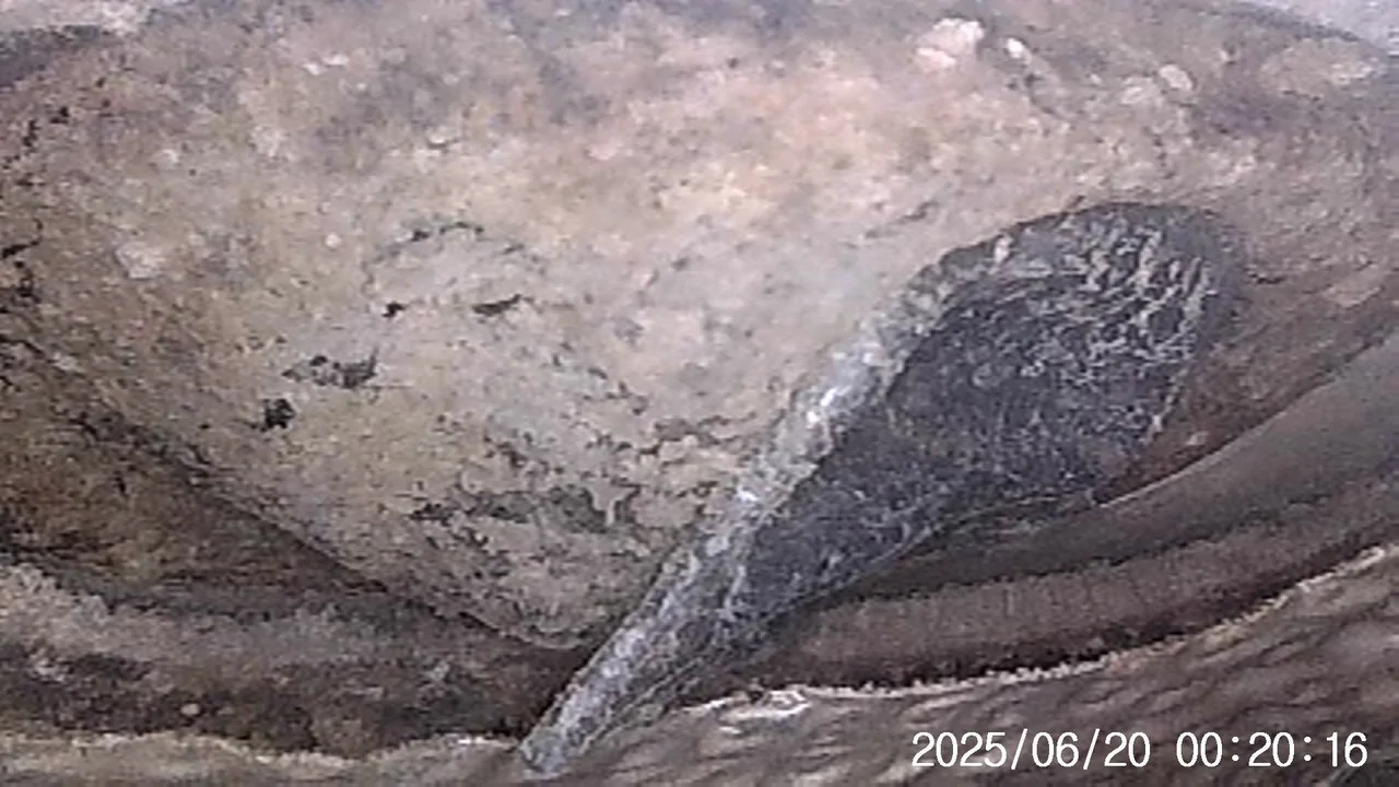

For the past couple months I’ve had problems with water in my passenger footwell when running the AC. It took me forever to finally find my AC drain because of the ecodiesel exhaust pipes in the way and also because my AC drain is unrecognizable. It MELTED and sealed itself shut.
I know the DPF gets hot during regen, but damn.

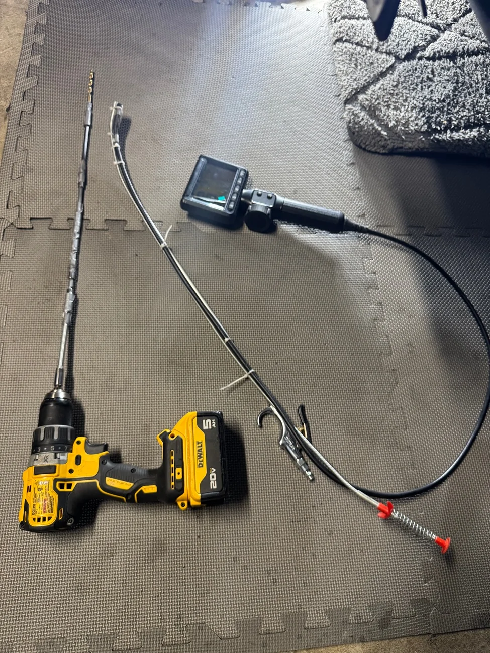

I had to drill holes in it for the water to drain out.

Smart move with the reach claw (is that what they are even called? lol) So if the drain melted, how are those wires doing? That's kinda nuts
Surprisingly, everything else up there looks intact. I still don’t understand how this happened and why only that one piece melted.

No one worked on it. I’m suspecting that this happened when I was off-roading and my DPF was doing an active regen. I guess it got hot enough to melt that plastic piece.

The melting point of these plastic pieces is ~300°F. The DPF gets up to 1,200°F. Things get a lot hotter down there when off-roading than just idling. That’s the only thing I can think of that would cause this.
