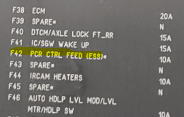

Don't sweat the amperage number - I wonder if someone goofed when typing out the amperage of that F42 fuse.
The critical part to look at is the fuse map in the cover of the PDC. Forget the amperage..
Make sure it looks like this - Be sure it says PCR CTRL FEED - that's the relay that controls whether or not the aux battery is connected to the main battery system. Removing that fuse means the PCR relay can't trigger an open and cut the aux from the main for the PCM to do a fast check during the engine start sequence. It will believe the battery is still there.

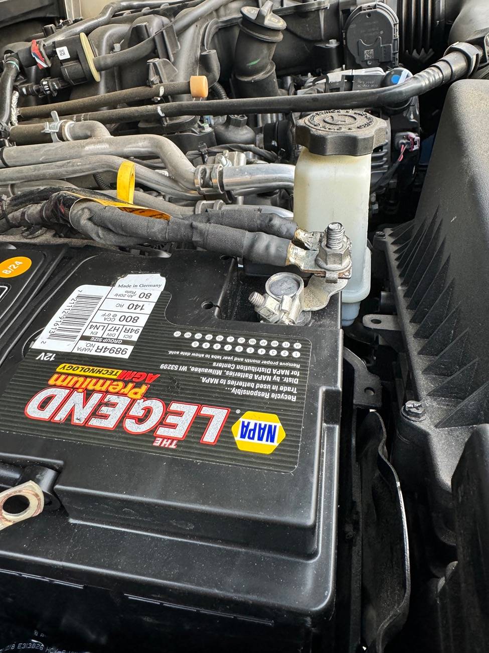

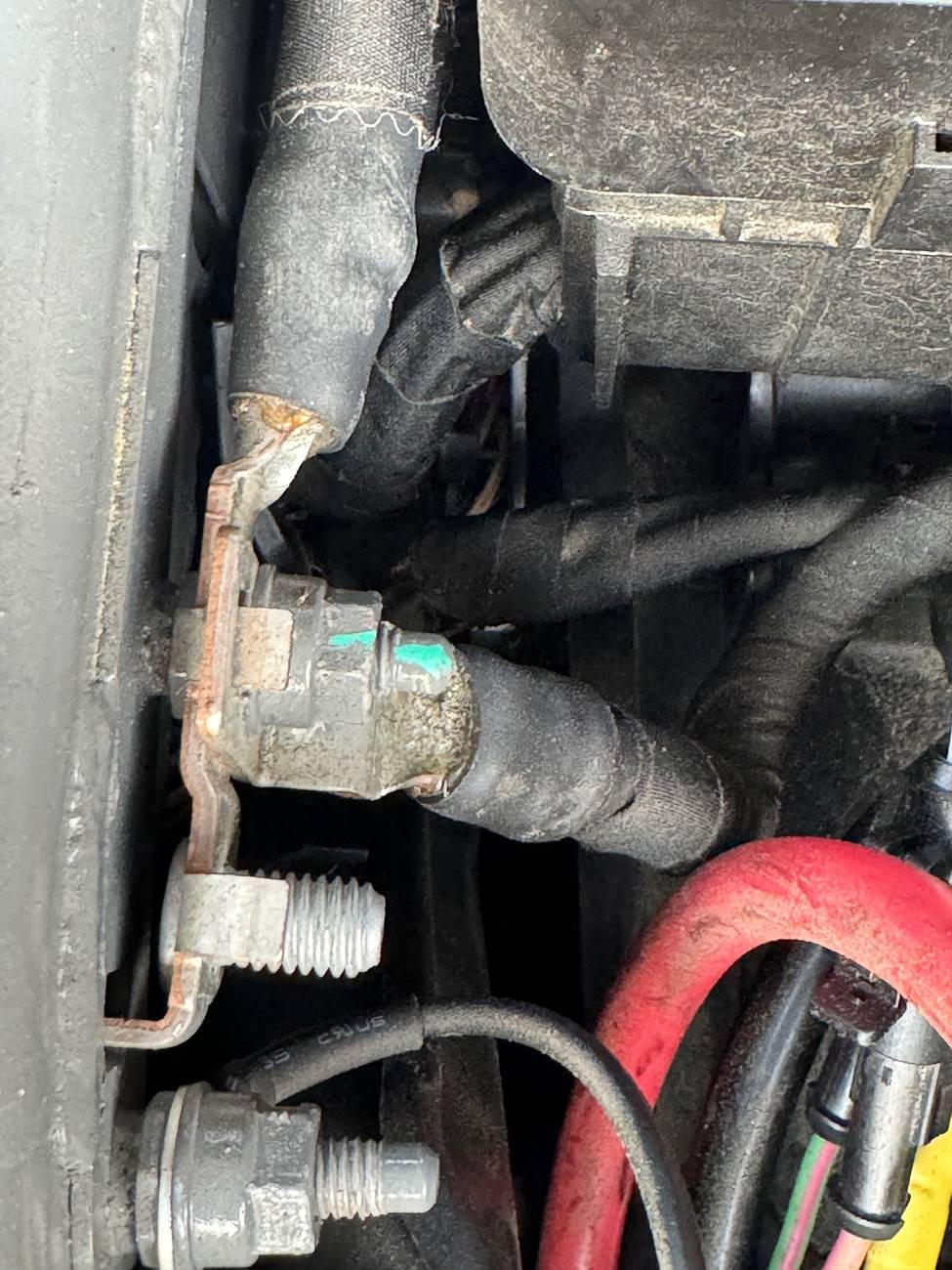

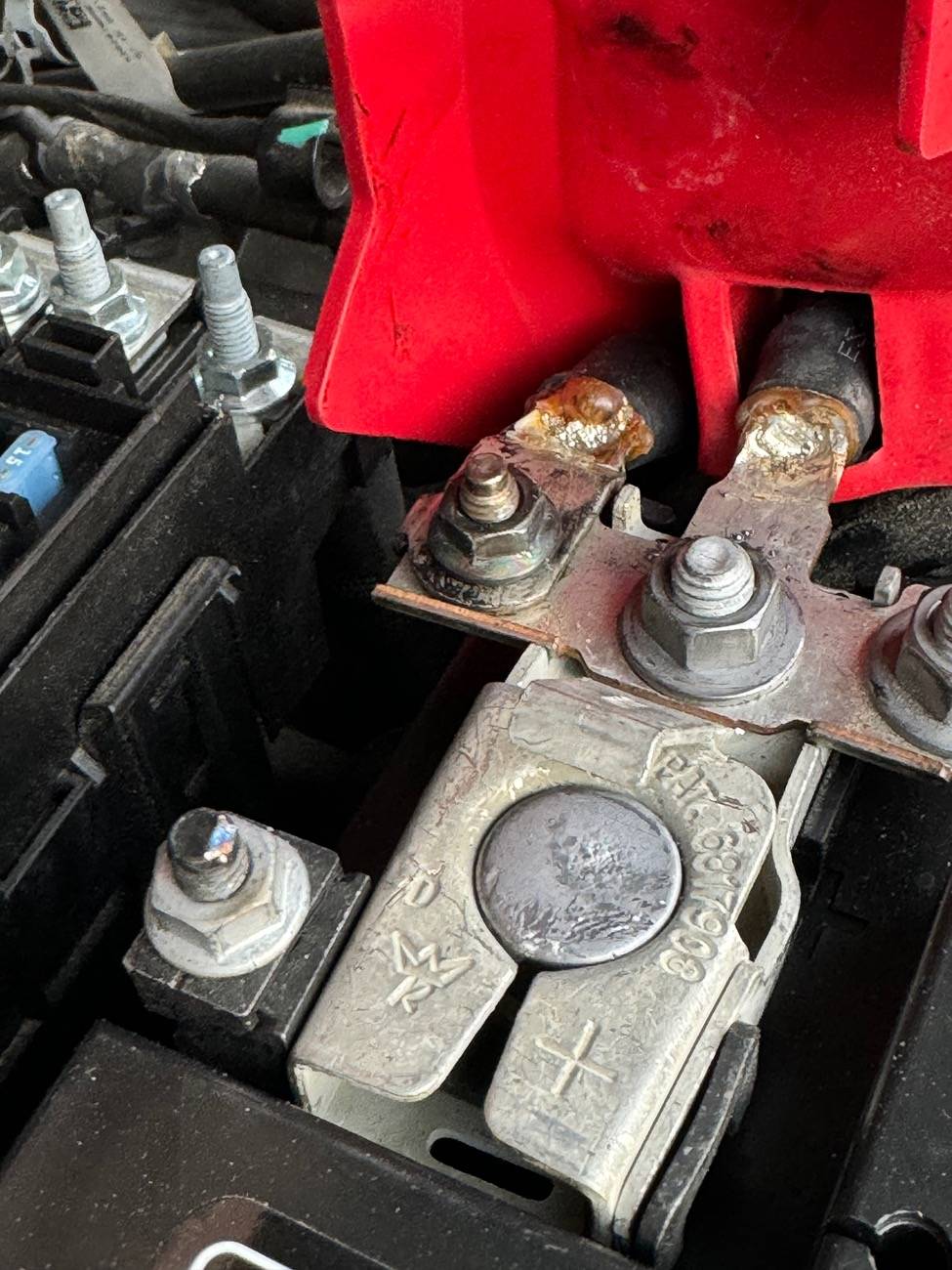

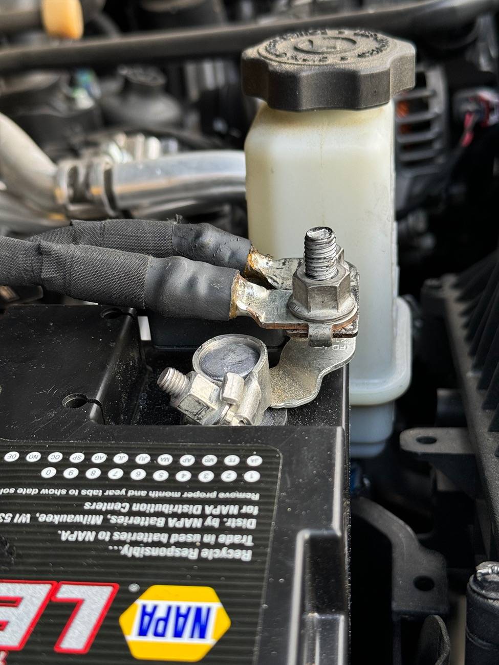

So super frustrated right now with this process. I started getting more and more frequent aux switch unavailable notifications. My conclusion was that one or both batteries must be on their way out. I don’t use ESS so decided to do the aux delete by isolating both the positive and negative leads.
I have a 2022 Mojave with tow, cold weather, aux switches, etc. I went to NAPA and got a 94R H7 and went home to swap it out. Following the prior instructions I pulled the fuse, disconnected the negative and then positive wire cluster from each. I also removed the IBS completely and set it aside.
I tried to determine which of the leads went to the aux battery by using the multimeter. There was 12.4 volts on the combination of the negative lead with the post and the positive without. I was also able to confirm, or so I think, that the main ground wire was correct by checking resistance between the lead by the negative battery terminal and the ground cluster on the fender wall.
Having identified what I believed was the positive and negative for the aux battery I wrapped them in electrical tape and connected the main back up.
Nothing. Not even enough juice to turn on an interior light. Main is brand new and is showing 14.5 v across the poles.
I could not get anything to do anything.
I tried to swap the ground from the one I believe was for the main to the one for the aux. Nothing. Eventually I gave up and hooked the wires back up as before. Voila. Power.
Now the backup camera doesn’t want to work, even when using the screen to try to activate it. Also while the headlights are working just fine, the dash indicator is not coming on to show headlight activation. Marker light icon appears as well as high beams …
I’m attaching ‘after’ pictures of the electrical after connecting everything back up the way I found it, minus the old battery.
I’m pretty confident that it is operator error but would appreciate someone pointing me in the direction of the obvious
Check the high current fuse array on the side of the fuse box. It's common to blow one of those if there are any shorts during the process. The ends of the battery cables need to be kept isolated.
The other issues should sort out within a day. The head unit can take up to 24 hours to fully recover from the power loss.
If I’d blown one would I be able to start and drive like normal once the aux was put back into the mix? I was super careful to try to avoid blowing one of those.
The head unit is working on it I think. The backup camera still isn’t working when put in reverse but at least I can force it manually now through the head unit pages.
