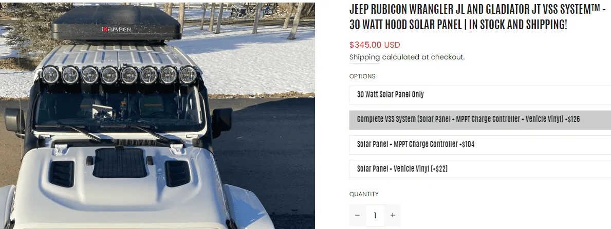

I've looked at the Cascadia several times. I'm not yet ready to spend the $650 for it. If you don't drive it regularly, and park in an area that gets adequate sunlight, it is a good solution to offset the drain of the always on computers and head unit.
I recently added one of the new Ring Dash Cams. If I'm not driving every day, it shuts down after about 36 hours to prevent battery drain. Adding the solar panel should extend the shutdown time.
I've got the 30-watt one and I love it. It's only $345. I drive mine every day and Texas gets lots of sunshine
