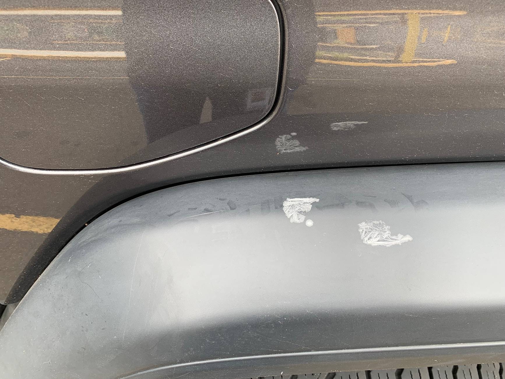

I bought two boxes of Blue DEF at Costco last night, and put one of them in my Gladiator. The spout leaked a couple of drops onto my fender.
This morning, I see that my fender is melted down to the fiberglass where the two drips were.
Has anyone else had this happen? I am going to call Peak and see what they have to say.
I did notice a slight odor that I didn’t remember from previous batches, but didn’t think much of that. This seems like a bad thing- not too happy about it for sure.

DEF needs to be wiped off of painted surfaces as soon as the spill happens.
On the big trucks we build if the DEF access has a painted surface around it we tend to include a rubber flap to help divert the DEF away from the paint when the door is open or include a brushed stainless panel over the nearby paint - cause it will ruin just about anything it touches if you leave it long enough.

Thanks for the comment, as that is exactly what it was and it washed right off. Thinking about it a bit more, the fenders are plastic, not fiberglass, so they are basically made from the same material that the tank is made of.
When I filled it, I smelled an odor that I had not noticed before, so I had that in the back of my mind. Probably just my B.O.
thanks again,
Brian
