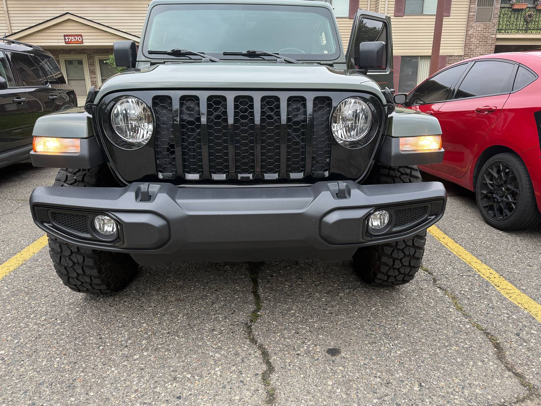

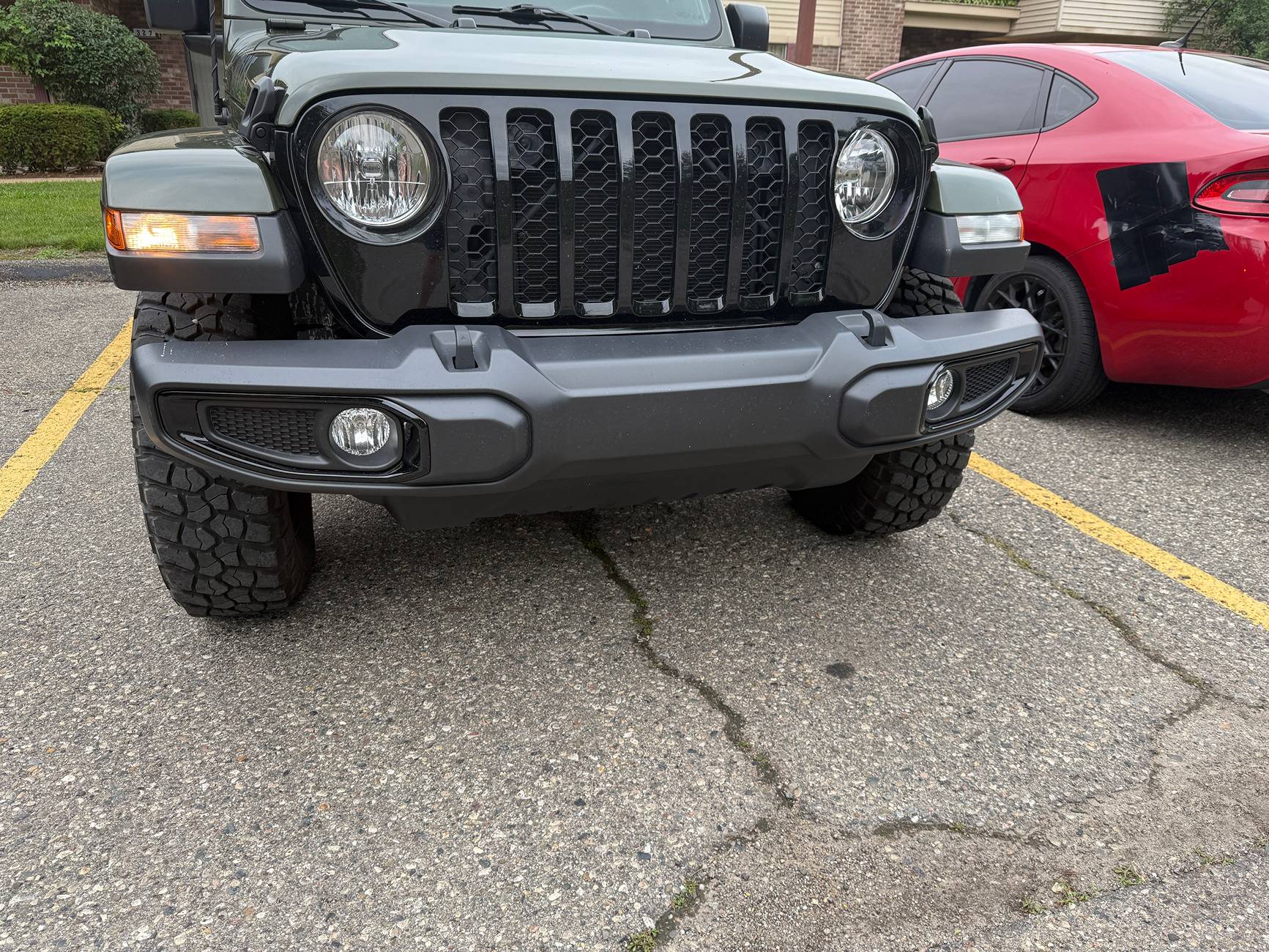

Noticed this Saturday, picture with driver side light not on when I am remote start or lock/unlock Gladiator it doesn't light up. But if I start the engine and am "running" it appears to work?

Does the left front turn signal flash?

Let me go check.

confirmed Driver (front left) blinker works, and DRL light works - but again when remote started the driver side DRL light doesn't illuminate like as in photo in OP.

Mallcrawl, I guess Im confused - All I noticed is when I had the JT remoted started the other day, taillights were illuminated and passenger DRL was illuminated but the driver DRL was not. I was like how is the bulb already out at 20k miles - So I started the JT normally to go drive to get a bulb and I noticed the DLR both sides are on - repeated this process a few times to test theory and confirmed that the driver DRL doesnt illiuminate when remote start. Is this by design or should I be taking this to a dealer I guess is my question?

That is going to be some type of software control of the BCM. Whether it is a setting or a software glitch, could not tell you.

I figured this, because there are indeed only 2 lights bulbs in the OEM fenders right? One for Blinker and one for DRL?

Not counting the side marker LED assembly, there is only two incandescent bulbs. One for the DRL and one which is a dual filament which is for the park and turn signal.

I have factory LEDs and mine does the same thing.
