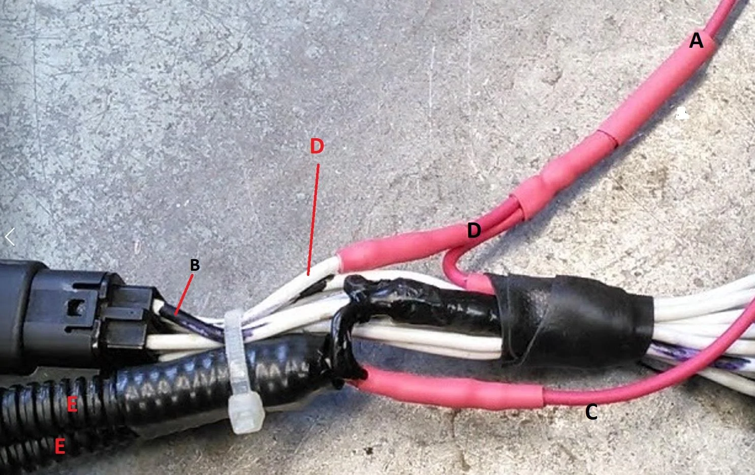

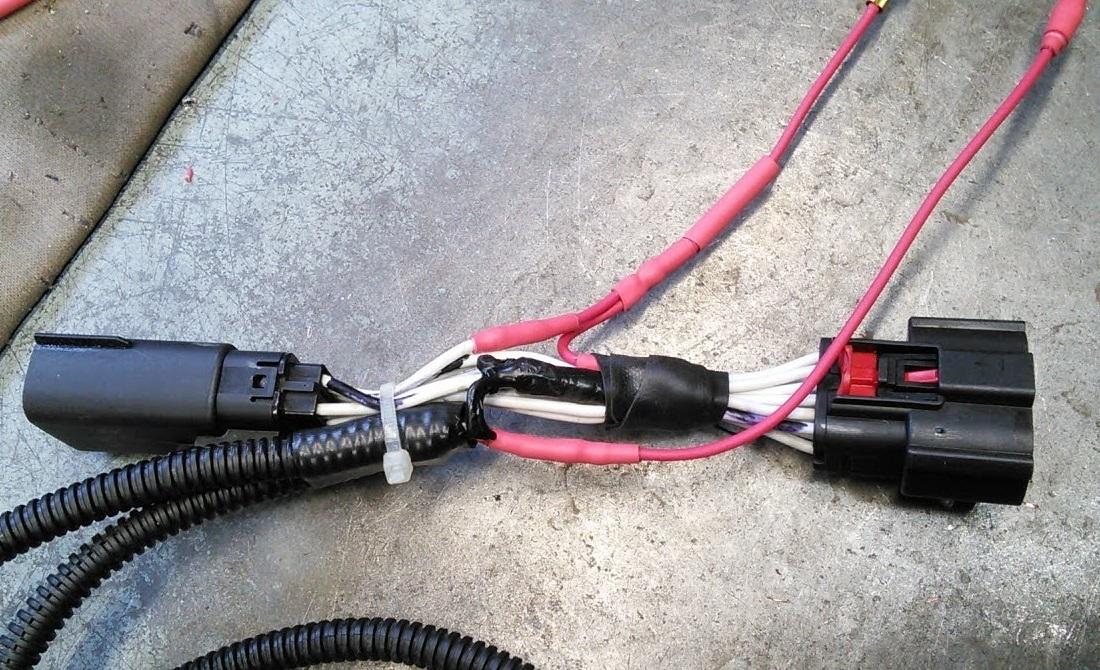

On my 2020 Gladiator I had tapped into the Reverse Light power to feed a set of bumper lights that drew at most 1 amp, it tripped a a pending fault in the BCM that never would post and was hidden to me had I not scanned it. That told me the BCM was sensitive to additional loading and probably would have fired the driver circuit for my reverse lights had I gone much higher than the additional 1 amp draw.

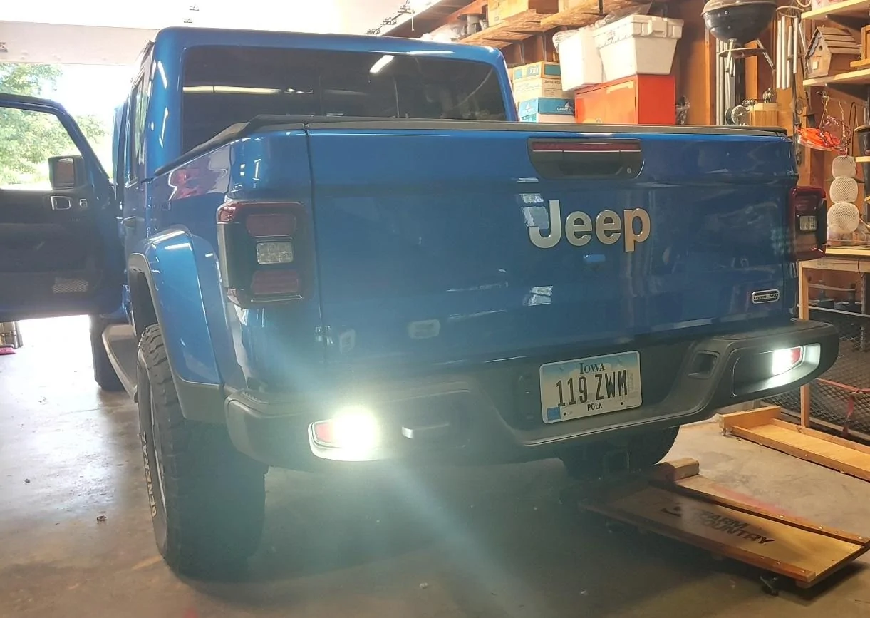

Can I wire the bumper mounted reverse lights to this circuit? I love the idea of these, but not being able to turn them on manually is my only gripe (first world problems, I know). It seems like being able to turn them on, on-demand, would be great. So, would this work? If not, please help me understand what I am missing?
Do what I did............. My truck is not running, button not in ACC or RUN mode, it's sitting in park in this pic below ->
Jeep Gladiator Why can’t I…Understanding the bed light circuit 20220728_153407_HDR
I wired an AUX switch to run these lights if I want them on and the truck not running.
They STILL work when running and in reverse thanks to a diode.
If you have aux switches, it helps, but it can be done even without them with just a little bit more effort.

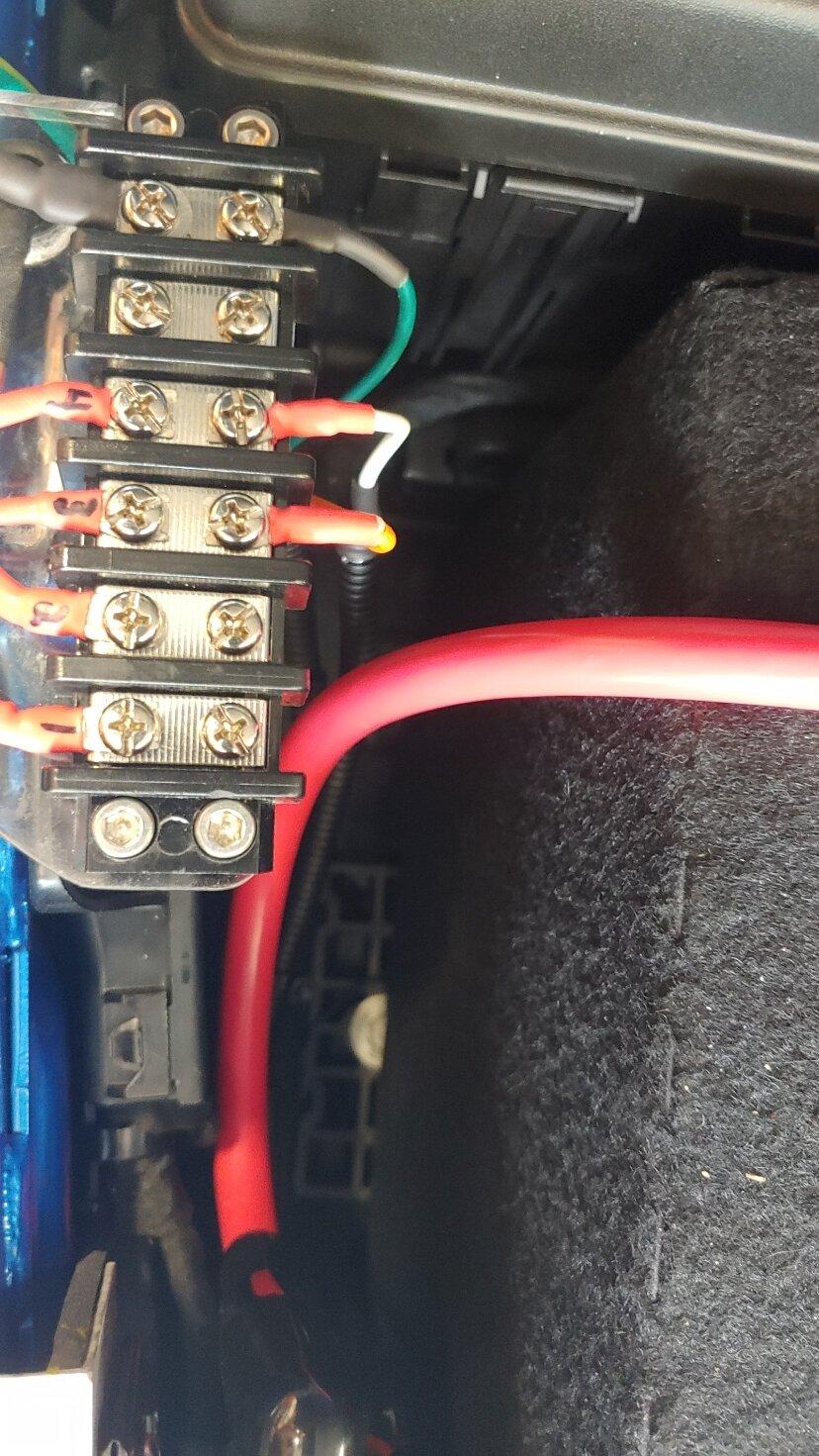

I myself am wired differently - my thinking and reasoning relies far more on perceptual reasoning than typical. Troubleshooting comes natural to me so it's often hard to explain. I found that if you know the basics, for example, engines - if you know how something works, why it works, then you can build on that. I've been asked "how did you learn to work on motorcycles". Uh, can't say, really, I just worked on them. They are just the same basics built in different ways. Same for the antique engines I have - some from 1912.......... The boss always gave me the unusual to work in knowing I'd figure it out. So I got the industrial equipment, boom trucks, tractors, trenchers, whatever.

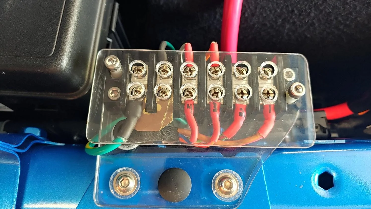

I would absolutely use a terminal block, or "bus bar" as some may refer to it.
I didn't want to pay $40 for one that I thought looked a bit showy and in your face and was much more large and blocky than needed. I wanted a clean look, so made my own.
It has a slot for each of the 4 aux switch wires, and two places for grounds. I ran the green wire (12 gauge, lower left in picture) to the ground terminal or stud on the fender below my block and used a brass jumper I made so I can use two of the terminals for grounds if needed.
#3 here goes to my winch cutoff solenoid (so I have no power to the front bumper if not using the winch) and #4 goes back to power the in-bumper LED oracle backup lights.
I put a polycarbonate cover on mine to keep me from getting clumsy and hitting wires or dropping something and shorting things out. I get that way with severe ADHD.......... so I have to protect things against me.
This is so convenient - really easy now to connect to the aux switches, change or move things around.......

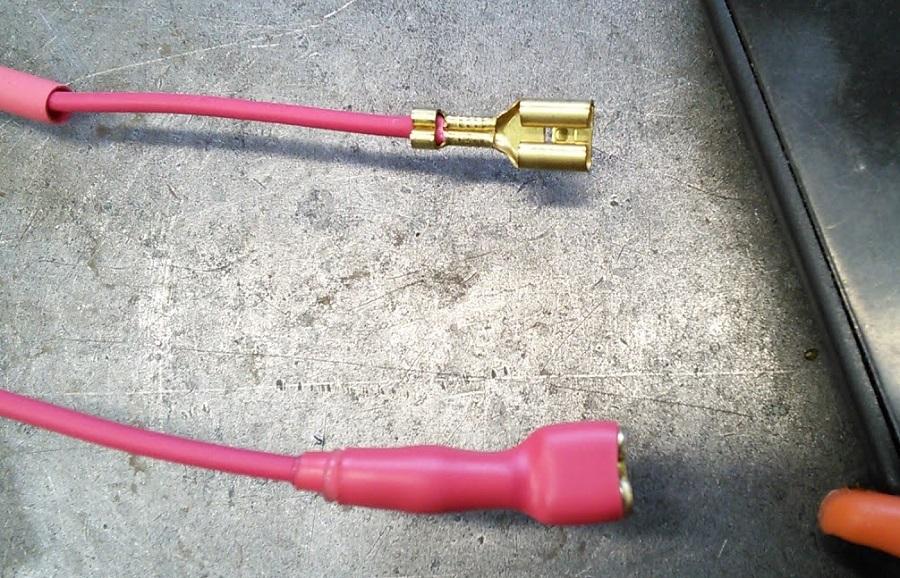

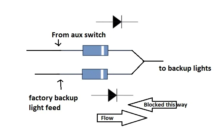

I was going to use diodes I have on hand, but opted for a "neater" commercial diode that did this same thing -
Jeep Gladiator Why can’t I…Understanding the bed light circuit diodes

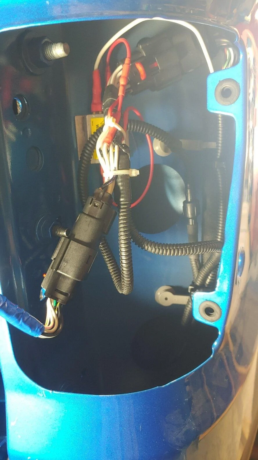

I used an Oracle plug and play harness for their lights with a couple of mods to connect to the diode.
Jeep Gladiator Why can’t I…Understanding the bed light circuit IMG_20220724_115758
Jeep Gladiator Why can’t I…Understanding the bed light circuit IMG_20220724_115748
I have a hand drawn wiring diagram of exactly this setup! I would imagine you bought the Oracle Wiring Harness separate from the backup lights? I believe the harness that comes with the lights makes the lights have the black twist on plugs (at least that is what their website shows).
I am contemplating how I want to setup my electrical. I have been reading a lot about bed outlets, I did not order mine with one because I ultimately did not want to draw bed power from the same power inverter as the inside plug. It would be nice to have a separate inverter wired for this outlet all together. Unless I am crazy, I feel like you could wire a second inverter for the bed outlet to one of the 40A switches and have two plugs capable of pushing 400 watts. Its on my list of things to research, but I do not see a lot of value in trying to power a 12V plug to the bed.
For lights, I just need to figure out if I NEED 40A to power everything. I was thinking of running a terminal block to one of the Aux switches, and then running each light directly to the terminal block. I do not plan on getting ridiculous with lights, I am thinking four cube lights on the front, perhaps some on a rack in the future, and maybe a few extra rock lights here or there. I do not think that would require a 40A switch, but I also don't want to be squeezing everything onto a 15A.
Perhaps:
(1) 15A Aux Switch - Wheel well/underbody rock lights and reverse lights
(1) 15A Aux Switch - "Accessory" lighting for future rack build out.
(1) 40A Aux Switch - Any larger off-road cube or other lighting I decide is necessary in the future.
(1) 40A Aux Switch - Bedside Power Inverter and solenoid for winch power. - I figure I could put the solenoid anywhere, and maybe it would make more sense being on a switch with lights. You know, so when I am winching myself or someone else, people will have to try really hard to NOT see me.
So many thoughts, so many projects to think through!
15 amps will handle a winch cutoff solenoid. These are very much like the remote starter contacter/solenoid used by Ford for years and those draw under 5 amps, some say as low as 2.5, some say as high as 5 amps. I have several laying around and it would be pretty easy to measure the draw one of these days - but I have mine on a 15 amp aux. The wire supplied with the Warn winch solenoid can't be more than 18 gauge so that alone says - low amp draw. The neat thing about a solenoid is that it takes nothing to hold the core in place once it's drawn in.
I have the Oracle bumper mount backup lights and the Oracle plug and play inline harness to feed the lights through the truck's wiring. I hate hacking the factory wiring on a new vehicle, for that matter, I don't like tapping into the factory sealed wires in most cases. And when I do - it's got to be sealed up again. I've wired and re-wired so many vehicles over the years, some completely, some partially, and there's just no way after what I've seen. Once that seal is broken, stuff happens. I've seen oxidation on copper wire migrate several inches into the length of the wire - away from the compromised insulation or broken seal. I hate green copper unless it's patina on art or a building.
A goes to one of the diode "in" terminals. I used open barrel wire terminals and crimped onto this wire end and used sealing heat shrink.
B is the ground - the Oracle harness leads to the lights gets ground here. I didn't make any changes to that part.
C is the hot or + feed for the oracle lights - it goes to the out side of the diodes. That is connected to the red wires in the Oracle pigtails to the lights.
D is where I cut the Oracle plug and play harness to add a wire going to A. It seemed easier to me to be able to seal it doing it this way.
E is the two harness pigtails going to the lights
The aux switch feeds the other "in" diode. It's running from my terminal block #4 position, through the frame, back to the diode mounted in the tail light cavity.
