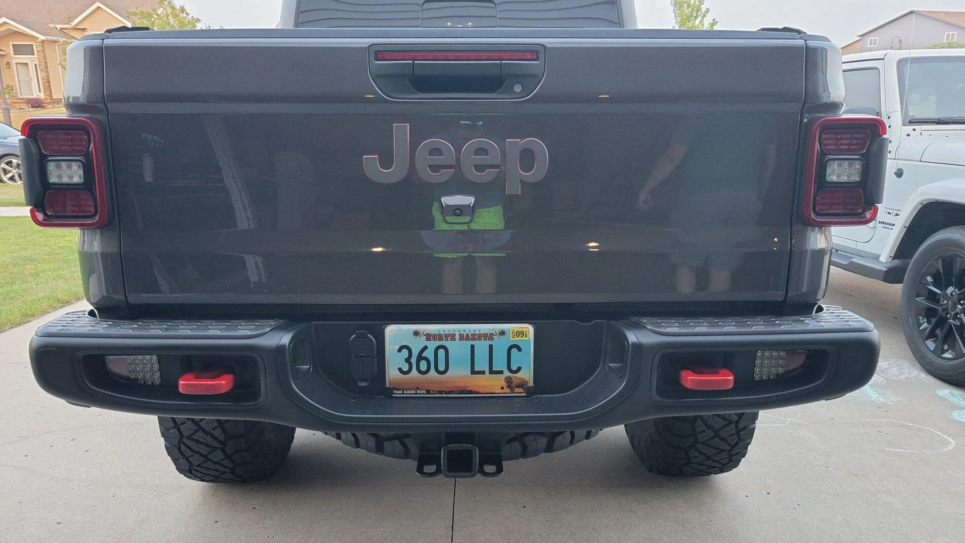

I have factory Tow and LED.
I installed the lights, then used the harness using the Passenger Taillight.
The Driver Side Oracle reverse light did not work.
I unplugged the driver side LED Oracle, turned the plugin 180 degrees and forced it to connect. This worked for me, and they work as intended now.
Was a simple fix for me..

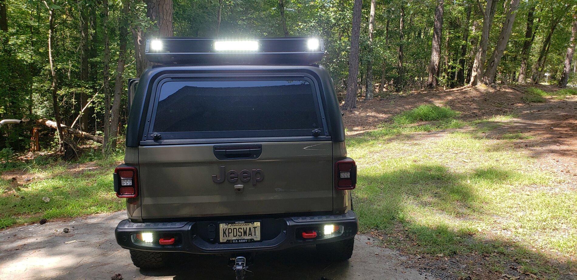

Looks like I'm the only one who did their own wiring. Mine came out perfect. I have rear lighting without putting it in reverse or even run.

Its hooked to aux 4 button and i selected battery hot in settings. Just reach in and hit the button.
My bad. I didn’t see anything about the aux wiring. LOL. Nice work.

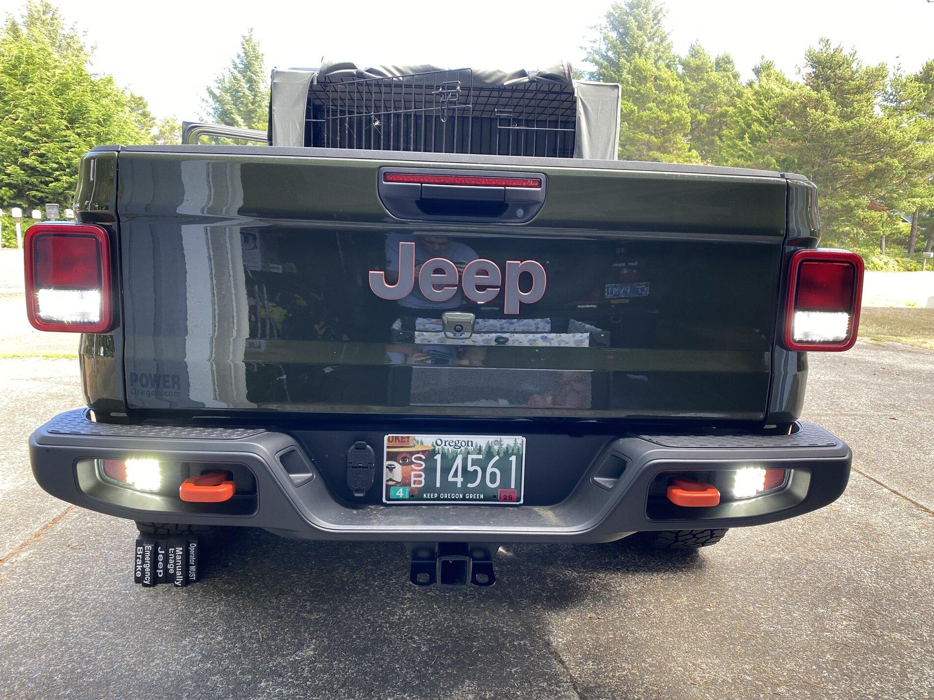

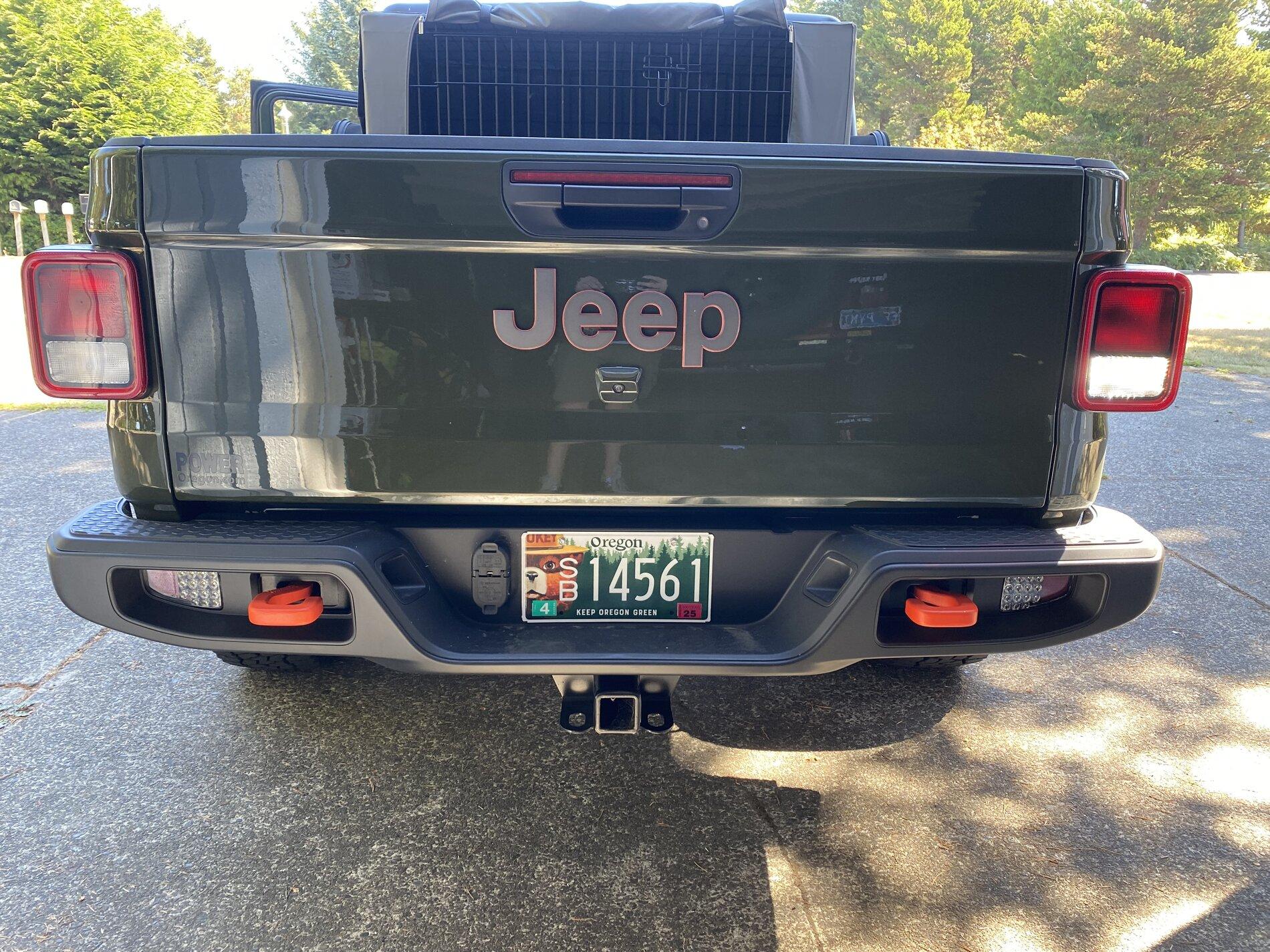

SO after calling Oracle it was recommended to swap the halogen bulbs to LED, as they believed the added lights were drawing too much power.
Swapped the Halogens out for LED bulbs and got the same result. Called Oracle again and spoke with a rep. Rep advised taking the harness out and using T-taps into the respective lights to see if the harness was the issue, or if there was an issue with the lights drawing too much power. I wasn’t going to tap into the wiring, as that was the whole purpose of PAYING for the plug and play harness. Rep suggested calling back when they had a tech available to talk too, as they have been effected by the crazy weather back east.
I got to thinking and decided to at least test the “drawing too much power” theory by unplugging the passenger side aux light. Both factory bulbs and the driver side aux light worked.
I plugged the passenger side aux light back in to the harness, and all lights worked as they should??? I cycled things through gears as well as turning the Jeep on and off multiple times and everything works as it should. Idk what caused it to work, but I’m happy it did.
