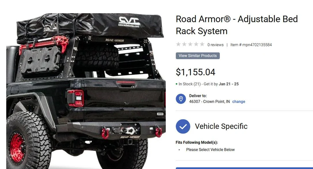

Do you know of a preference for a rack overhead? I attached a rack and was thinking perhaps I could skip the bed cover and do this rack and hang the tire and lock it but it might block the back window too. What do you think of the photo?

I don't think Jeep is making a completely different bed for the diesel. I have not heard about the top not fitting. Sounds more like one of Jeeps deals where they block out certain things depending on the build, or require them. You could always have the dealer order it through parts as part of the deal. I have the Undercover flex hard cover and like it a lot but I don't know if I would stand on it. The only one that you might be able to is the diamond back cover but that is a whole different animal. Much more bulky and heavy.
A good number of 37 inch tires will fit in the factory spare location. Some just need a little adjusting or maybe lower air pressure. I think there was a thread here of which ones fit. Yes, if you hang it from a rack you won't see out the back window.
I will let others with more experience answer about racks but I will say there is maybe one option out there for a rack with a hard tonneau.
