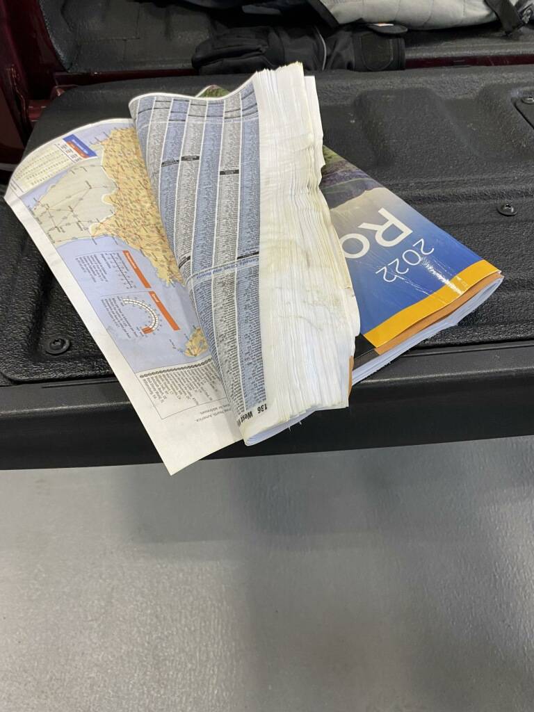

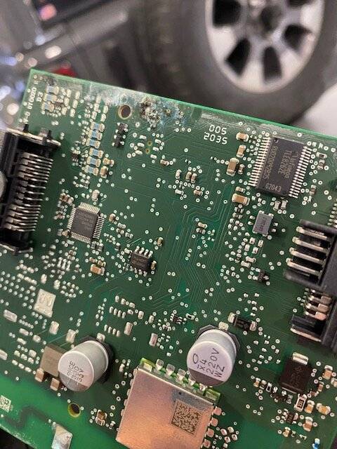

Jeez. They found a soaked map that shorted the RF hub per the service manager.
Not sure how it got wet. Leaking back window would be my best guess as I never have any liquids back there. I don’t know why all of the sudden though.
The RF hub is under the rear seat, driver side.

RF hub is on the back cabin wall drivers side behind the passenger seat back.
More than likely a rear window leak that got water into it.
Too bad I’m out of warranty. I’d probably have some ground to stand on for a warranty claim.
I’m glad they found the issue though. I was worried about ongoing electrical stuff (fingers crossed lol)
