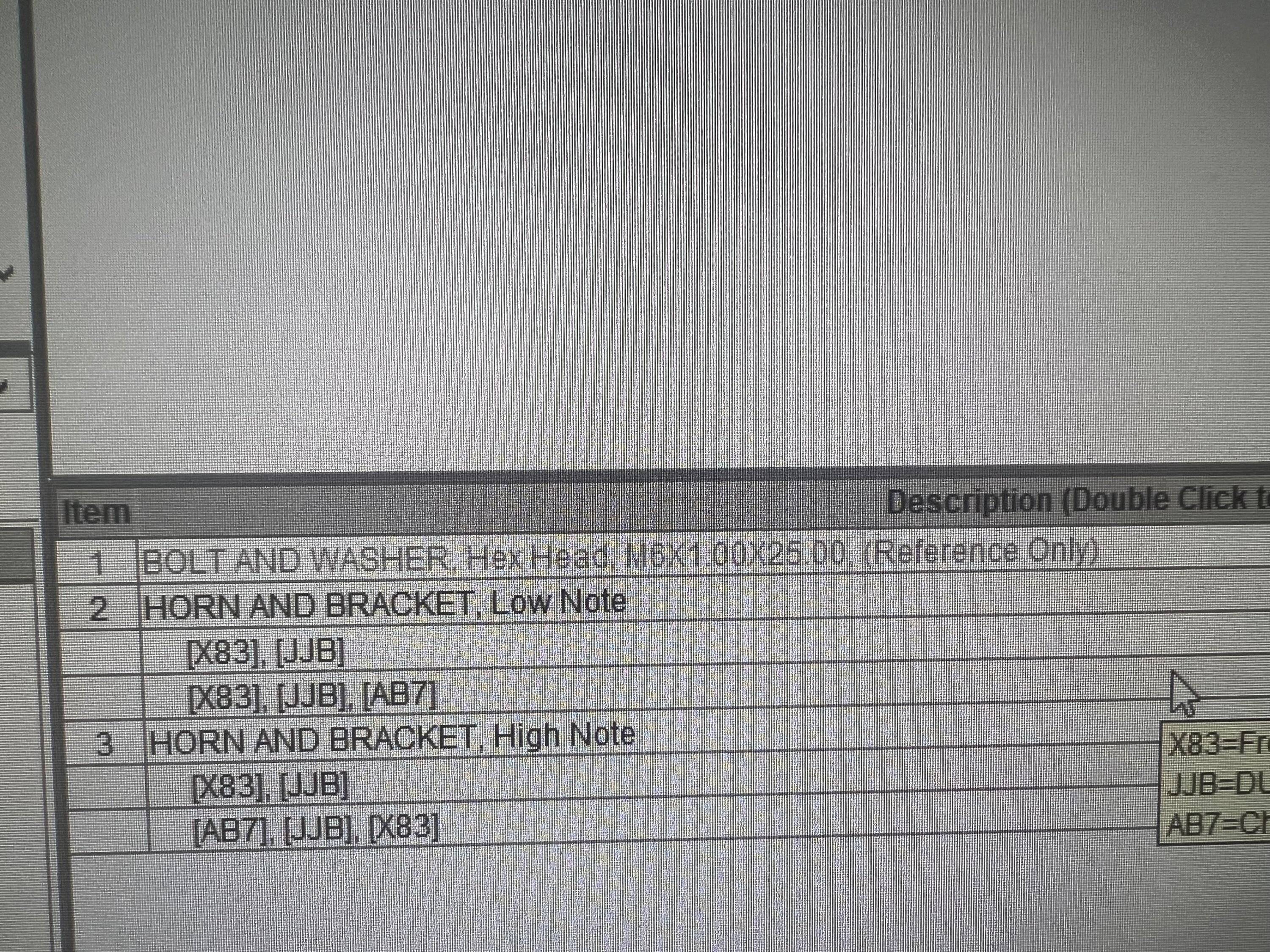

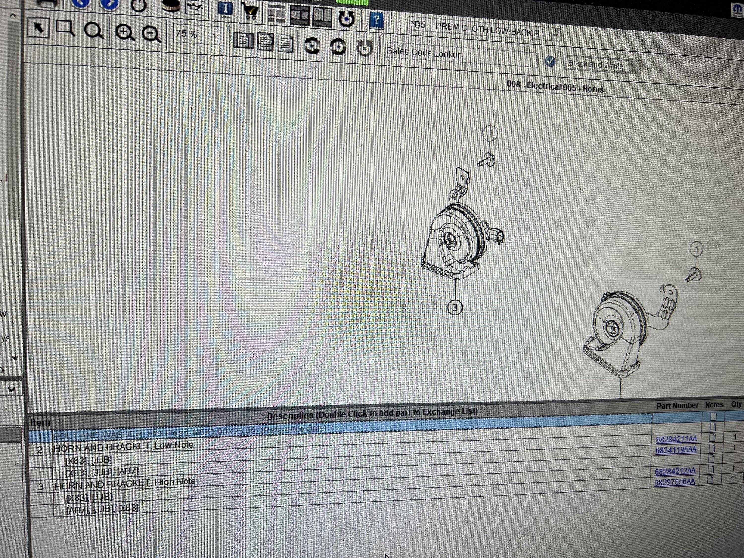

Hope this helps ??
Jeep Gladiator Help! What Bolt Is This?!?! IMG_6864

Unfortunately star parts lists them as reference only. IMO it means just generic M6x1.00x25.00 bolts hardware store would be my best bet sir.
Jeep Gladiator Help! What Bolt Is This?!?! IMG_6865
I don't think that the "Item 1" in your picture which is a M6 bolt that holds the horn in place is the bolt we're discussing in this thread.

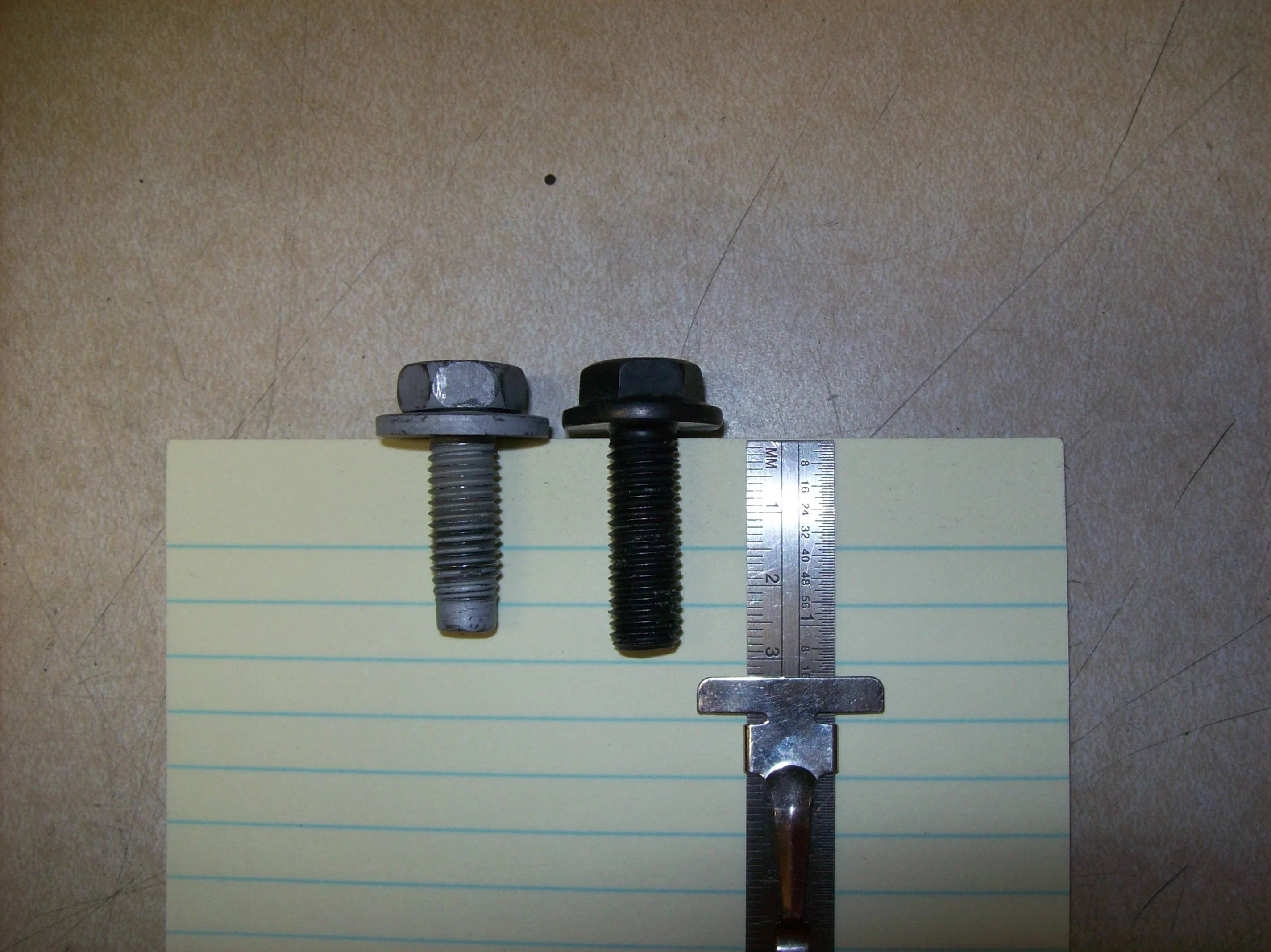

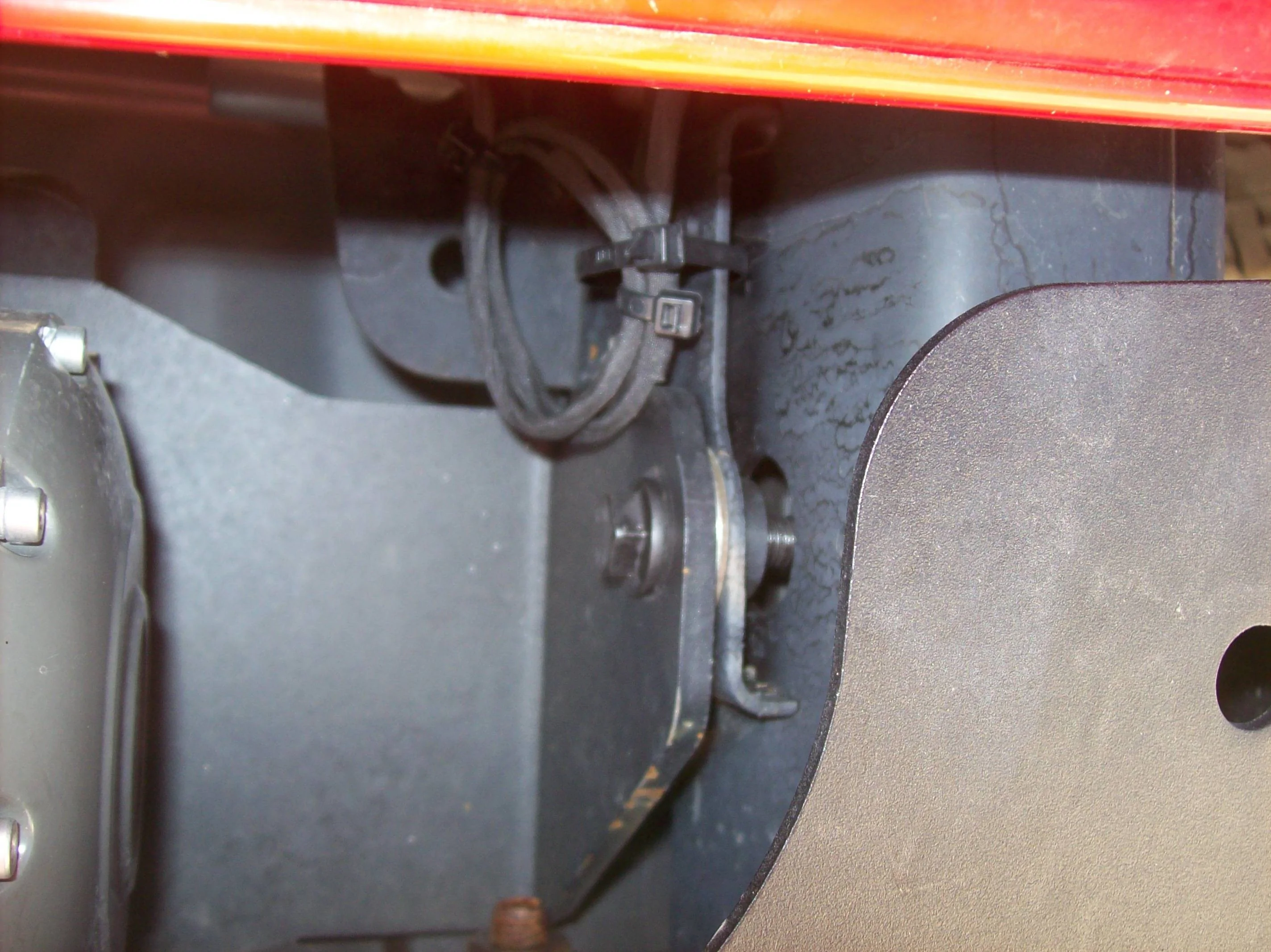

Here are the stock bolt, a flange head bolt M10x1.5x30 mm and a ruler. Second photo is the 30 mm long flange head bolt installed with the washer between the Arcus winch plate ear and the frame. There is a hole in the frame which allows a longer than necessary bolt to be used.
Jeep Gladiator Help! What Bolt Is This?!?! 101_2353
Jeep Gladiator Help! What Bolt Is This?!?! 101_2355
