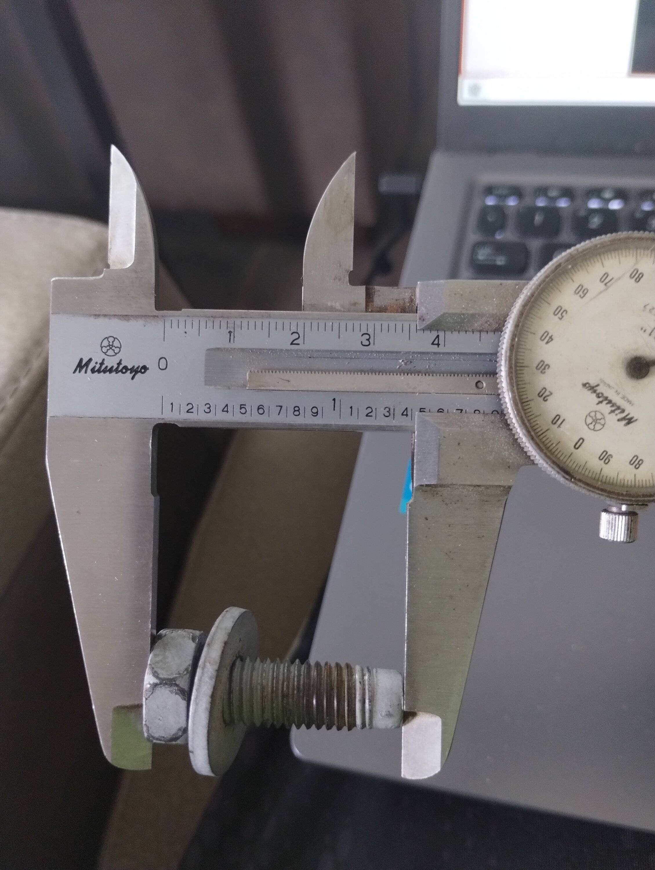

Hello,
I purchased my Gladiator with a Rugged Ridge XOR front bumper. I’m preparing to swap it out for a RR Arcus with a Warn winch. It looks like the previous owner removed the 16mm bolts to remove the Frame Horn brackets as they weren’t needed. Now I need two of the 4 16mm bolts. Dealer has been unable to confirm which they are.
Does anyone know a part number for these? Or know the bolt information to get replacements?

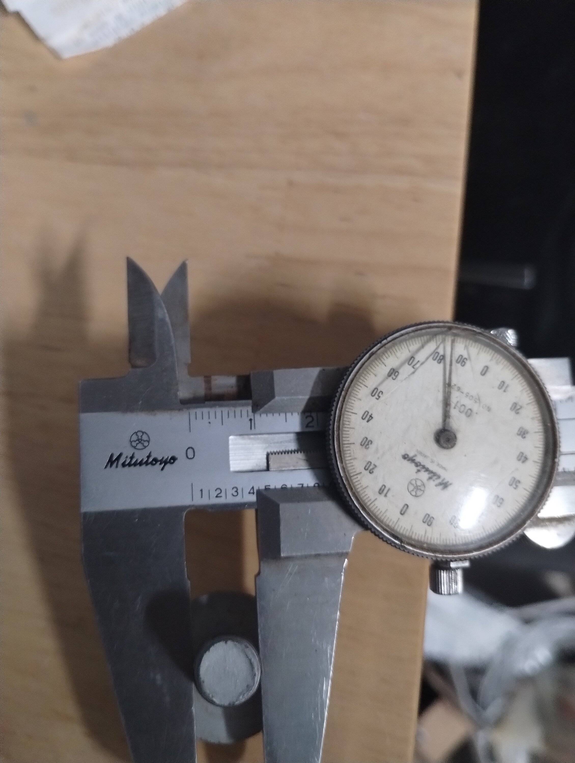

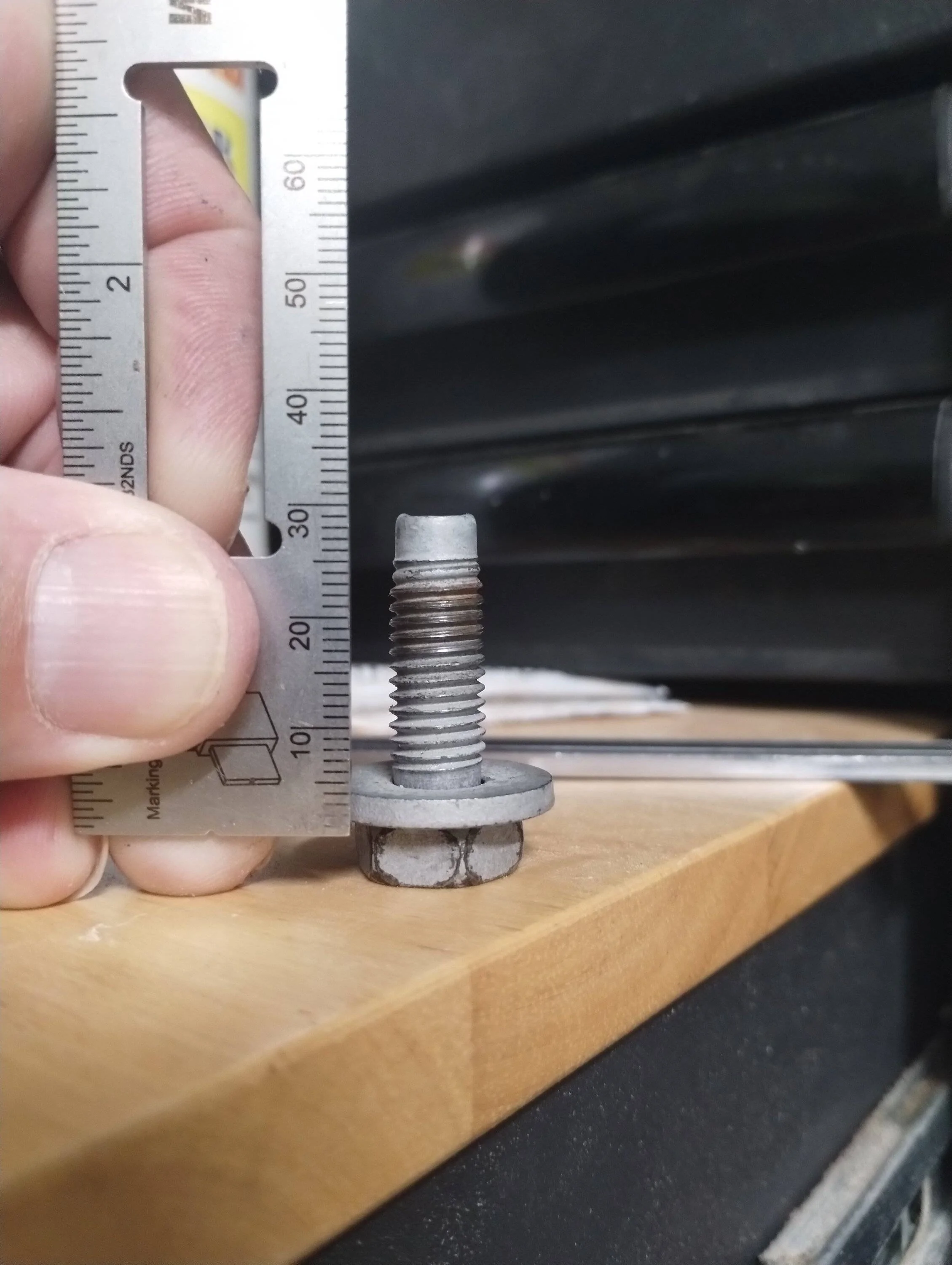

I'm not great with metric but it appears to be an 30mm long M10 bolt. Coarse thread I believe.
Jeep Gladiator Help! What Bolt Is This?!?! IMG_20231002_163046719
Jeep Gladiator Help! What Bolt Is This?!?! IMG_20231002_164954368
Jeep Gladiator Help! What Bolt Is This?!?! IMG_20231002_165012186

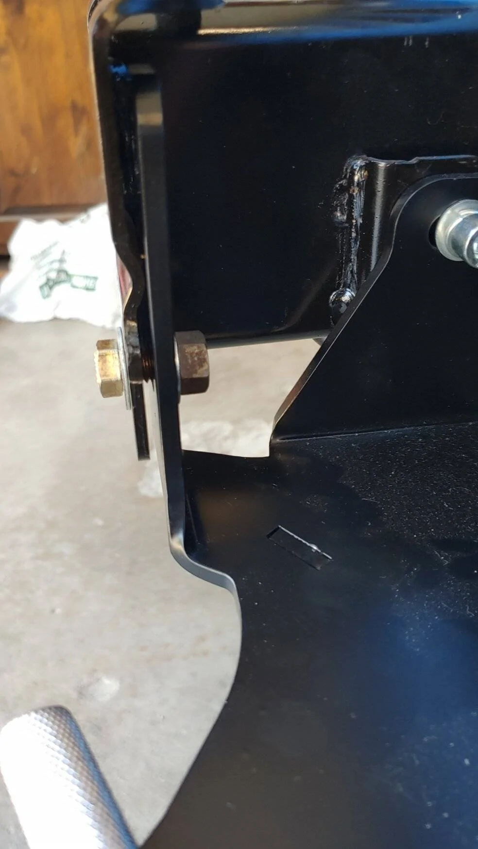

The stock bolts are grade 10.9 M10 x 1.5 thread, 25 mm long with a short lede on the end without threads. It has a captive washer. You will be fine with using a washer and a 25 mm long fully threaded bolt. The stock bolt has a 16 mm hex head (5/8" works). On my JT, I put a big washer between the Arcus winch plate and one side of the frame to take up the distance between the winch plate ears and the frame.

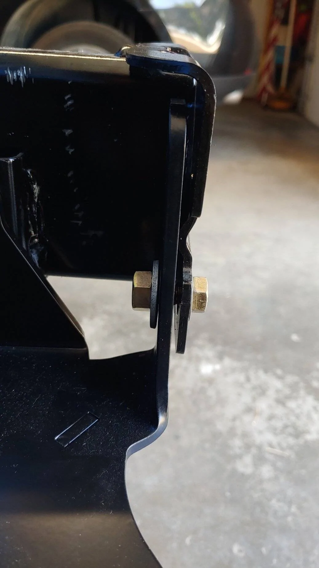

Here's a decent place for washers if so inclined if the winch plate sits behind the ears of the front ends of the frame horn - MAYBE this is what @whiteglad is referring to?
Jeep Gladiator Help! What Bolt Is This?!?! 20220823_125159

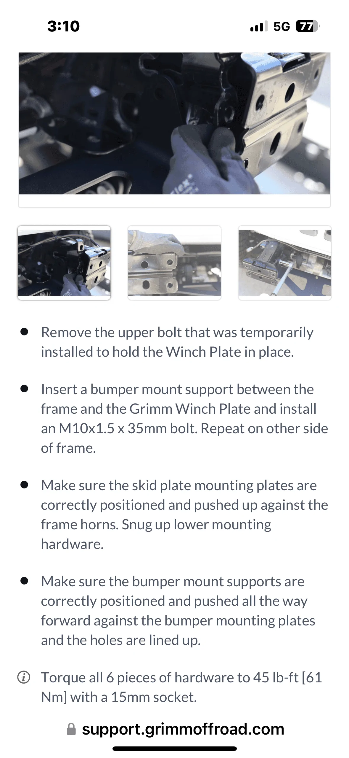

In the pic below, you can see where the instructions said to take out the original bolt and set it aside and use their bolts. Not sure why - either way would work but I actually read and followed instructions, I'm ashamed to admit. Almost a first.
Jeep Gladiator Help! What Bolt Is This?!?! 20220823_125248(1)
