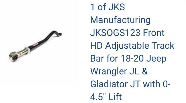

I’m still learning. I didn’t know that there were options. I purchased this one.
That is fine, but you will have to remove the bolt on the adjustable end to make any adjustments.
I have Synergy, they have a double threaded sleeve to make adjustments without removing, then a crush bolt and nut to lock in place.
That one you’ll have to unbolt the “Gold” end and spin it out or in to adjust the length. It’s a good track bar just have that extra step of unbolting one end.
