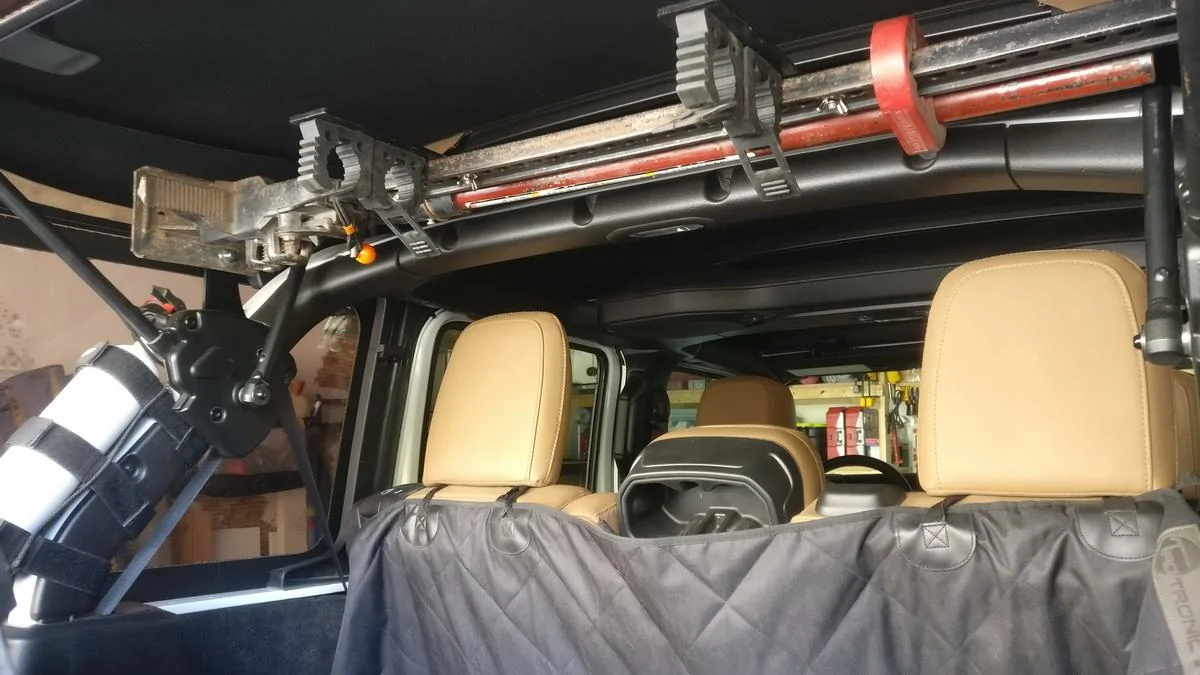

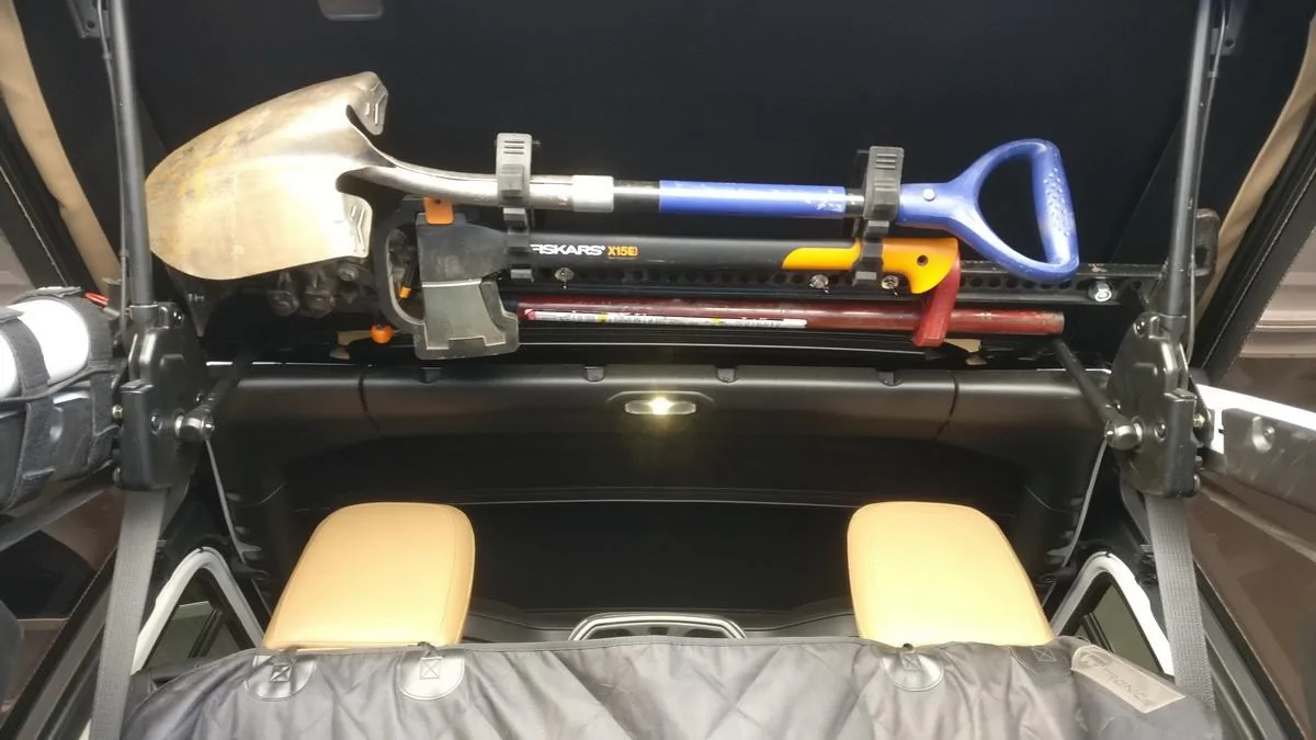

I've usually carried mine under the rear seats, then lashed to the seat brackets. It will fit well with the top hook removed or positioned at 90 degrees. I now have the Dominion Off-Road mount above the rear roll-bar and it works exceptionally well (I know, doesn't work for the Gladiators). I also have their accessory mounts to carry a shovel and axe. It is basically two "T" shaped bars that attach to the hi-lift and have Quick-Fist mounting points. Basic and it works. Recommended.

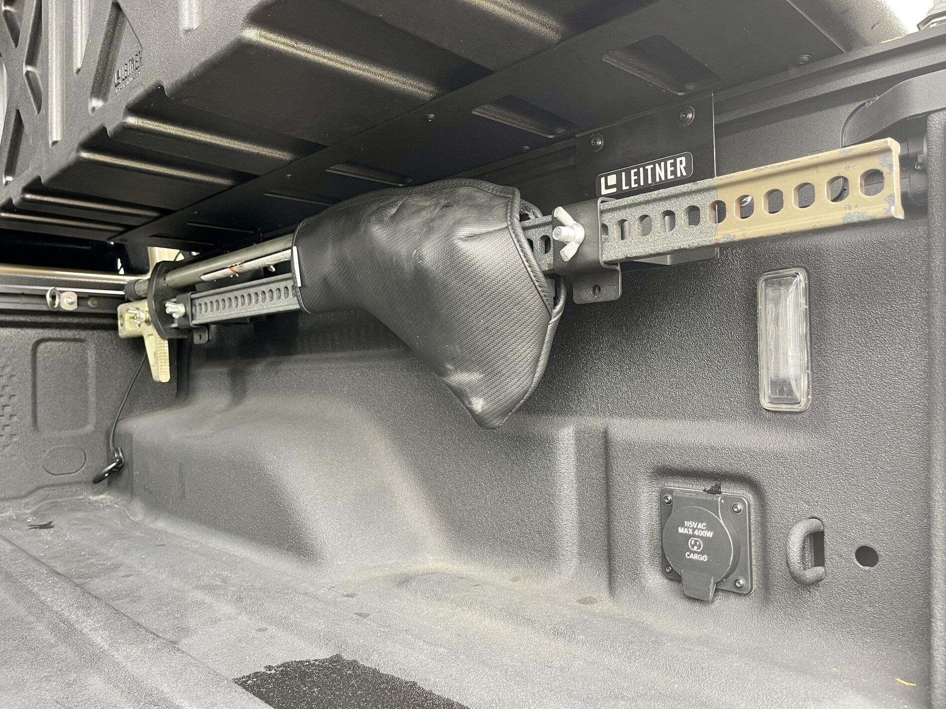

Here’s my home fab hybrid mount. Made two plates to lower the Leitner mounts just right. That’s a 60” HiLift Extreme. It just fits at the rail and is rock solid.

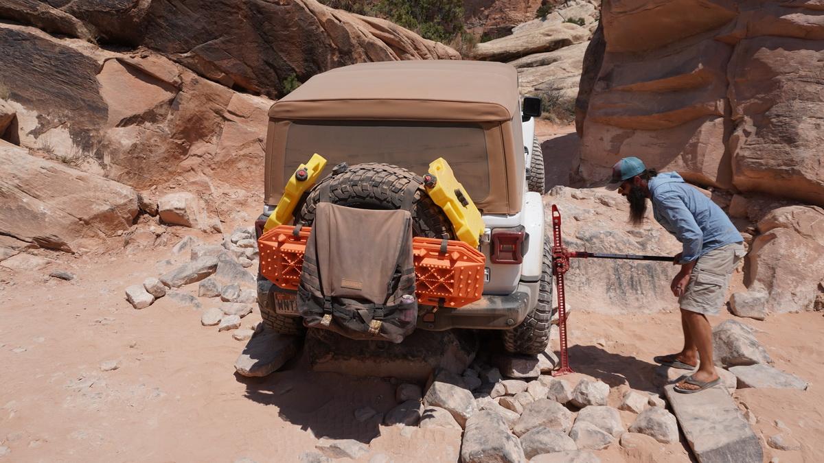

When my JT got turtled on a rock going UP was the only option as the rock was jammed in the cavity next to the rear driveshaft. I had to wait for over an hour until someone passed by with a Hi-Lift. Definitely my next Jeep purchase!

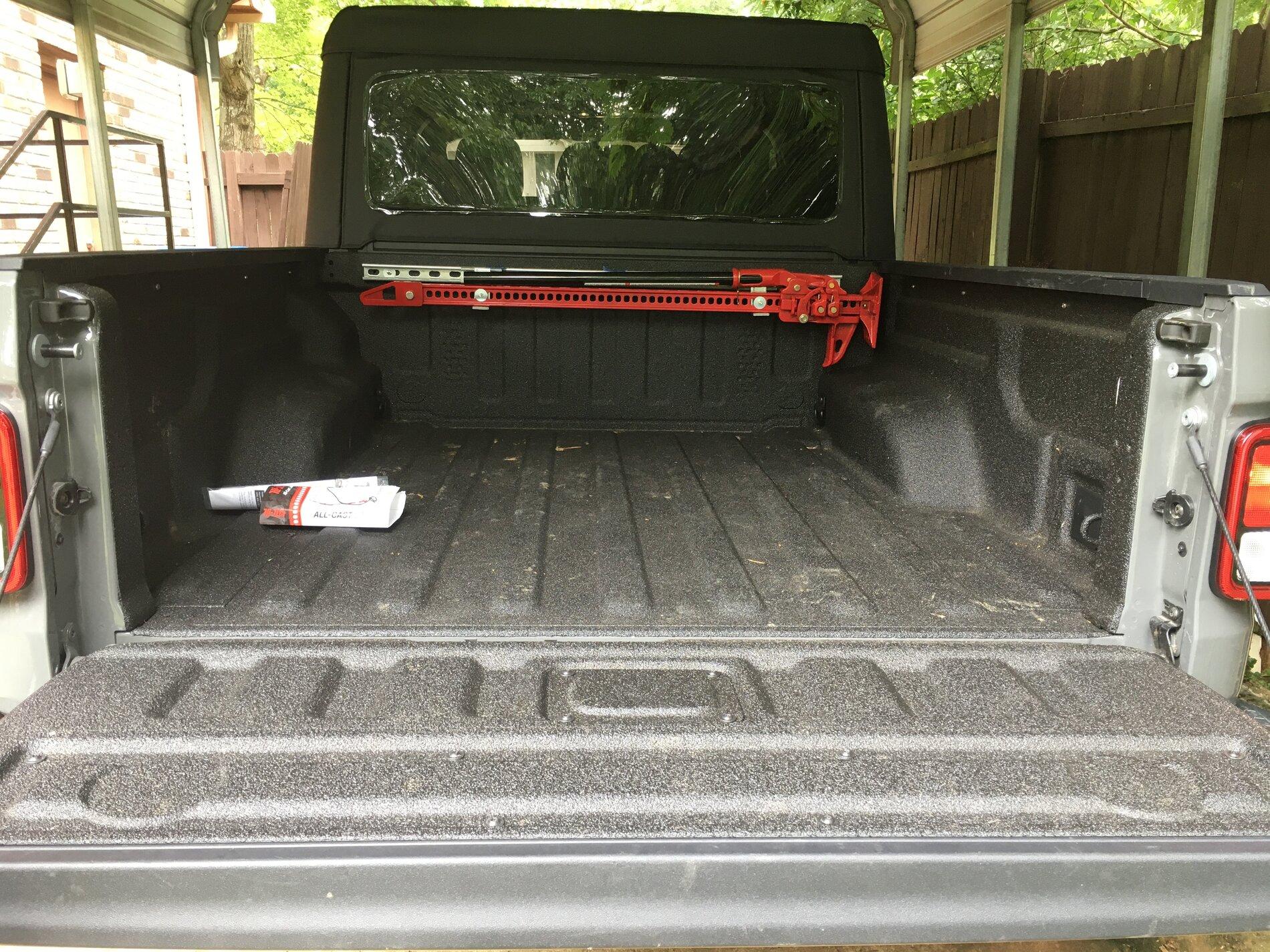

Got my Hi-Lift today. FYI Hi-Lift Gladiator bed mounts are on back order. I cut and test fit a strut mount.
Jeep Gladiator Hi Lift Mounts 63B5DEDD-5CE4-4C59-80CF-7C5CBFE41E04
Going to beef it up with some more bolts into the bed, spring nuts, and lock washers.

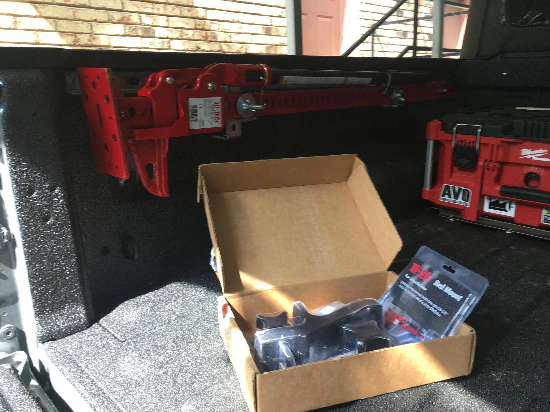

Spent 1/2 the day Friday working on this mount… and then UPS delivered the Hi-Lift mount. :headbang: Didn’t have time to switch things up before my trip, but it held up to a day of off-road!
I guess I’ll use the hardware to make a storage mount to keep it in the shed.

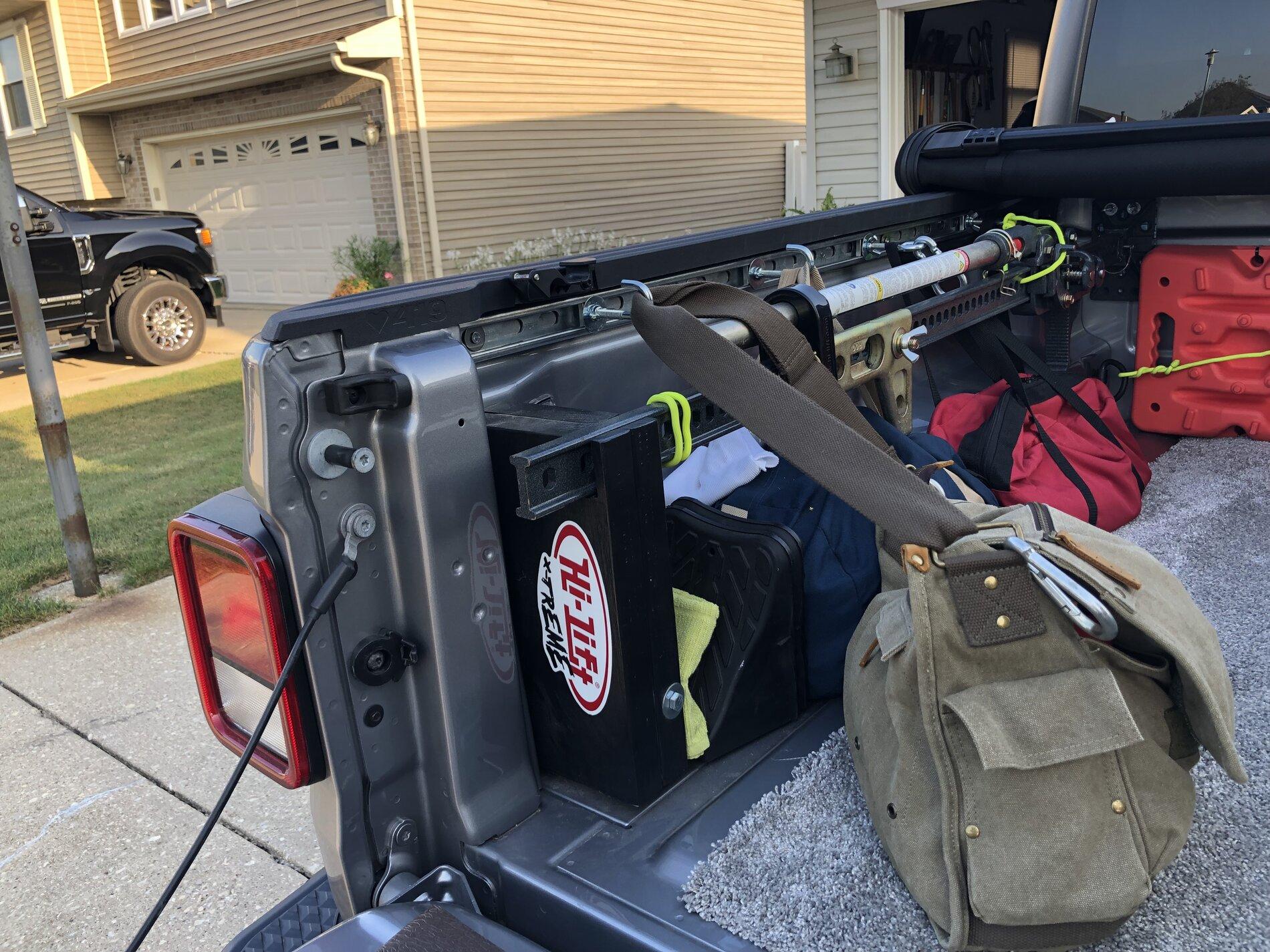

Hi, here’s my setup. I have the 60” Hi Lift Extreme. I used 2 existing threaded holes (6mm I think) at the front of the bed to mount the base. I joined 2 2x10 pine boards and mounted them using 50# mounting tape on the bottom and a long threaded bolt using an existing hole in the bedside to further secure it. This works great, doesn’t take up any useful space and takes about 60 seconds to retrieve or put away.
Jeep Gladiator Hi Lift Mounts 33CA3EE3-1B03-4F4A-A260-CDF833C8CE53
You might also notice I just put on my version of trail rails. Again, super easy using existing holes and low profile 2” channel with screws, washers and 50# mounting tape. Works very well. Less than $100 and a bunch of trips to hardware store and you’re all set.
