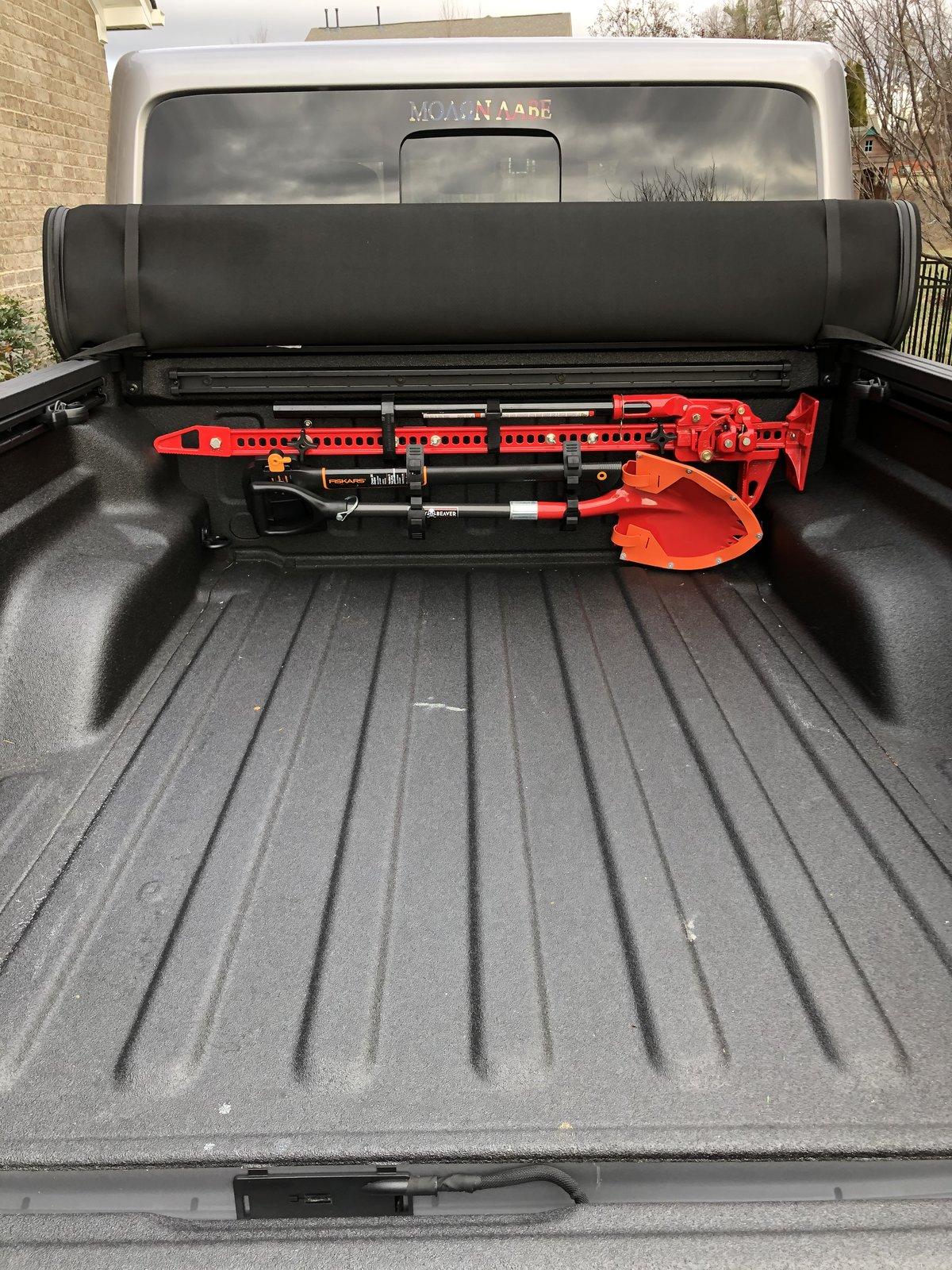

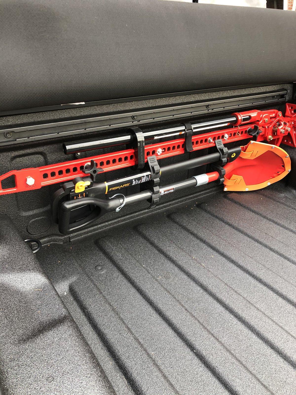

Mounted Hi-lift Jack, Fiskar Axe and Krazy Beaver Shovel to bed with EAG hood jack mount and Dominion Off Road axe and shovel bracket. Mounted hood brackets with rivet nuts to the bed.

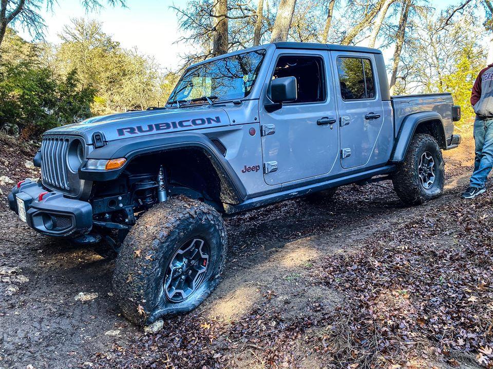

You didn't need it there tho. Its added unnecessary danger. For example...I had a blowout on the trail a few weeks back. Nothing a scissor jack couldn't handle faster and safer. For reference I was up an obstacle when this happened. I just backed down off the rocks and changed the tire.
Anyway...the hi-lift might get a few cases where they can legit be used...but most of the time they're just used because they exist in the vehicle. I've seen them used for tire changes countless times when it wasn't needed, even as a winch when a snatch block would be better.

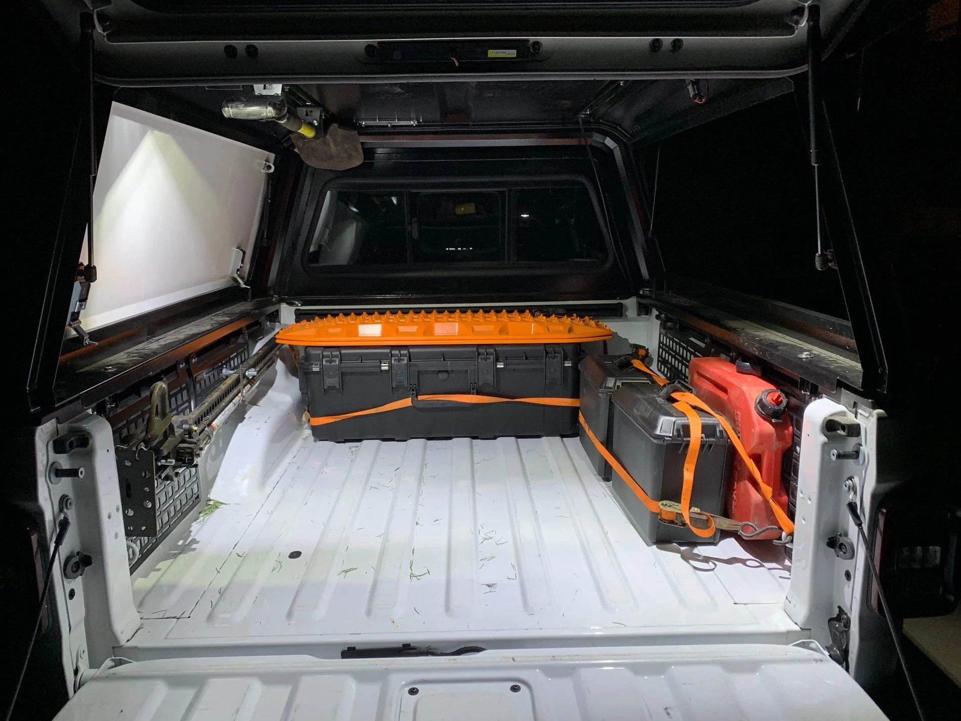

Yes you are correct. Sorry for my own Hi Lift Political rants... Anyway, I mounted mine on the BRI racks inside my covered bed so that everyone at the Mall can look at how cool it looks inside where nobody can see it.

Nice setup! What make/model is that storage box under the maxtrax?

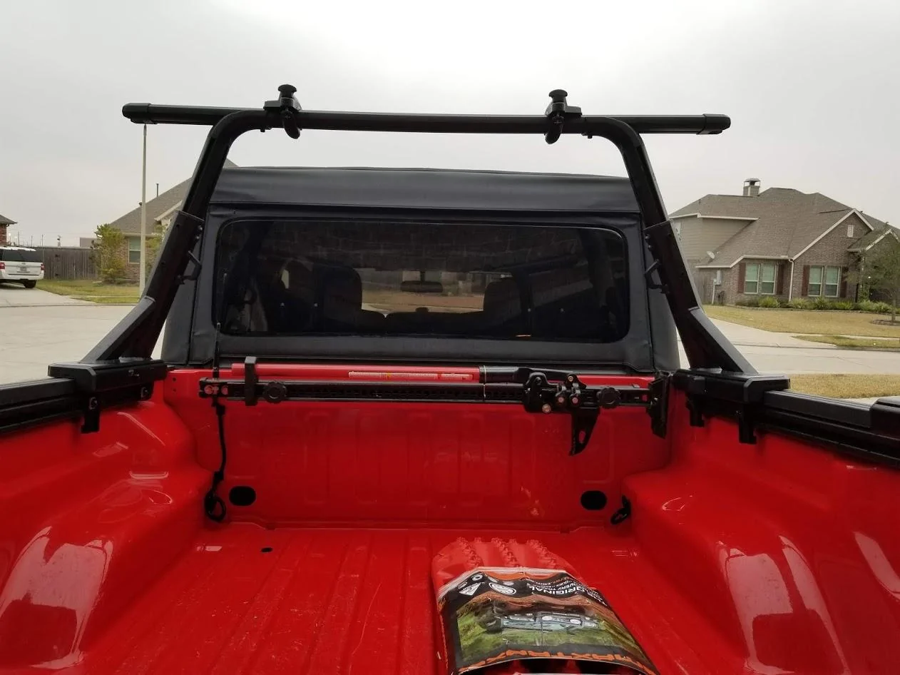

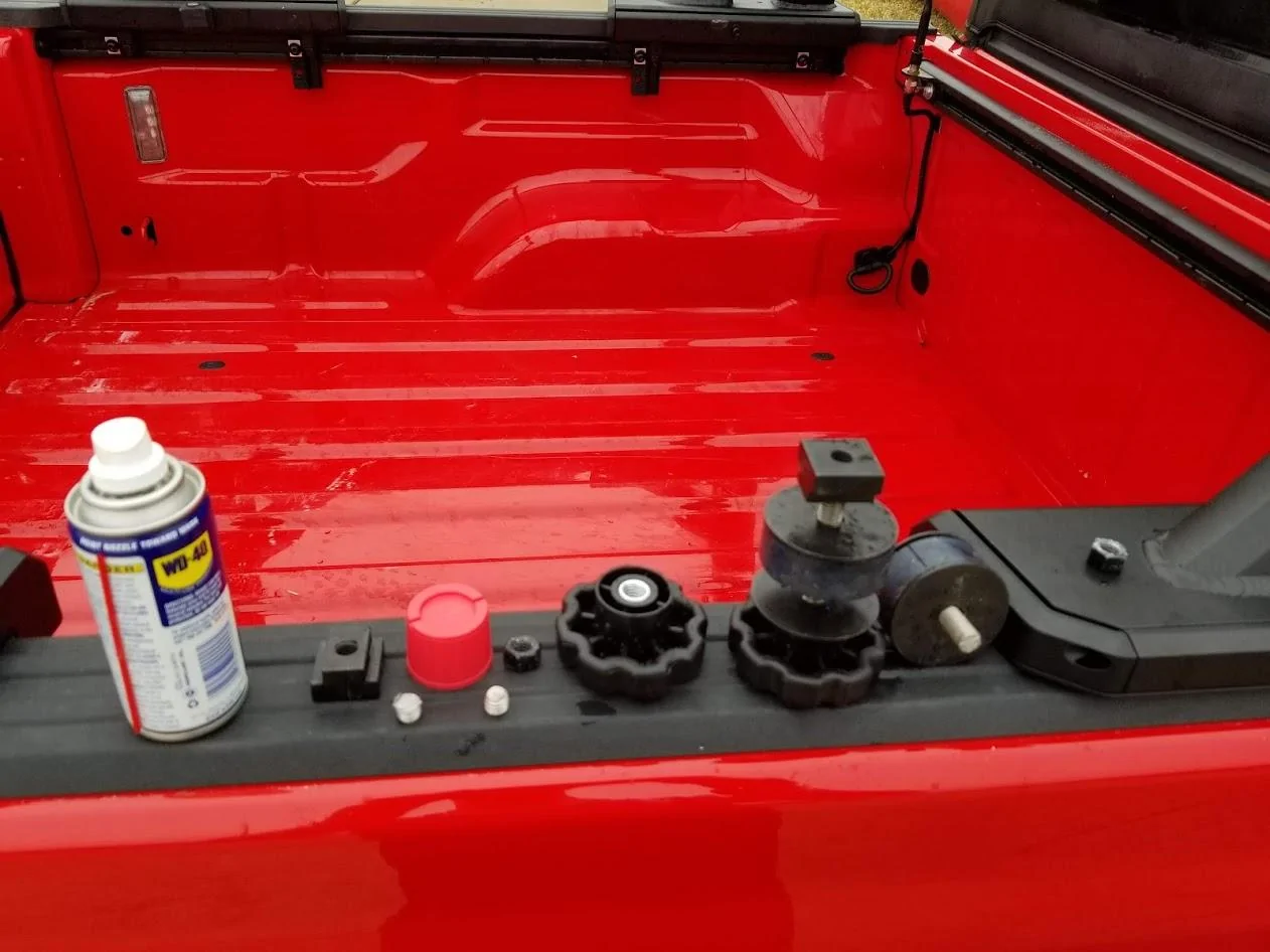

Well, I ended up hoeing my own road on this one. I wanted a no-drill solution that was rock solid, subtle, simple, and hopefully inexpensive enough to be a stop gap until I had an integrated solution with my future grand master plan incorporating a cargo tray, roof rack, truck rack, etc. I didn't want it to affect my gas mileage, so I didn't want to put it on the hood or side of the truck like a lot of JL mounts that I could have bought.

Through trial and error, lots of caliper measurements, and pulled together parts from McMaster-Carr, I got there. I had to shorten some threads with a hacksaw, and I had to stack a few more washers than I would have liked, and I made the wrong choice on the first set of T-Slot Nuts that I got, but in the end, it worked out and I'm pleased!
I haven't put this to the test off road, but it looks and fits great. Also, the mounts are rated to a combined 180 pounds in sheer, which is 6.5 time more than the weight of the jack. If anyone else wants to follow, here is what to do:
Buy this stuff:
The whole thing cost $50.
I went with corrosion resistant hardware everywhere I could, but the knob has a Zinc-Plated Steel insert. I expect that to deteriorate first.
The T-Slot nut is the perfect dimensions to slide into the gladiator cargo rails. The nut wont slide past the heads of the fasteners holding the cargo rails to the jeep if the threaded stud is sticking through the back, so don't tighten it all the way until it is situated where you want it to stay. I may end up using these nuts for other mounts in the future. It's a perfect fit in both the base width, the height, and the slot width. All three should be precise for best results.

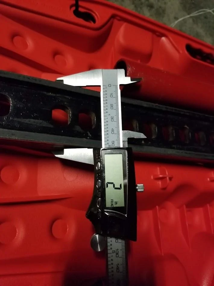

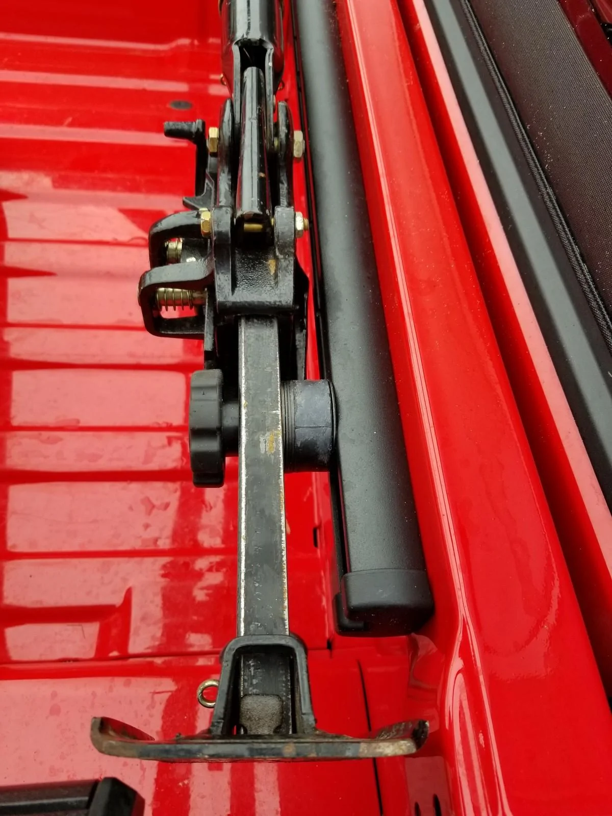

The vibration dampening mounts are two inch diameter, which is the width of the Hi-Lift jack's main bar. The washers are this same width. The Hi-Lift runner is thicker than the vibration dampening mounts with washers, so I had to stack four washers thick on the jack side. Not ideal, but it's the most reasonable solution I could identify. Also, the studs are too long on the vibration dampening mounts, so I followed the instructions in this video () and shortened the mount with a hacksaw and some nuts I got at Lowes, but you might pick up some from McMaster-Carr. You might skip these, although they could make the difference between messing up the threads on the vibration dampening mounts.
Jeep Gladiator Hi Lift Mounts mt5NFw9lukk4vdOxier7s-tdDJsmdrUP6lSnga9XAqnpoysV9SqgeMowA7oxHW4UnTWveFI1_iUE7ym2BO0=w710-h946

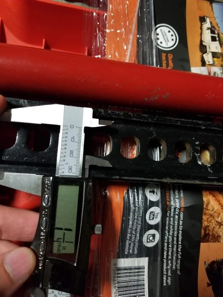

The knobs were the best I could find, but I would have liked to have more options. Specifically, I'd like one that is stainless steel. Oh well. The knob has a hub of 1&1/4" which is the precise width of the flat section of the Hi-Lift bar, so it seats in very well. and locates the Hi-Lift jack holes in the center of the fastener stack.

The diameter of the oversized washers and the vibration dampening mounts are the thickness of the Hi-Lift jack bar, although their diameter is greater than the height of the jeep's cargo rails. I ended up stacking four thick to provide clearance for the width of the Hi-Lift runner. The Hi-Lift runner is thicker than the vibration dampening mount with a washer on each side. If you are feeling spendy, you can buy thick oversized washers, but they cost more than five times as much. You would be buying less because they are thicker... you do the math. Maybe I could have gotten away with three washers instead of two between the mount and the jack, but I wanted a bit more clearance to make sure nothing makes contact when I hit big bumps. Maybe I could have had two thick washers... but that would have been cutting it close. The vibration dampening mounts are designed to flex, after all.

So once you have everything, do this:
  1. Cut the studs to be a bit longer than the height of the nut. You could probably cut them shorter than the nut to make everything slide easier, but that's too close for comfort for me. (I didn't have a vice, so I used the cargo rails themselves to hold things in place while I cut. This galled the back of the rails.
  2. Loosely build up two stacks with
    1. the t-Slot Nut,
    2. One washer
    3. the modified vibration isolation mount (with the short side going into the nut)
    4. four more washers
    5. the knob
  3. insert the stacks into the cargo rail and position them as desired. Keep the isolation mount from being screwed to far into the nut to enable movement across the cargo rail fasteners.
  4. When the stacks are positioned generally where you need them, screw in the vibration dampening mounts
  5. take the knobs off
  6. mount the Hi-Lift jack on the studs of the vibration dampening mounts.
  7. screw the knobs on
  8. tighten everything up!

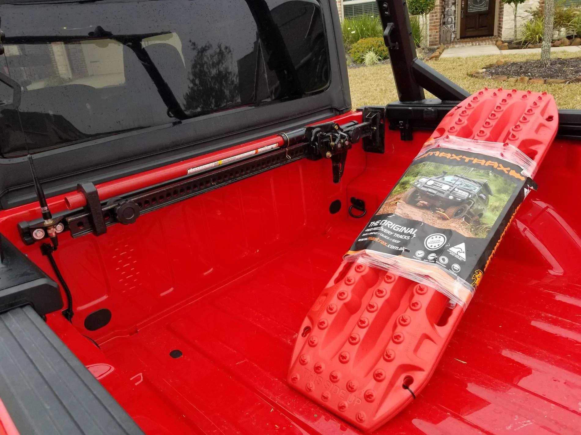

I had enough room to install the Hi-Lift jack with it's foot installed beside my ham radio antenna mounted on the same rail. It also fit within the Yakima Overhaul towers as well! What do you all think? Is this a reasonable solution? Does it cost too much.
