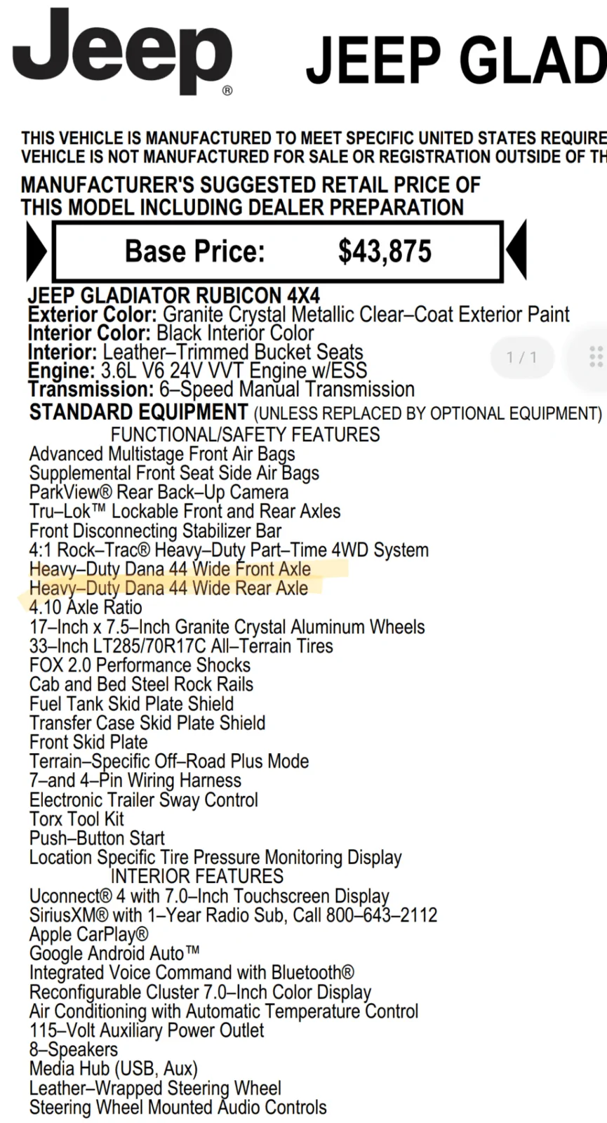

Are you sure the high altitude has wide track axles? The only models I've ever heard of that get them are the rubicon, Mojave, and sport/sport s with the max tow package.
Easy way to confirm is just by looking at your window sticker under the standard equipment list, here's an example of a Rubicon with the wide axles listed.

It does! My HA says it in the HA area:
Customer Preferred Package 24N $9,105
20–Inch x 8.0–Inch Gloss Black Aluminum Wheels
275/55R20 BSW All–Season Tires
Premium LED Lighting Group
8.4–Inch Radio and Premium Audio Group
Jeep® Active Safety Group
Body–Color Freedom Top® 3–Piece Hard Top
Quilted Nappa Leather–Trimmed Bucket Seats
Remote–Proximity Keyless–Entry
ParkSense® Rear Park–Assist System
Blind–Spot and Cross–Path Detection
LED Premium Reflector Headlamps
LED Front Fog Lamps
LED Tail Lamps
Heavy–Duty Dana® 44 Wide Front Axle
Heavy–Duty Dana® 44 Wide Rear Axle

Yep, my sticker says wide axles. I kinda figured they’d be aluminum.
