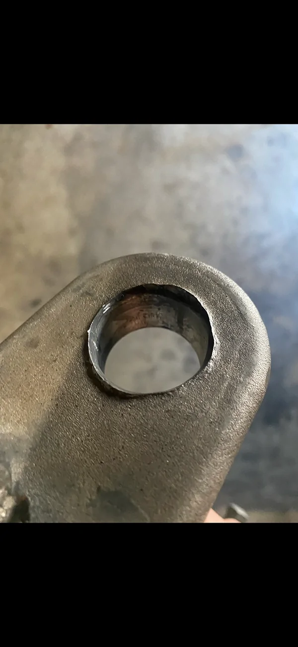

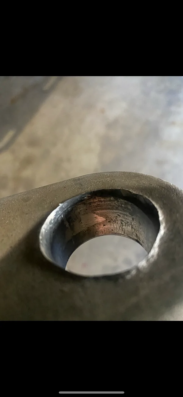

When I replaced my balljoints and knuckles on my JL the factory alloy knuckles had started to wallow along the top of the upper balljoint hole. Or so it appeared. I still have them in the garage I'll see if I can grab them for a picture.
Could have been some sort of damage from hammer the crap out of the knuckle when it was stuck to my balljoint.
Seen a few instances of a broken factory alloy knuckle but as stated it seems pretty uncommon.
pics added

I run a 35 inch tire and trail ride at a slow pace. I rotate my tires every 10k miles and every single time I rotate tires I check the torque on my aluminum knuckles and they have loosened at tie rod and drag link. If they get loose and start to wallow out they will become junk in no time.
