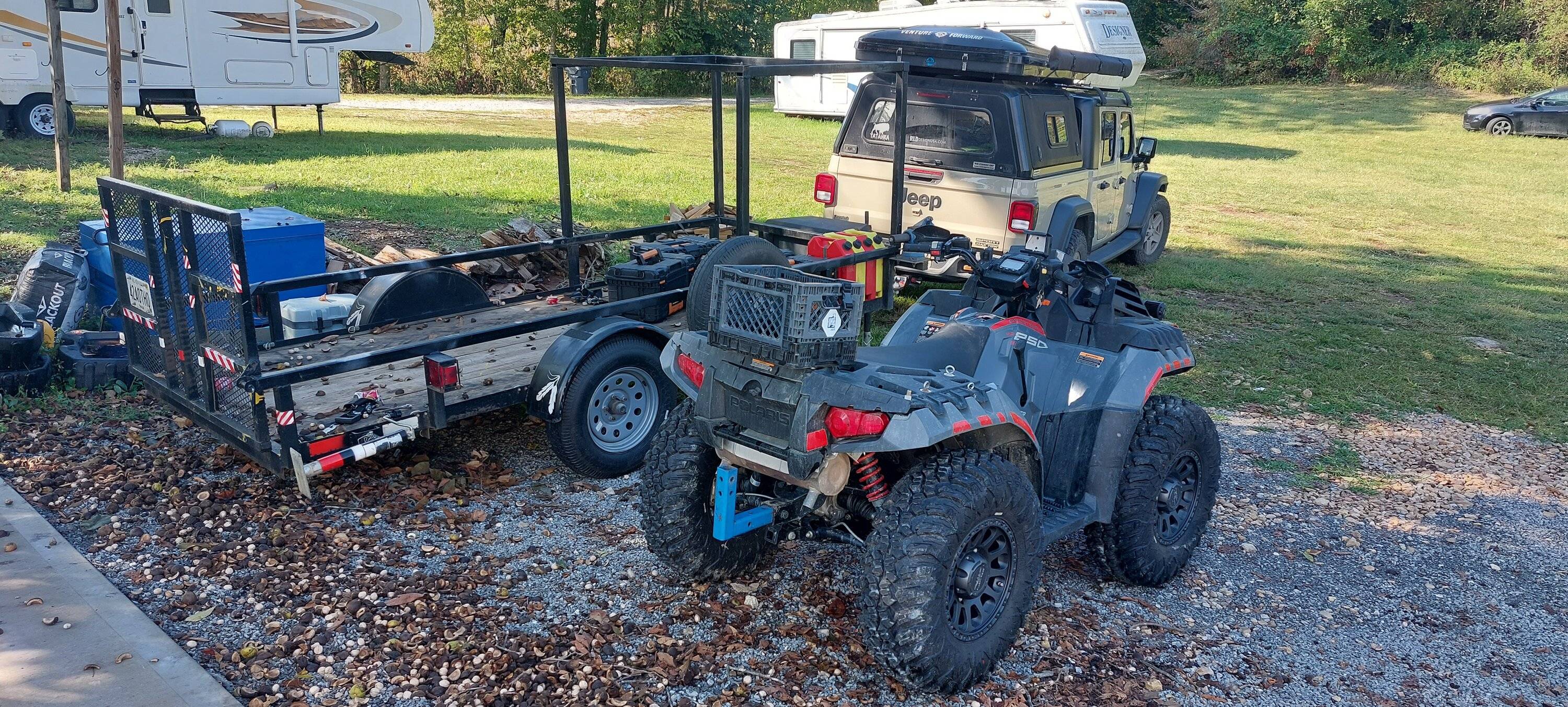

Jeep Gladiator "high mileage" 2020 JT 20230927_163336
Jeep Gladiator "high mileage" 2020 JT 20230927_163541
No real problems yet 3rd set of tires, the trailer in picture has been behind my JT most time of last 3-4 oil changes. It's needing new tires if that's any indication of anything, I swapped out spare for now. Dragging over a ton behind it well over 25000 miles with probably 900 lbs of gear in JT. Even when not towing. FYI just the trailer empty sucks 6 mpg off. The 4wheeler is around 850 lbs.
Regular maintenance, oil changes before it hits 0%, I check brake pads for wear at tire rotation. Not to start a war on brand of oils.... I use 0W20 synthetic of the yellow bottle or the silver/gray. No snake oils or additives. I've added maybe a pint of antifreeze in 3 years. Had the steering gearbox replaced under warranty, and few computer flashing.
