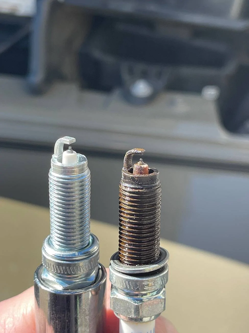

#3 cylinder. Got the plug out… Not a good sign.
Jeep Gladiator "high mileage" 2020 JT IMG_1068

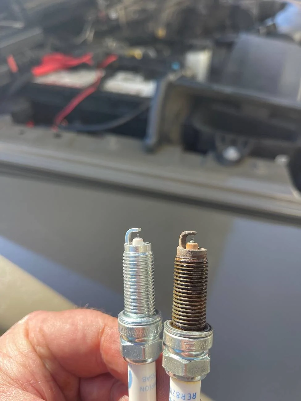

#1 is out. And #5.
This is at 101,500 miles for reference.
Jeep Gladiator "high mileage" 2020 JT IMG_1070

For 100K miles, those plugs don't look terrible. Definitely time to replace though.

Yeah I’ve seen worse too but they were nasty! I also replaced the coil packs.
#3 cylinder misfire is no more, CEL code cleared and she’s running just like a song.
