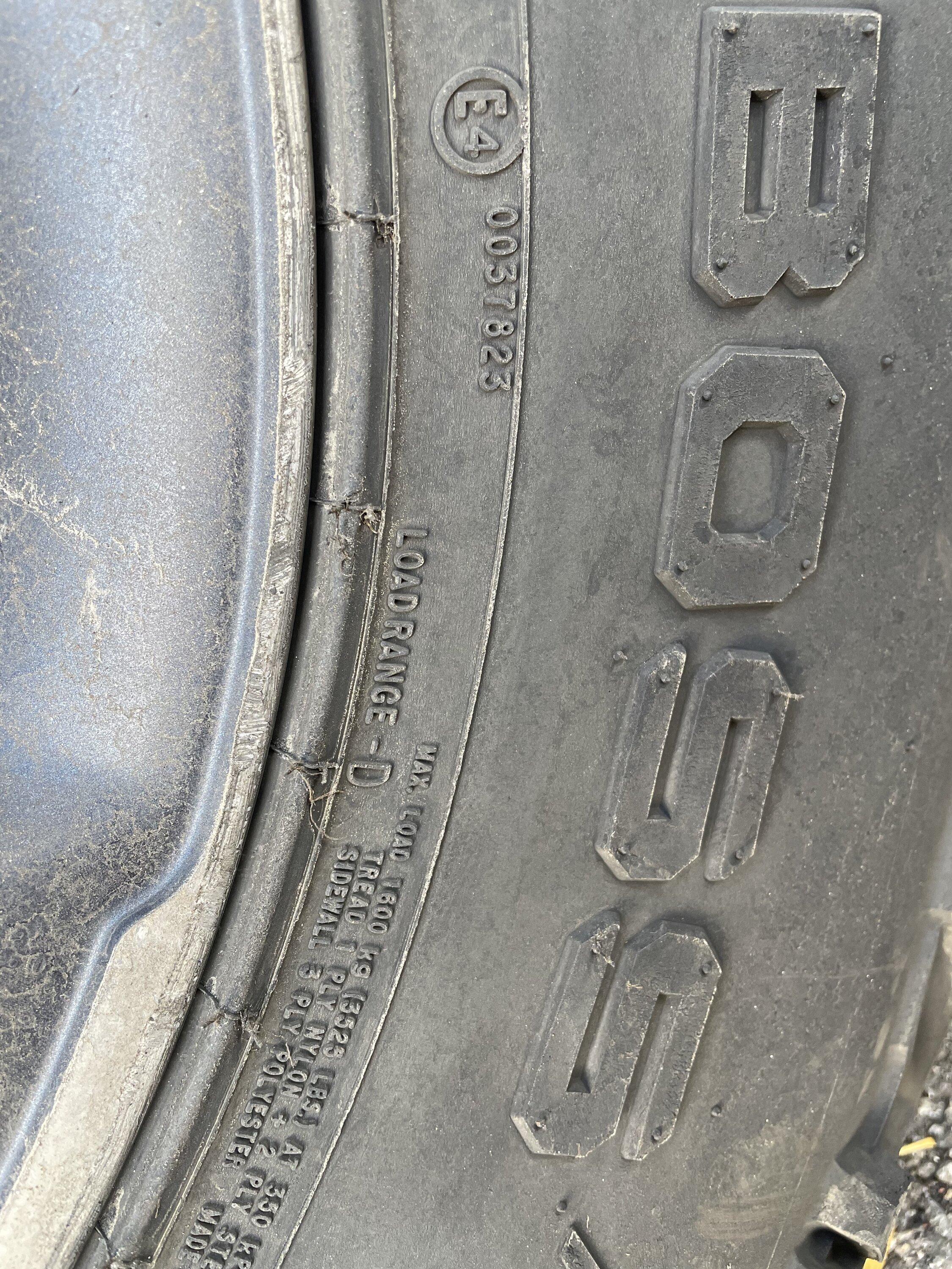

That's what I thought too originally, but the factory tires are a D class and the Baja Boss M/Ts are a C class. Totally different load ratings so totally different psi. The recent cold snap had me drop from 28 to 24 and I hadn't noticed. Now I'm hovering around 29psi cold which is a pretty good spot.

Mines the opposite. The original LT285/70R17C’s were C rated and called for 37psi. The 37x12.5xR17LT’s are D rated. Mickey Thompson tech support is who told me to run 27psi cold, which makes sense to me.
