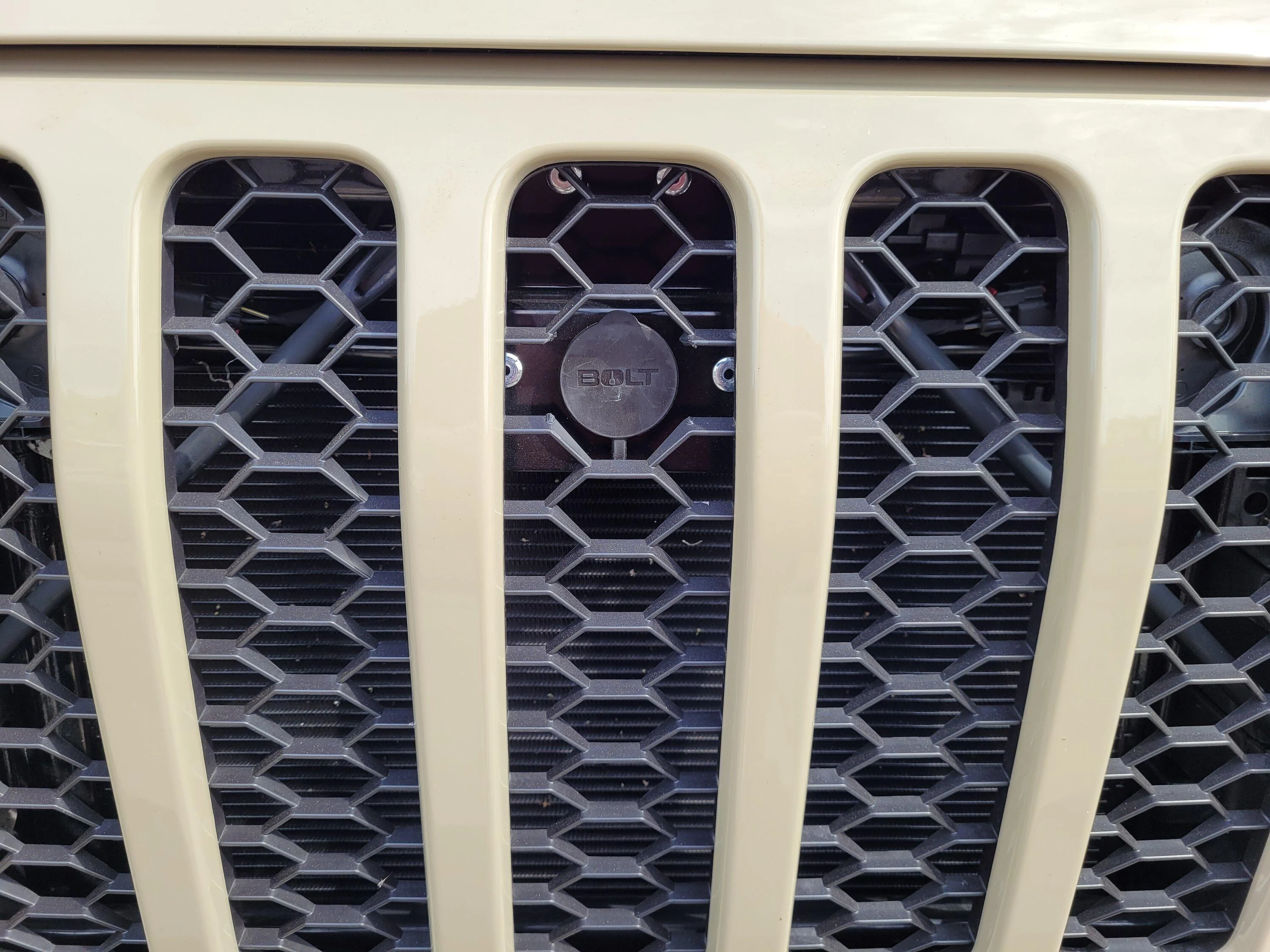

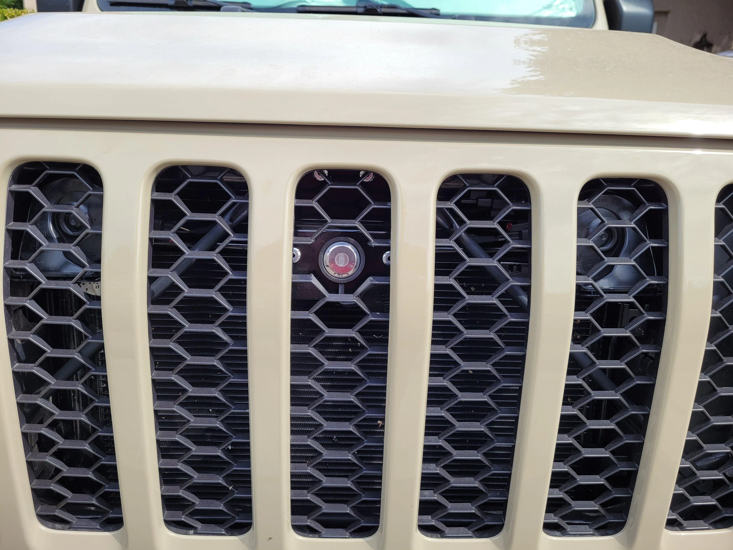

Add another recommendation for the Bolt. Still only include the JL insert with the kit, but if you use sharp side cutters, looks great in my opinion.
Jeep Gladiator Hood lock for 2020 Rubicon JT 20220805_161406
Jeep Gladiator Hood lock for 2020 Rubicon JT 20220805_161425
Keep in mind that the Bolt system isn't compatible with the front Trail Camera.
