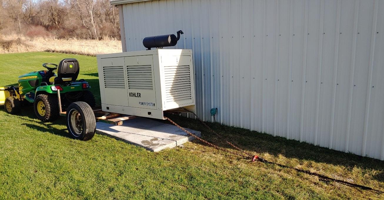

Pulled my neighbor's generator off a cart and onto the slab he'd made for it. Good chance to rewind it, too, check everything over. Truck is over in my back driveway, winch rope goes across both driveways to his yard north of his shop.
Did he just let it drop? Looks like a foot or so.
No, we got it close to balanced then set 4x4s under the rear frame rails and pulled my lawn tractor ahead with the cart while the winch held it from moving forward. We slowly set the back end down on the 4x4s and pulled the cart forward until it was almost off the cart, then set a small floor jack under that end to hold it while driving the lawn tractor forward to get the cart clear out. Then we pulled the jack out of the front end and used my winch to pull it back to center on the pad and used a jack to get the 4x4s out from under that end.
