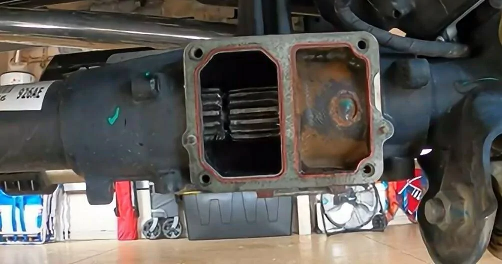

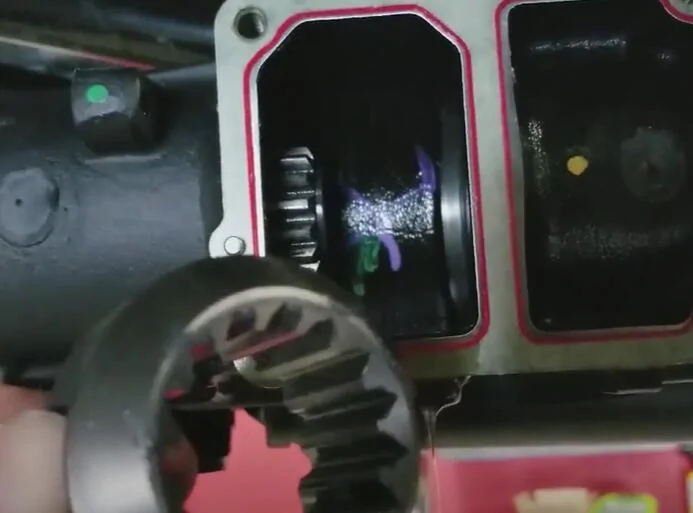

I've never found it to require 'a few revolutions' but that doesn't matter - if it's up where a top of the tooth on the sleeve is hitting the top of a tooth on the "gear", it's not going to engage. Normally it takes only an inch or so of tire rotation - you only need to get the sleeve to the point it's not hitting the other shaft "spline teeth" directly head-on.
You'd literally have to move at least some to get the tooth to go into a slot between teeth on the sleeve. Maybe just a few degrees of rotation (5 to 10?? depending on number of splines) is all that's needed. It's like trying to get into low or reverse on a manual transmission - sometimes the teeth hit each other wrong and something has to move - at least some amount. An inch or two does it if you are not actually moving on the road. It takes longer at road speed than when not moving or barely moving in my experiences plowing and trying to get 5,000 pounds of trailer and car through rocks and gravel, up a hill, or through a washout and wet grass.
I have been able to engage mine into 4H from a dead stop and pull myself out of a rut more than once. I'm more of the "let's see how far I can get in 2 - even plowing snow, I take it as a challenge just to see how capable the truck is.
Jeep Gladiator When to use/not use 4x4? Overheating diffs, transfer cases etc. Screenshot 2025-05-05 121401
Jeep Gladiator When to use/not use 4x4? Overheating diffs, transfer cases etc. Screenshot 2025-05-05 121241
