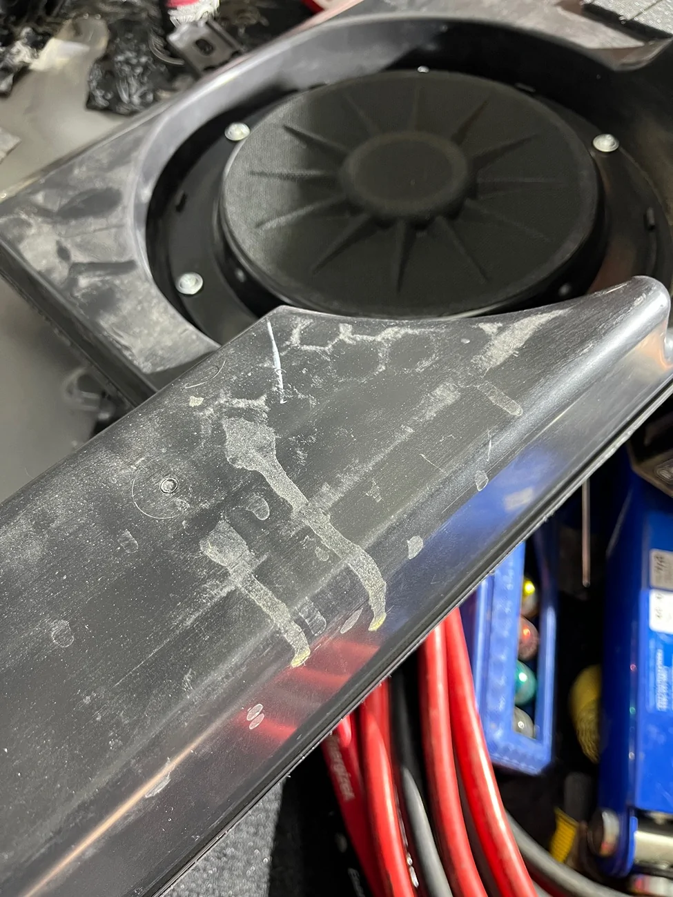

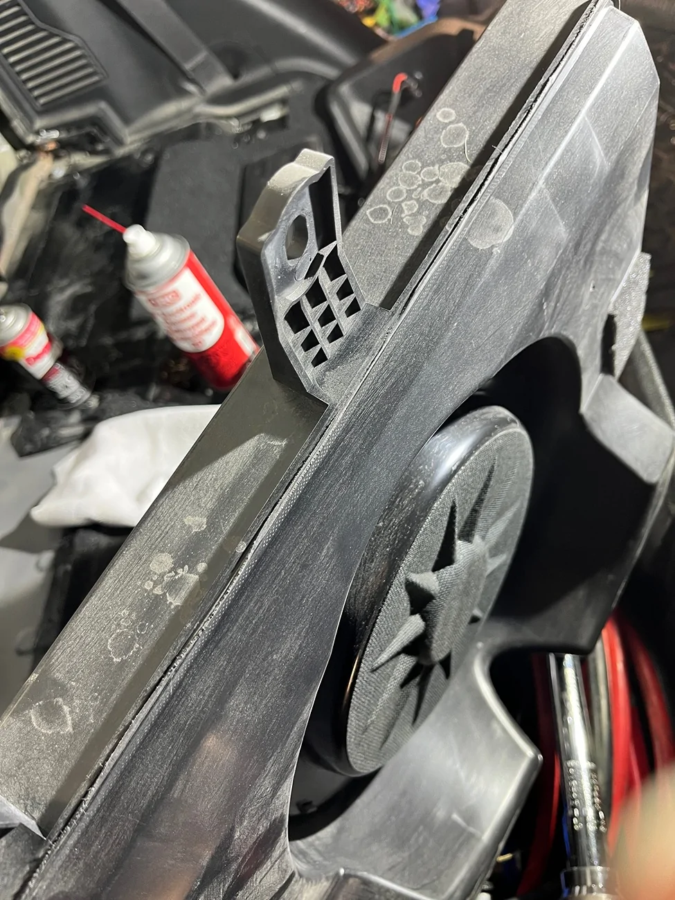

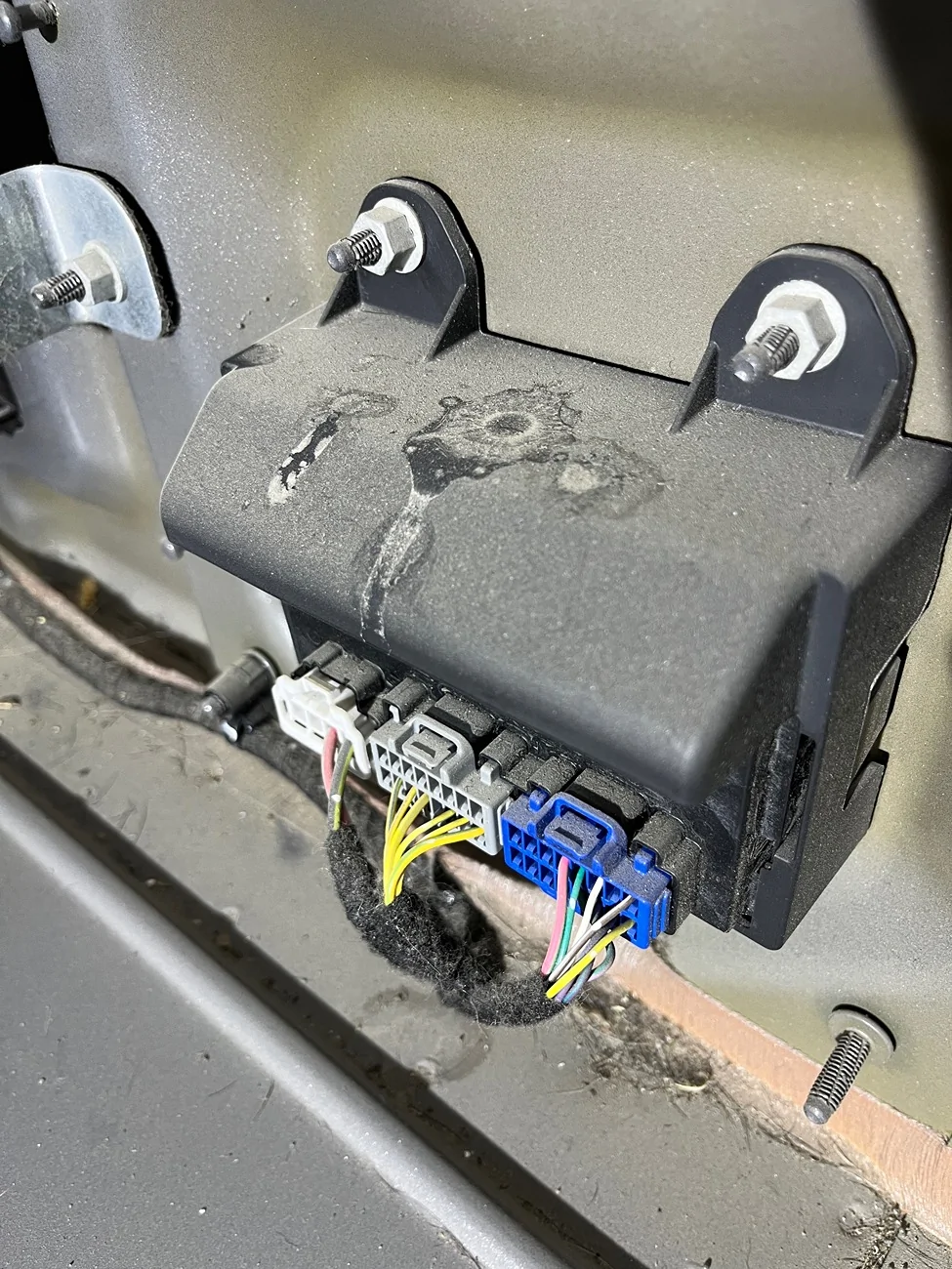

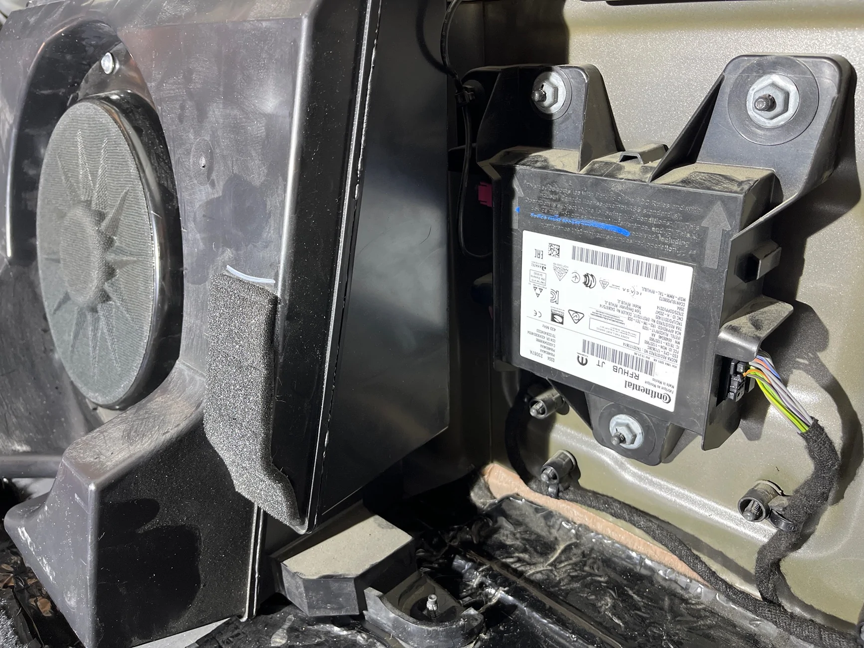

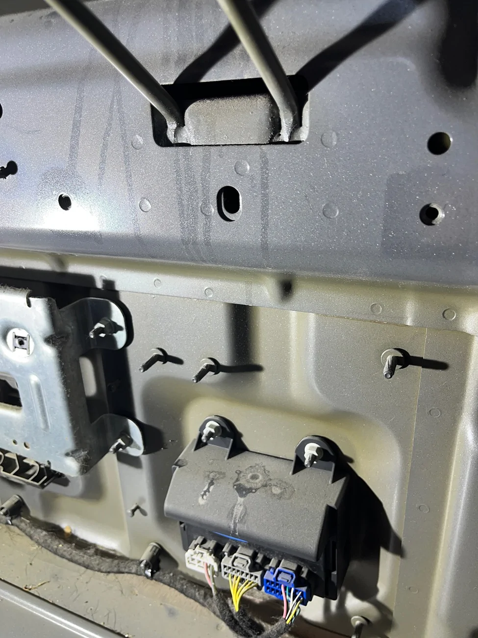

Maximus Gladius
Jan 30, 2021
75
2,919
3,731
Calgary, AB, Canada
2021 JTR, 2023 JTR
These are the modules back there as mentioned by @DylanM above. The evidence of water droplets in the dust was from the little leak at the window, and that’s from being all buttoned up. A good down pour or habitual rain all summer will have you regretting your decision.
