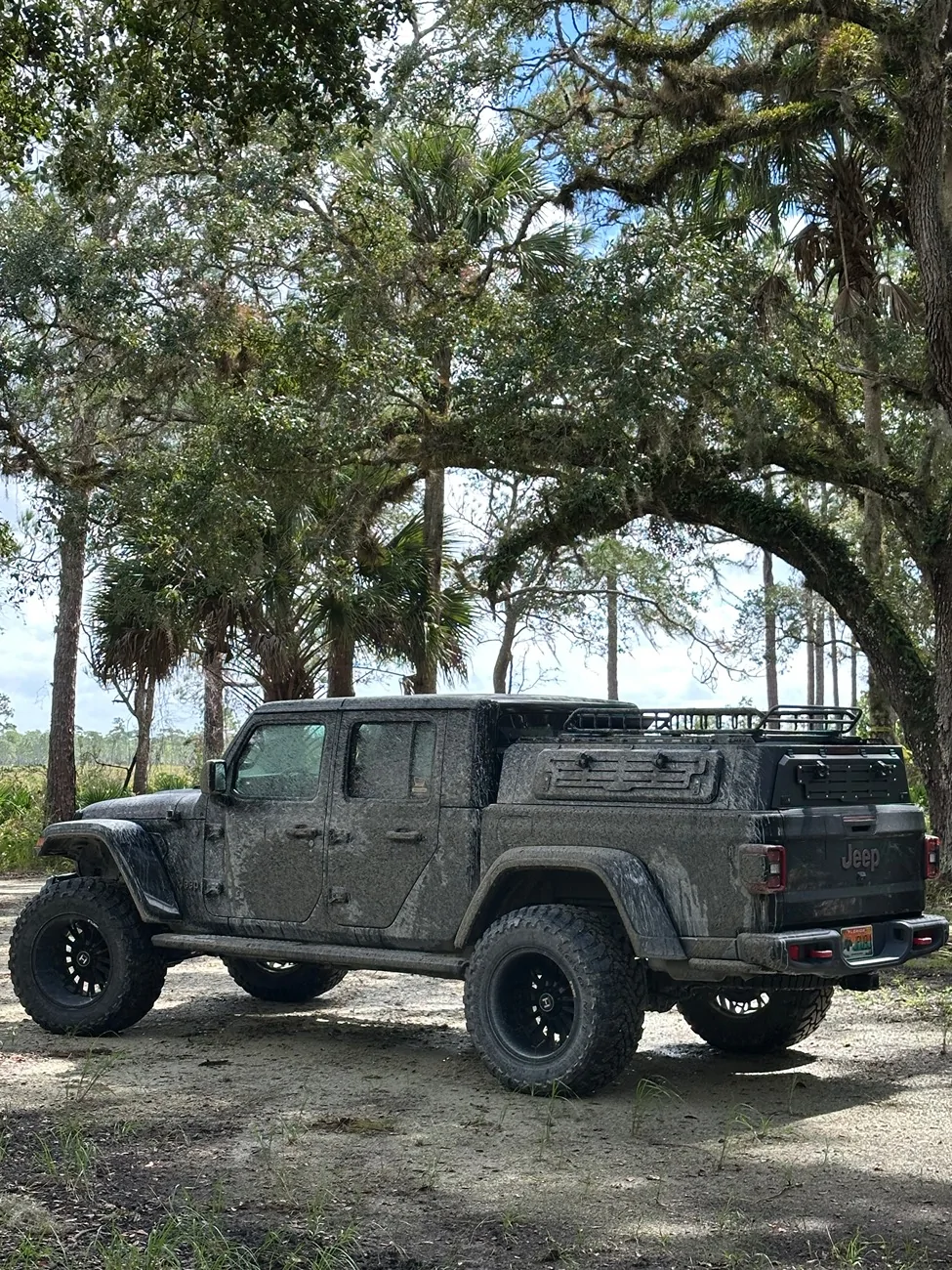

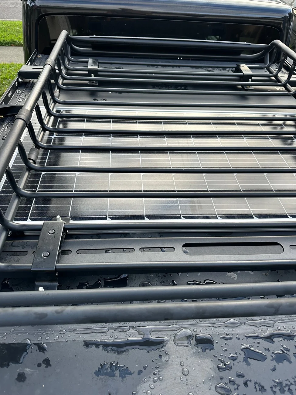

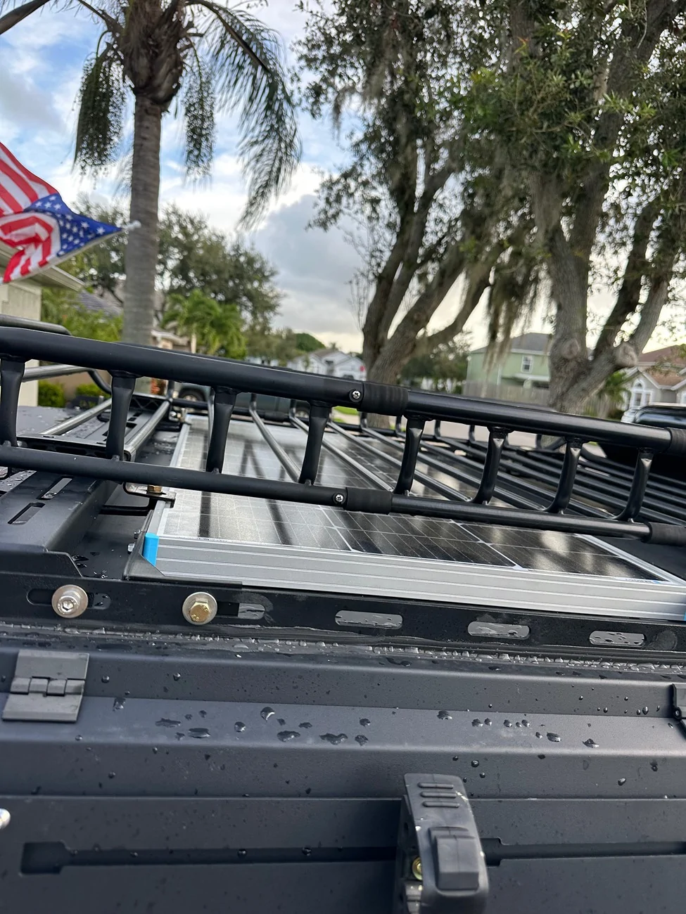

I don’t have a smart cap but this is how I did mine. I designed and printed some brackets to mount it with.
Wanted something to go under the basket since I do not utilize it a lot.
It charges a 100ah LifePo4 through a solar charge controller. Works great!
