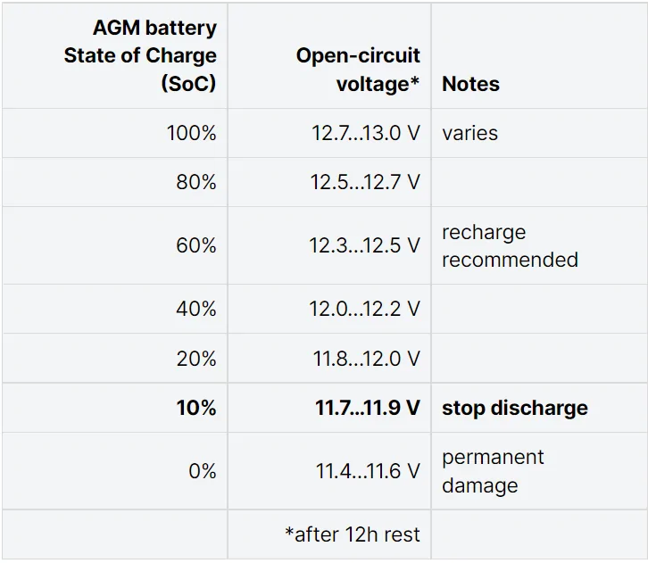

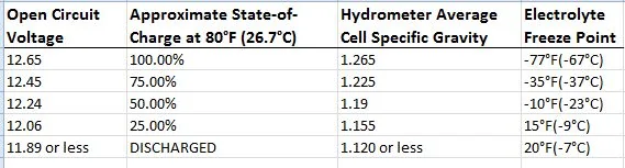

I admittedly didn’t read your entire post. But the batteries are not draining and being recharged. They’re being used and charged continuously, similar to an alternator
You said voltage was 11.9.
That's being drained.
You took more out than the panel could even ever dream of keeping up with.
Yes, that's called cycling, depending on the ambient temperature, that's down to 70% SoC
Sulfate forms in a battery that is constantly being cycled in the middle of its capacity range (somewhere between 80% charged and 80% discharged), and is never recharged to 100%.
(solar panels can't properly fully charge an automotive battery unless they use all phases, hold the voltage once absorption phase is reached for a couple of hour or so. Can those put out over 14 volts? and hold a high amperage?)
Over time, a portion of the plate's active materials turns into hard sulfate. If the battery is continually cycled in this manner, it will lose more and more of its capacity.
Bottom line - no way I'd ever take my truck's batteries under 12 volts on purpose even if I was constantly charging it at the same time. It's the net effect - low voltage,

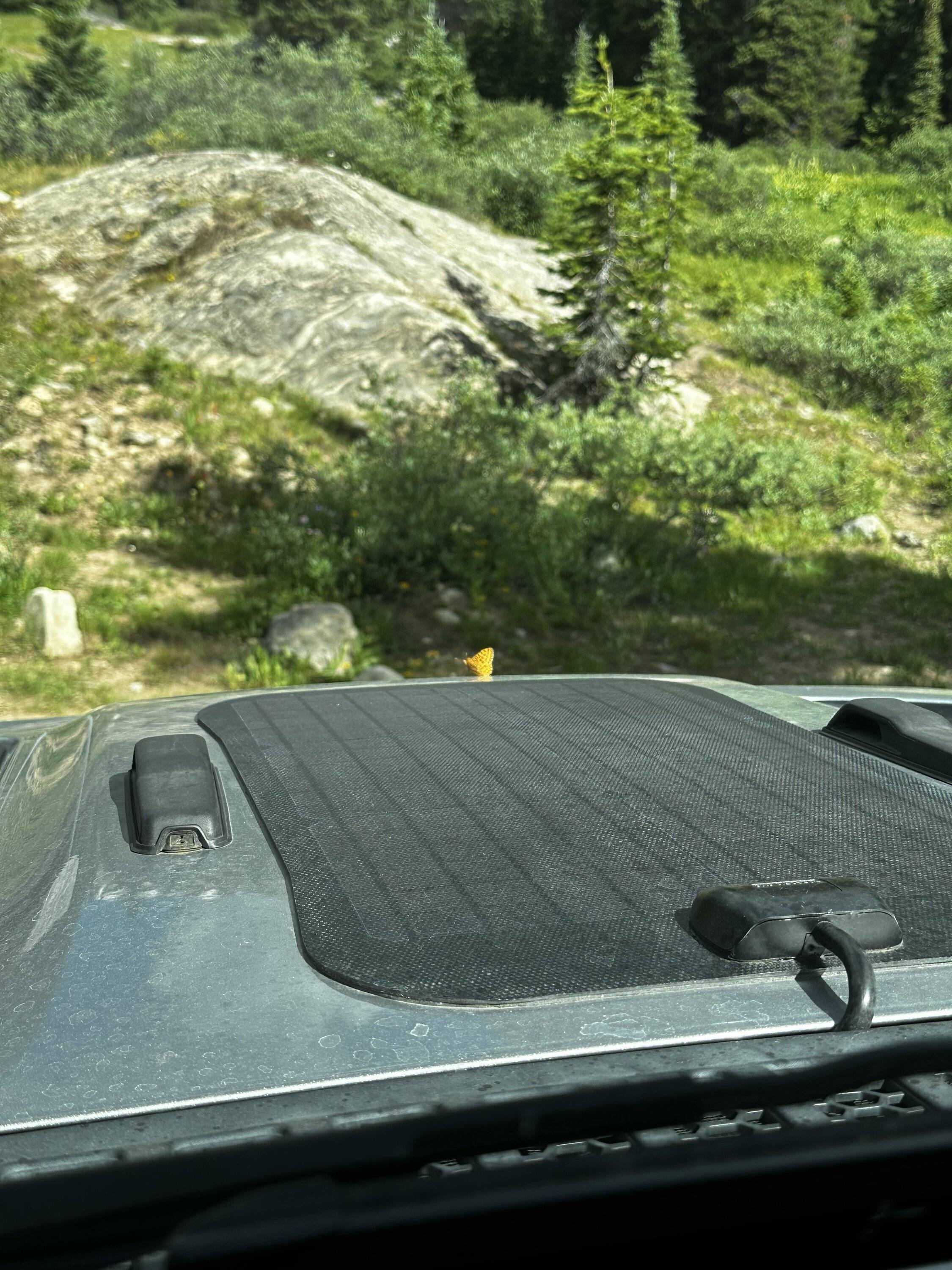

As everyone knows, butterflies are simply brilliant, and they are the metric for our successes as a race. As is obvious, this one loved my hood solar so much, it hung out near it, for at least 93 seconds while I was on Holy Cross. It winked at me. I can’t make that up.
