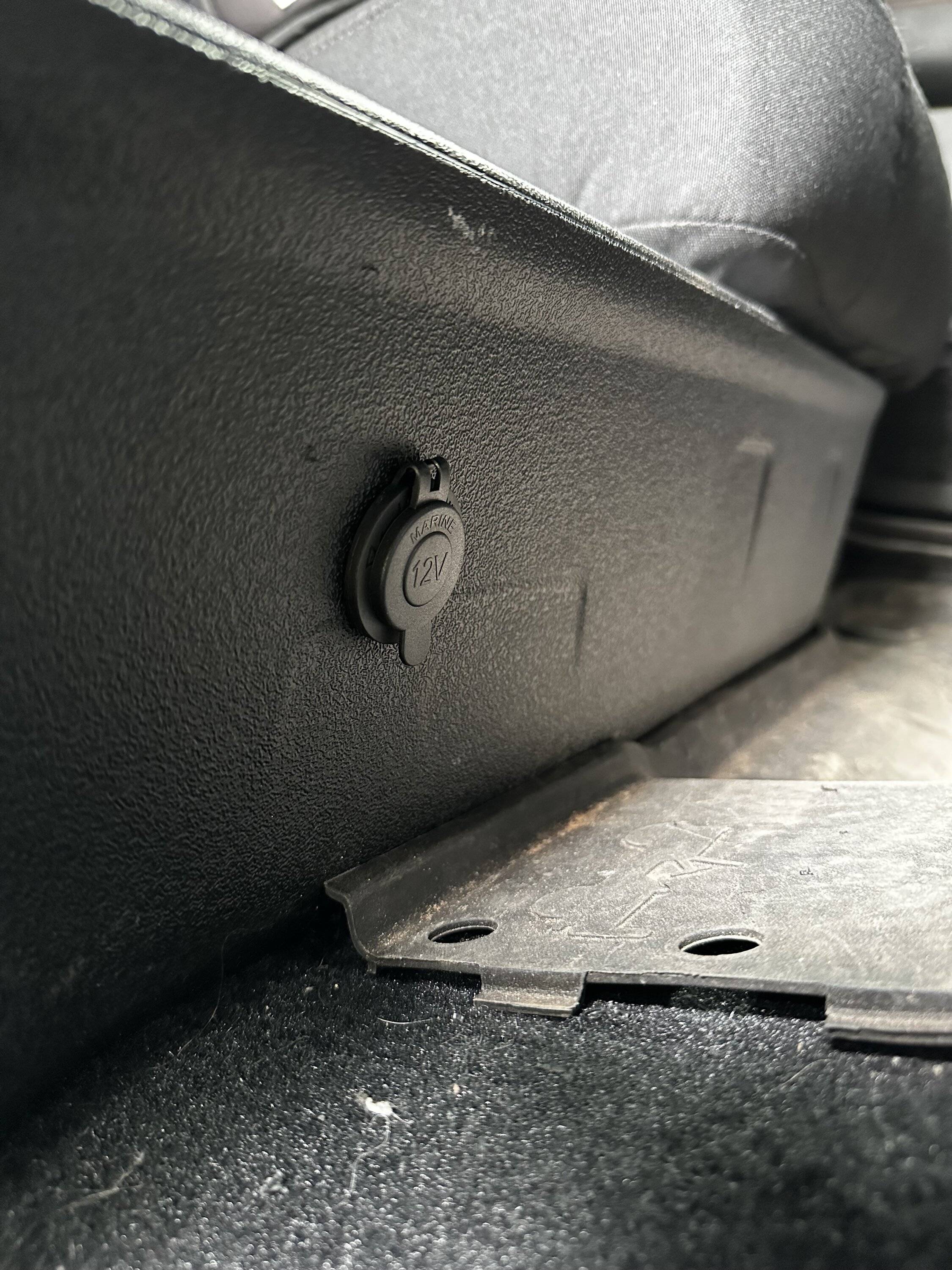

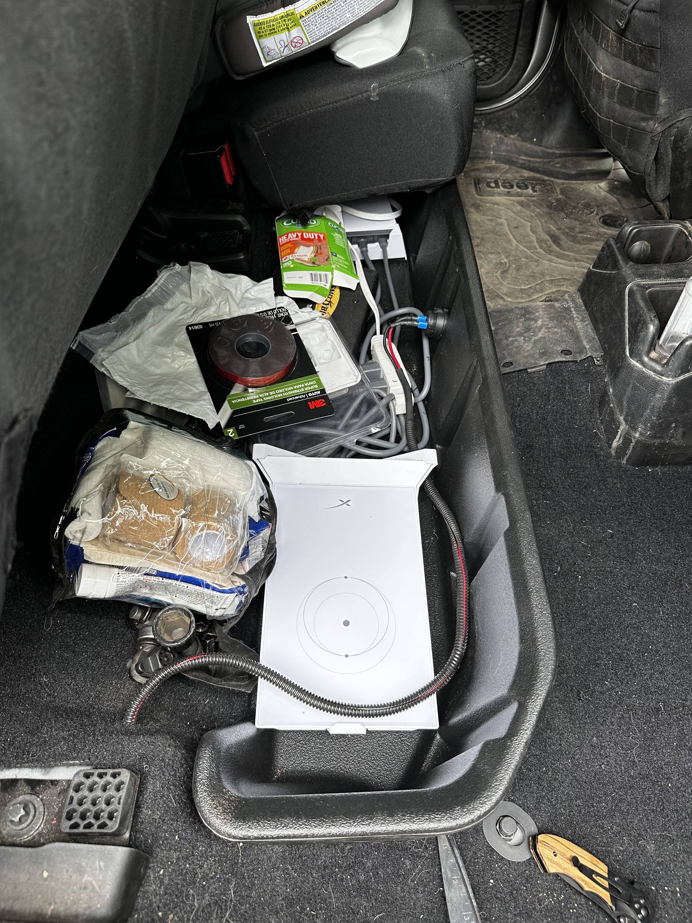

You can daisy chain them. They also sell roof top panels. 11.4v is nothing. But it would take a hell of a lot to get close to that. After 7 hours of use, I was only down to 11.9. The charge controller’s protected circuit works great. Here’s where I wired mine.
No way I'd accept a controller that let a vehicle's battery get down that low - I'd hope that can be adjusted or set. That's abusing the battery and risking a no-start situation on an older battery.
For an auxiliary battery that's not part of the vehicle electric system that's ok if it's a deep cycle battery...............but........
I wonder why they set that for 11.4 before shutoff. 11.9 is really bad, 11.4 is battery killer territory. Ouch. AGM batteries don't do well getting below 12 volts.
It's why I'm opting for a distinct battery - not relying on the vehicle's main batteries for aux power.

The fact is, the whole point of a system like this is to create an easy maintainer without the need for ac power and a charger. Draining your battery down isn’t the fault of the controller. It would never happen unless you deliberately try to push it. I did that once as a test to prove that I’d be able to start it, which I did without a problem. I’d expect my original batteries to last longer than most others, since it’s always being maintained, as long as the sun isn’t down, and it isn’t totally overcast.

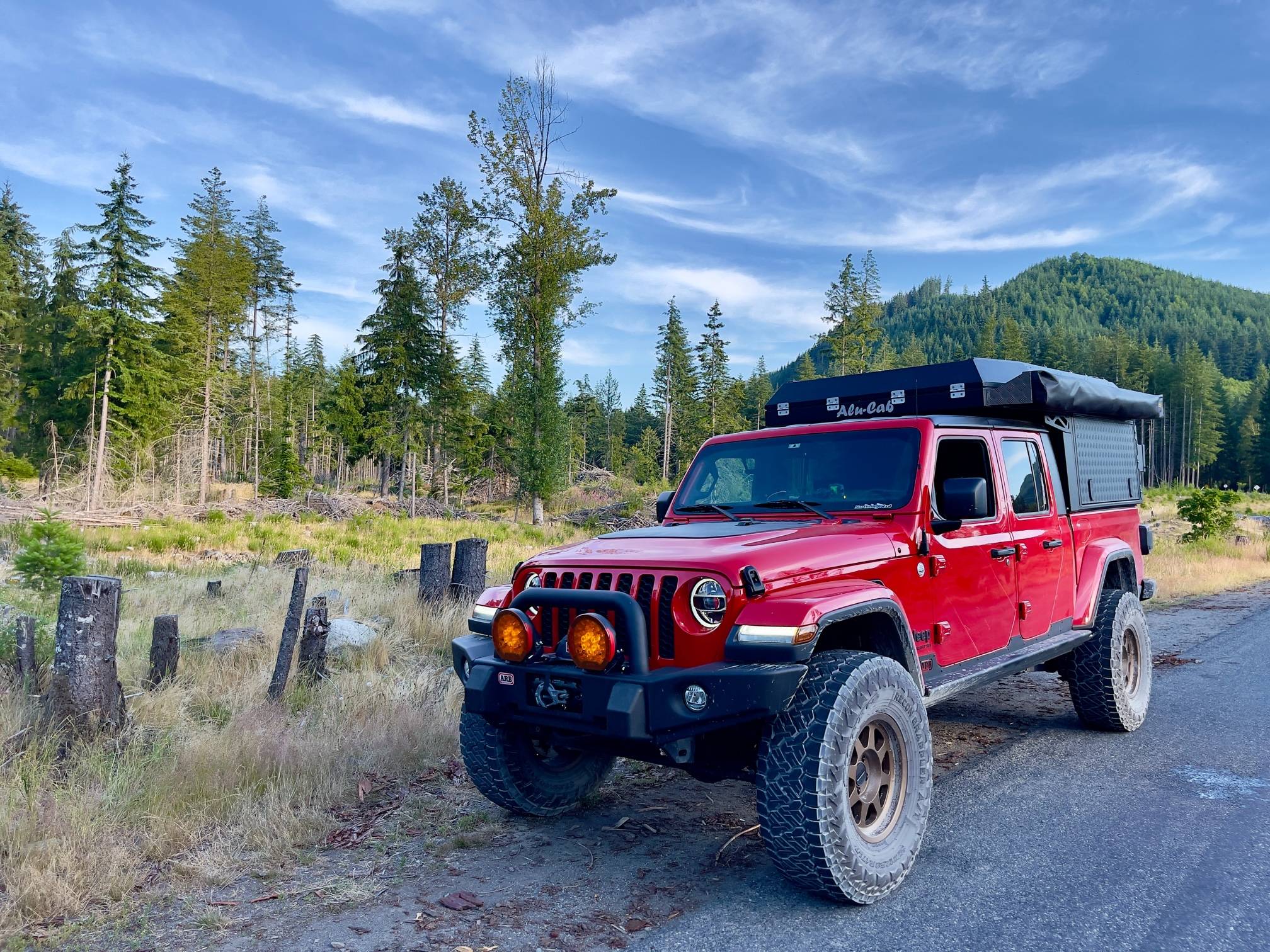

Another happy Cascadia 4x4 customer here (85W). I work from home, so the Jeep sits in the driveway sometimes up to a couple of weeks at a time. Every non-ignition accessory is powered by my camper's house battery, so the hood-mounted panel's sole job is to maintain the starting battery.
