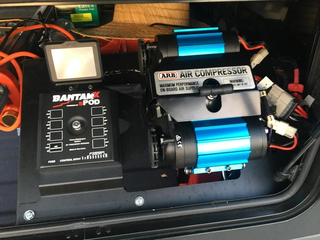

Ok, so I have the Roofnest Sparrow XL coming next week. It has a spot for a solar panel. They say it works well with the Renogy flexible solar panel. They recommend the 160w. My plan is to have that connected to my factory battery (I have the dual battery set up) and then my ARB fridge will be connected to the SPOD. Based on calculations, that should help slow the drain of the main battery. What am I missing in my thoughts about using this?
Jeep Gladiator Renogy Solar DB61800D-4595-4246-86D1-3DD2269123C9_1_105_c
