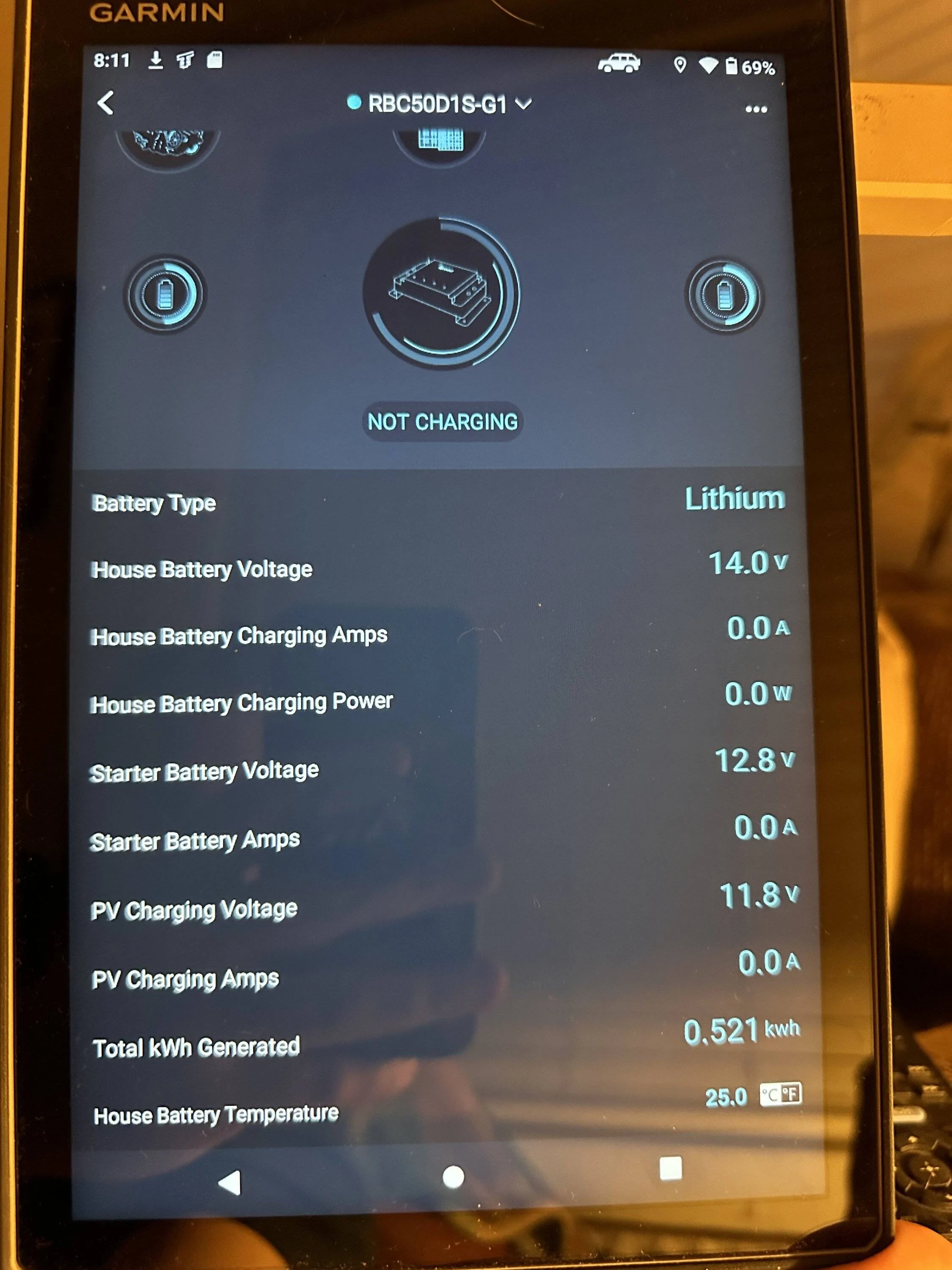

I got Renogy DC Home installed and running on my Garmin Tread XL. The app only supports portrait mode, but still cool.
Jeep Gladiator Renogy LiFePO House (Dual) Battery Install IMG_1897
Edit: I sidedloaded another android app that forces orientation. This fixes my stupid orientation issues with the Garmin and forces this app into landscape. Battery monitoring from my dash! ?
