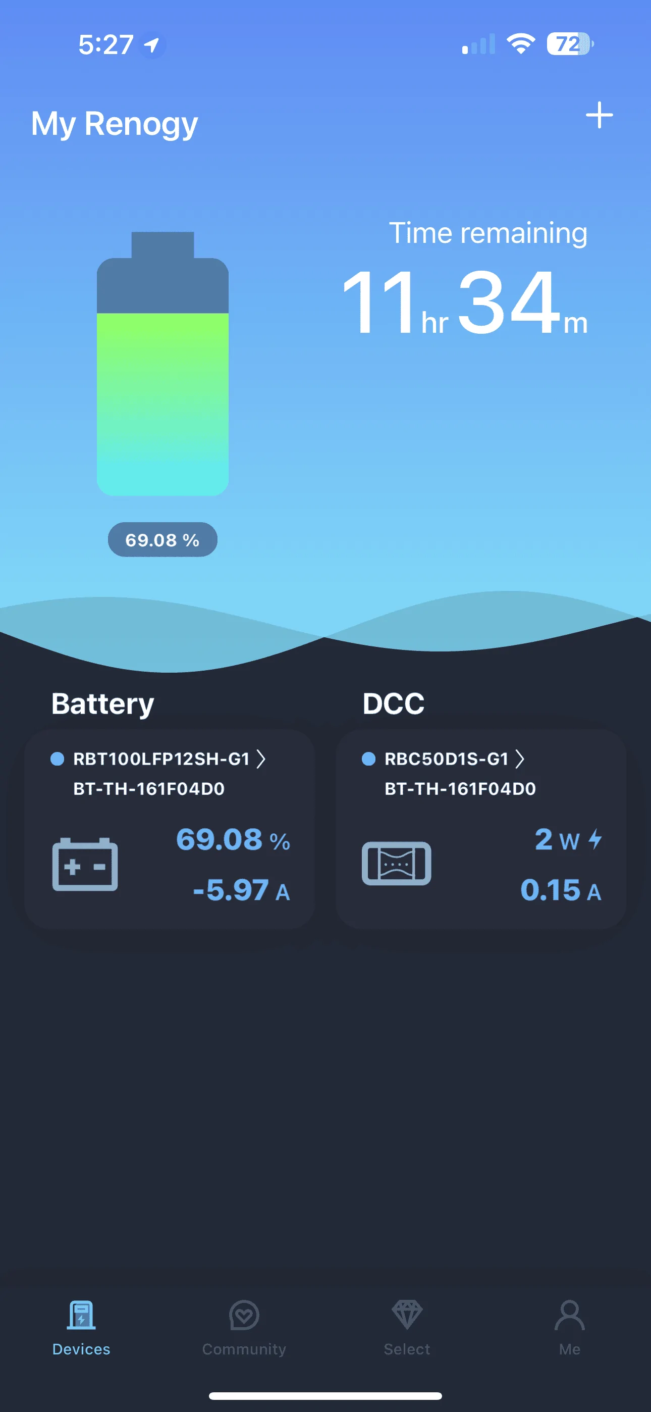

I’ve noticed one odd thing about the Renogy Home App or maybe the charger. Keep in mind I don’t yet have battery monitoring yet. The hub comes in tomorrow. So I don’t know the state of charge but I’m assuming it’s basically full. When you’re running Solar, I’ve noticed that I’m getting very low Amps and wattage. I thought maybe my new Renogy panel was defective. I’ve seen wattage as high as 30 but it’s usually super low. Of course I also see wattage when there’s no direct sun. The panel actually seems to works pretty well and poor light.
I attached my other panels to the system and got the same thing, low wattage. I know these panels put out good wattage.
I think I know what’s going on. I’m used to the Goal Zero which tells you what the panels are putting out. This seems to tell you what PV wattage is charging the house battery. I noticed the same thing when on alternator. The battery is basically full and I haven’t been running any loads so, there’s no real wattage being used.
I’m running the fridge now so we’ll see if the wattage jumps up. I’m going to test the Renogy panel on the GZ tomorrow as well. I’m still getting used to this beast

Yesterday, I saw my Solar charging jump up pretty high during the day when it was previously very low, but I’ve been running my fridge so the battery actually needed charge. This seems to confirm that the DCC50S will throttle the PV wattage depending on the batteries need. That’s not exactly the same as what you’re asking but it does answer my own question from a few posts ago. I do believe however that you can change the AMPs in the settings. I’ll double check the app today when I’m out there and it connects. I’m going to add the hub and get the battery monitoring going today.

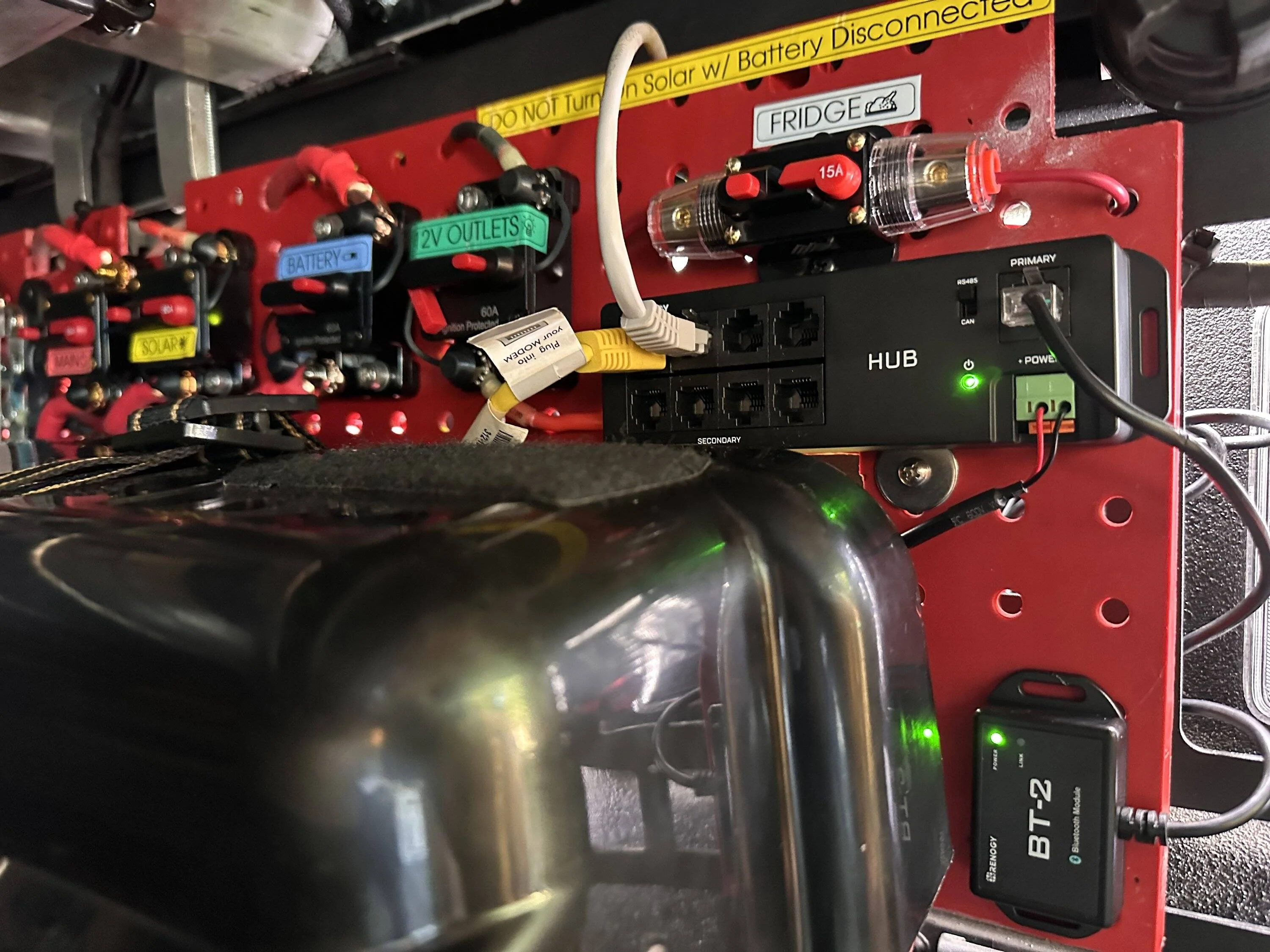

Got the hub installed. I hate the battery box and it’s lid. With the cat 6 plugged in it won’t sit down all the way. Had to cut out part of the back side. At least it’s hidden.
Jeep Gladiator Renogy LiFePO House (Dual) Battery Install IMG_1923
The DC home app on the phone and the Garmin now shows both devices.
Jeep Gladiator Renogy LiFePO House (Dual) Battery Install IMG_1924
What brand circuit breakers are those? I see a wide range of prices for the same looking breaker. That's not something to go cheap on, but don't want to pay inflated price if they're really all the same.
Why is the fridge breaker different? Does it do something different than the others?
They’re RedWolf. They’re pretty cheap. I didn’t actually find more expensive 12v circuit breakers on Amazon. I’m 99% sure all the ones on Amazon are the same with different labels stuck on them coming out of the same factory in China. I’m not sure about the brand of the fridge one. It’s only 15A which is why the different form factor. The rest are 60A.
