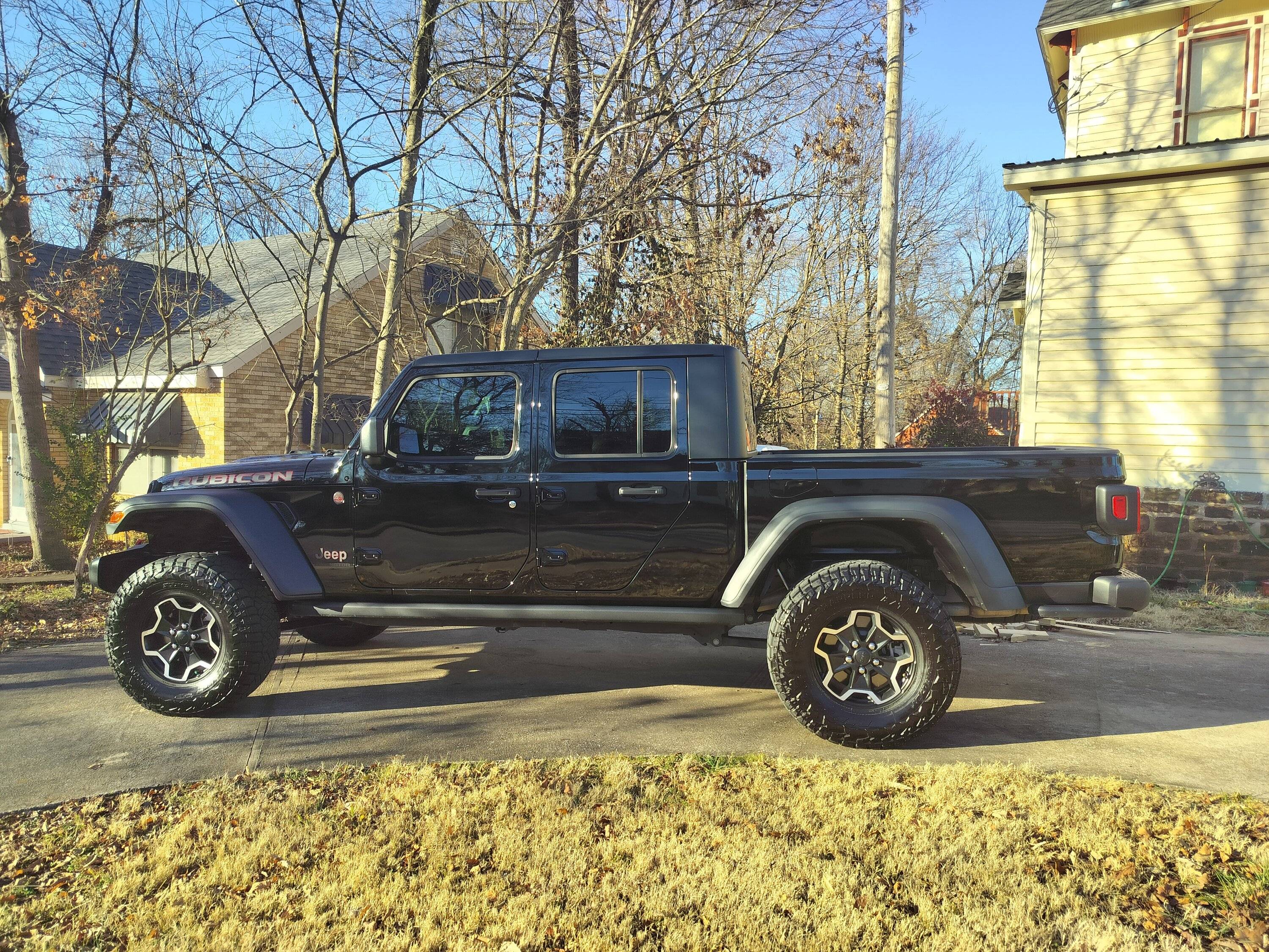

My first Jeep (bought yesterday) and it's a bit more complicated than I'm used to.
My previous 4-wheel drive vehicles, an International Scout and a GEO Tracker were kind of simple. You put it in 4-wheel drive then got out and manually locked the hubs. That was it.
This 2022 Gladiator Rubicon (12K miles), manual transmission, I just bought has Rock-Trak, Tru-Loc and a disconnecting sway bar, according to the window sticker that was in the glove box.
Question 1: Is Rock-Trak just a limited slip differential (always active)? I can't see any way to engage it and the owner's manual doesn't seem to mention it as far as I can tell.
Question 2: Do you engage the locking differential (what I'm guessing Tru-Loc is) when you get stuck or in anticipation of getting stuck?
Question 3: Disconnecting the sway bar is just for rock crawling, right?
Question 4: There's a whistle at highway speeds that I think is coming from the front passenger hard top panel. Any tips? I took the panel off and reseated it when I got home from the dealer, but haven't gone out again. Waiting for my insurance cards.
Thanks and I apologize for my noobishness.

First of all, NICE RIDE!! The machined wheels look great with the black.
