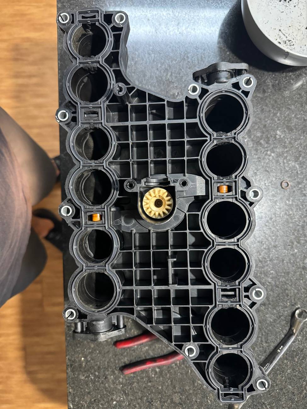

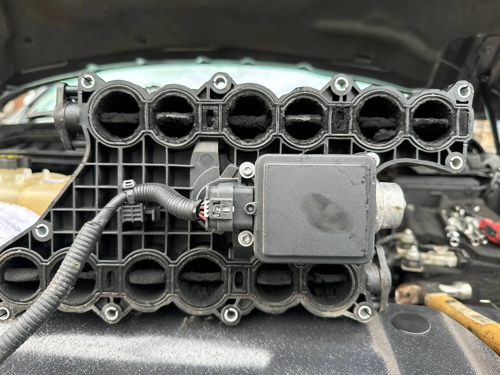

The stock tune will trigger a code if the swirl valves get bad enough. Aftermarket tunes can disable the swirl valves and therefore won't trigger a code. Based on forum feedback, most people with the 2014 - 2019 stock engine get anywhere from 110,000 - 300,000 miles out of the factory intake before it throws a code. How the truck is driven can significantly impact the longevity of the swirl valves. Obviously, the folks who live on the highway have much less issues with their emissions systems. The guy with 433,323 miles on his bone stock EcoDiesel still has the factory DPF.
For fun and to add to your post this is a 2016 gen 2 with 85k miles factory everything…. (Before cleaning and after cleaning, and swirl valve removal.)
Jeep Gladiator I have a question for anyone who actually knows. Diesel related. IMG_2309
Jeep Gladiator I have a question for anyone who actually knows. Diesel related. IMG_5593
